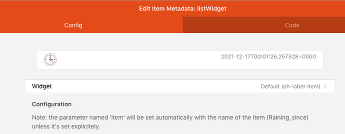

Rich, some progress/insight on the issue but not solved.

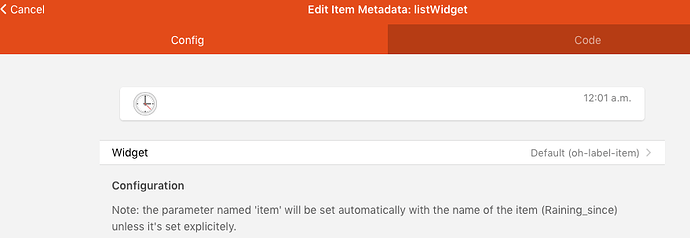

I added a Metadata ‘Default List item widget’ of flavour ‘Default-oh-label-item’, there was no progress until I UNLINKED the entire ‘Raining_since’ item from the channel and suddenly the properly formatted time appeared!
However, it stays frozen like that despite further changes because it’s unlinked.

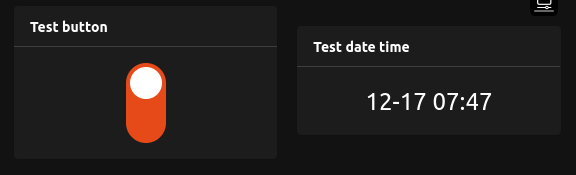

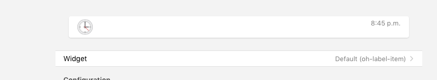

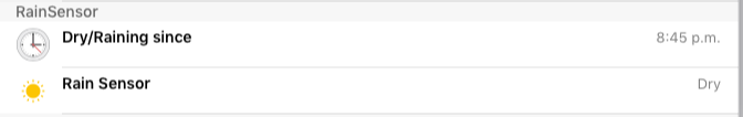

So the Pattern managed to do its function on the item display as soon as the item was unlinked. It’s useless like this of course, but it might shed some light on why the properly formatted time is ‘hidden’/‘overridden’ by the channel profile until the moment the link is gone. It somehow caches and converts the last instantaneous value.
Screen shots below.
Notice:

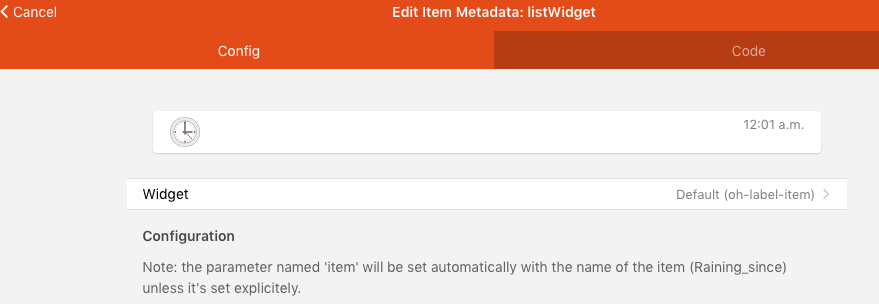

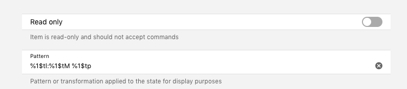

Pic 1, channel is now unlinked from item. Correct format evident on top of item header viewed from Model perspective.
Pics 2 &3, correctly formatted time appears on both the metadata widget AND the UI Card.

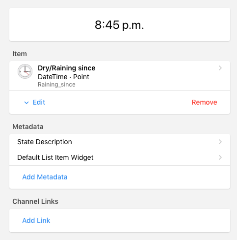

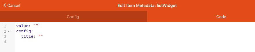

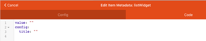

And that metadata widget has a code tab. Clicking on the code tab shows some YAML. I need that. Especially if it’s not working. Looking at one that is working for you and one that is not would also be informative if you still have one that works.
If you have the metadata still on the Item, then yes, the YAML will still be there. If you deleted that metadata then yes, there will not be any.
  1. Navigate to the Item
  2. Click on “Add Metadata”
  3. Click on “Default Stand Alone Widget” or “Default List Item Widget”
  4. You now see a form where you can customize the widget that get’s shown in that context (stand alone on Pages and at the top of the Item’s page, list item is how it appears in the cards on the location page, for example). There will also be a “Code” tab in the upper right. Clicking on that will show the YAML for widget. A nice and concise version of what you did through the form on the “Design” tab.
Screen shots are not all that useful but the YAML is very informative.

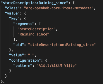

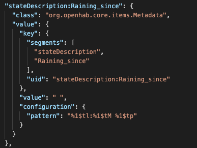

@denisdmenace, to get that, probably the easiest and most comprehensive thing to do would be to navigate to /var/lib/openhab/jsondb (assuming this is installed on Linux) and open the file with “Metadata” in the name. Post all the entries that are associated with the non-working Item. An entry will look something like:
  "stateDescription:FrontDoor_Lastchange": {
    "class": "org.openhab.core.items.Metadata",
    "value": {
      "key": {
        "segments": [
          "stateDescription",
          "FrontDoor_Lastchange"
        "uid": "stateDescription:FrontDoor_Lastchange"
      "value": " ",
      "configuration": {
        "pattern": "%1$tm-%1$td %1$tH:%1$tM"
I’ll want to see all the entries for that one Item. That will show us what you’ve applied as well as anything the binding may have applied.

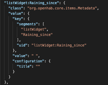

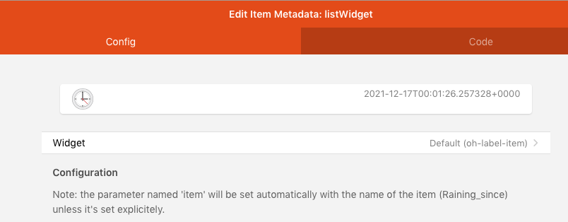

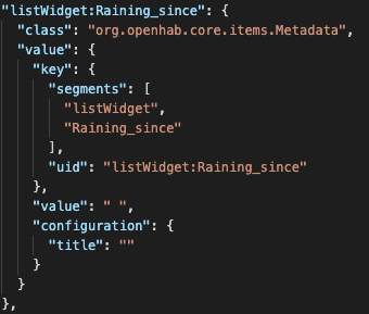

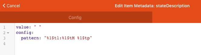

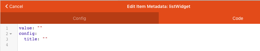

Ok I attach YAML code for the bits you want. You mentioned about working/not working. It has never ‘really’ worked except when the item is unlinked and thus that is only a frozen moment in time.
Also, I attach the jasondb stuff. In fact I’m on a Mac which is Unix, not Linux, and the file was nowhere like you mentioned..found them in the userdata/jasondb/ folder (directory in unix speak) and the one of interest was org.openhab.core.items.Metadata.json
The YAML code areas are almost empty. The widget one has effectively nothing.
JSON State description & List widget Code: LINKED mode
Do you need the actual code stuff as a copy paste inside code fences or are the screen shots ok for you?
That’s with it “working”, right? What does it look like after re-linking, using timestamp profile?
Noooo haha… :grinning_face_with_smiling_eyes:.. this is all with it NOT working, as you can see the raw unformatted DateTime stuff in the widget header. I’ll try do the jasondb for the unlinked mode so, good idea.
Could you use the REST API (“API Explorer”) to examine your Item, with and without link? That should give us a complete ‘live’ picture of what the system thinks it is about at that moment.
UNLINKED MODE:
