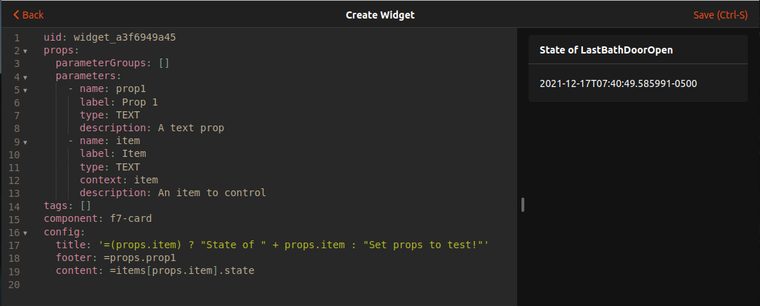

I stumbled across a funny thing last night

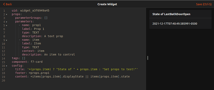

I tried it in a widget, but I just clicked the big blue button and created a new widget
The screen shot in Post 11 showed the newly created widget. (Sorry Rich I cut off the yaml but I didn’t think it mattered because it was a newly created widget with the same yaml as any other newly created widget)

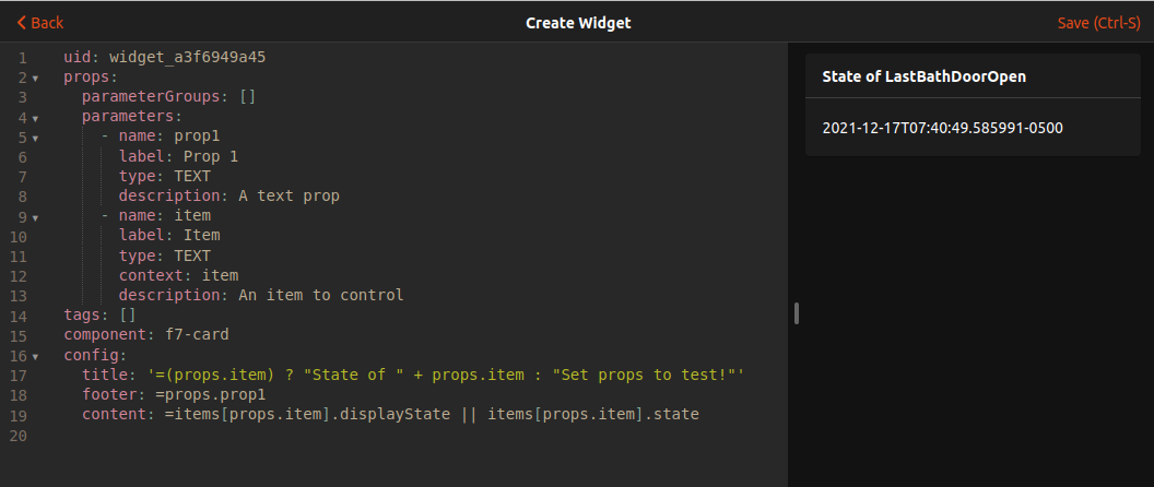

here is result
notice last line of yaml in code window
content: =items[props.item].displayState || items[props.item].state

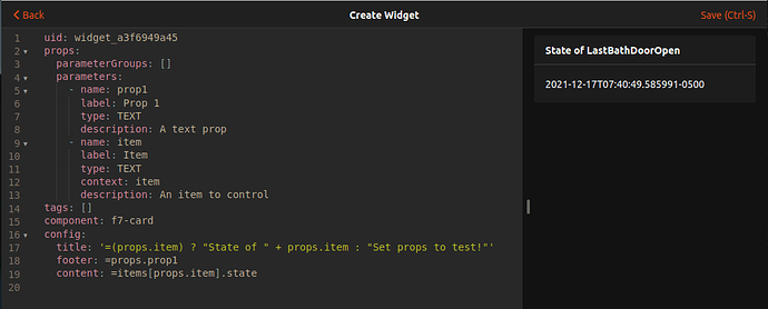

then I edited it to this
content: =items[props.item].state
and got
Duh… still the same… so then I edited last line again and made it this

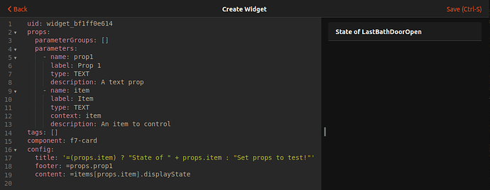

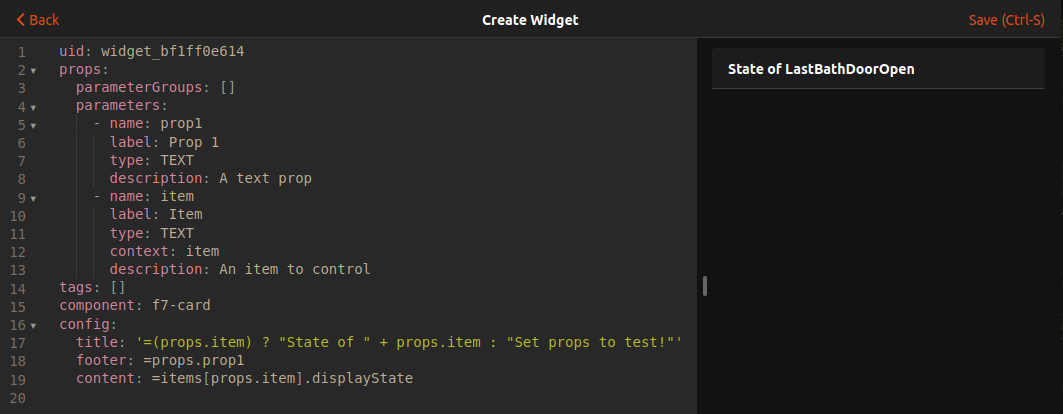

and got this
actually last night it was a dash like so -
sort of what PaperUI would give when there was no state to show (state was nan)
