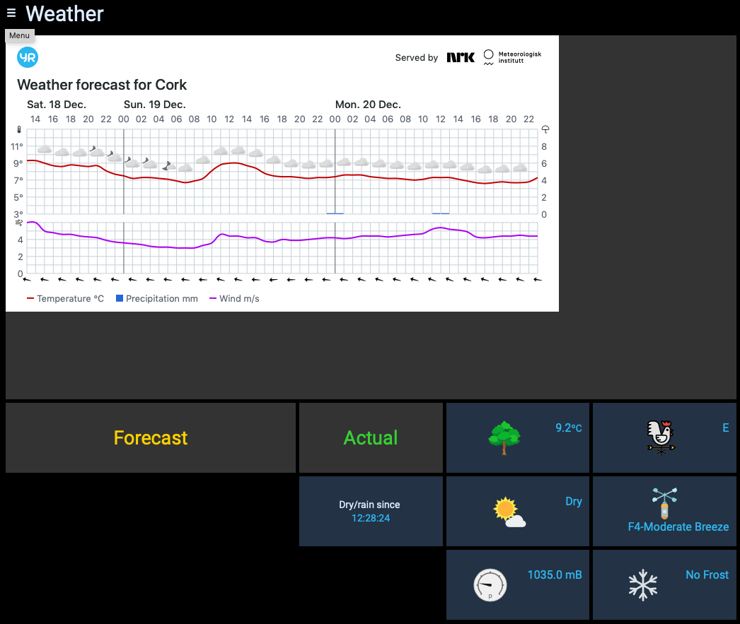

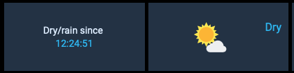

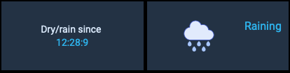

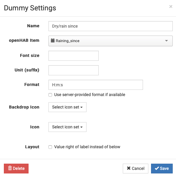

I still use Habpanel on my iPad display and have posted a few screen shots of the set up to remind us how simple and elegantly a display could be and still can be achieved.. note that in these pics, I deliberately deleted the Item metadata pattern (since it’s being blithely ignored in OH3 UI) and let Habpanel do some simple parsing on the raw time stamp.
I would also remind us how all this torture and fuss so far was obviated in the Basic UI + Sitemap with 2 lines code. Ah yes…the good old days…
