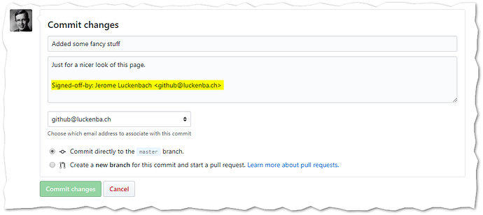

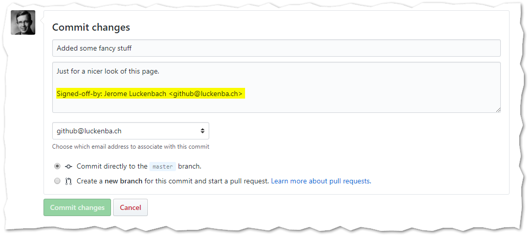

In the GitHub web editor
This is also not difficult, but unfortunately there is no native way to automate this.
(I think GitHub should have come up with a native solution long ago, but thats how it is currently…)

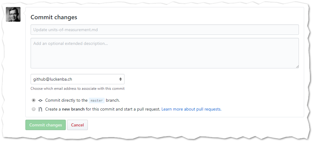

When you use the web editor, you have some form at the bottom of the edit page.
You can add your sign-off-statement in the extended description.
Make sure that it is the last sentence of your commit.
DCO Check will recognise it and should pass.
(Maybe there can be other problems with your github account configuration, but mostly it should work now.)

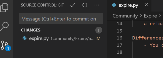

Since a lot of us are using VSCode, I suppose it’s worth mention that you you can do this through VSCode as well.
To create a PR and sign off your commits properly in VSCode…
Assumptions:
  • already forked the main repo
  • cloned your fork to a local directory
  • opened the repo into VSCode
  • you are already checked out to the “main” branch, whatever that may be named for the given repo (it’s not always “main”)

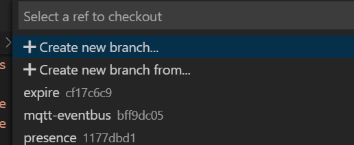

  1. Create a branch for your PR. First click on the Source Control Icon on the left (ctrl-shift-g)
  2. Click the three dots menu to bring up “More Actions” and choose “Check out to”
  3. Choose “Create new branch…” or, if you want to create a new branch from some other branch that isn’t main, or you are not currently checked out to the main branch choose “Create new branch from…”. Give the branch a meaningful name.
  4. Make your edits.
  5. Return the source Control tab. All of your changes should be in the list.
  6. When you hover over each file you will see three icons. Click the “+” to stage the change. This is the equivalent of running git add <filename>.

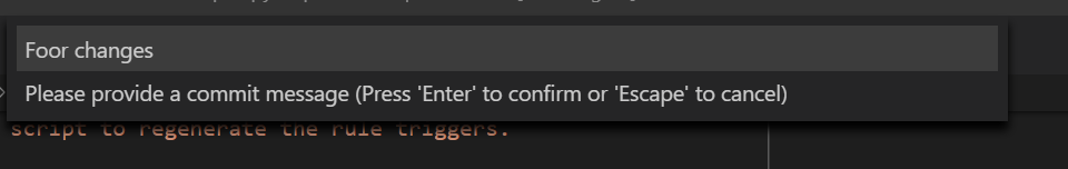

  7. Once you’ve staged all the changes you want to check in, click the three dots again and choose “Commit staged (Signed Off)”.
  8. Enter your commit message.

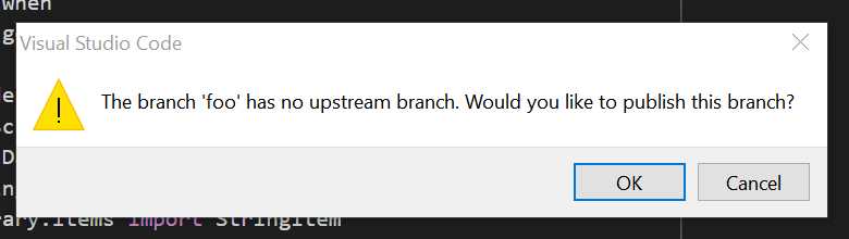

  9. Click the three dots again and choose “Push”. Since this is a new branch it will ask if you want to publish the branch. Choose “OK”
  1. Select “origin” from the list. Unless you are a maintainer like Confectrician or 5iver you probably don’t have permission to push to “upstream”. You only have to do this once. Subsequent pushes will go to origin.

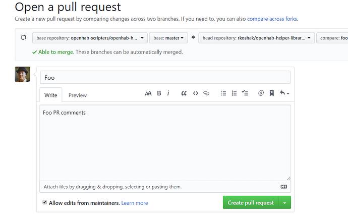

  2. Open your fork on GitHub. You will see a new button asking if you want to compare and create a PR. Click on it.
  1. Fill out the comments and make sure the PR has a meaningful name and click the “Create pull request” button.
Where I’ve gone wrong in the past is I’ve tried to add the signed off line to the PR comment, not the commit. It needs to be made to the commit.
