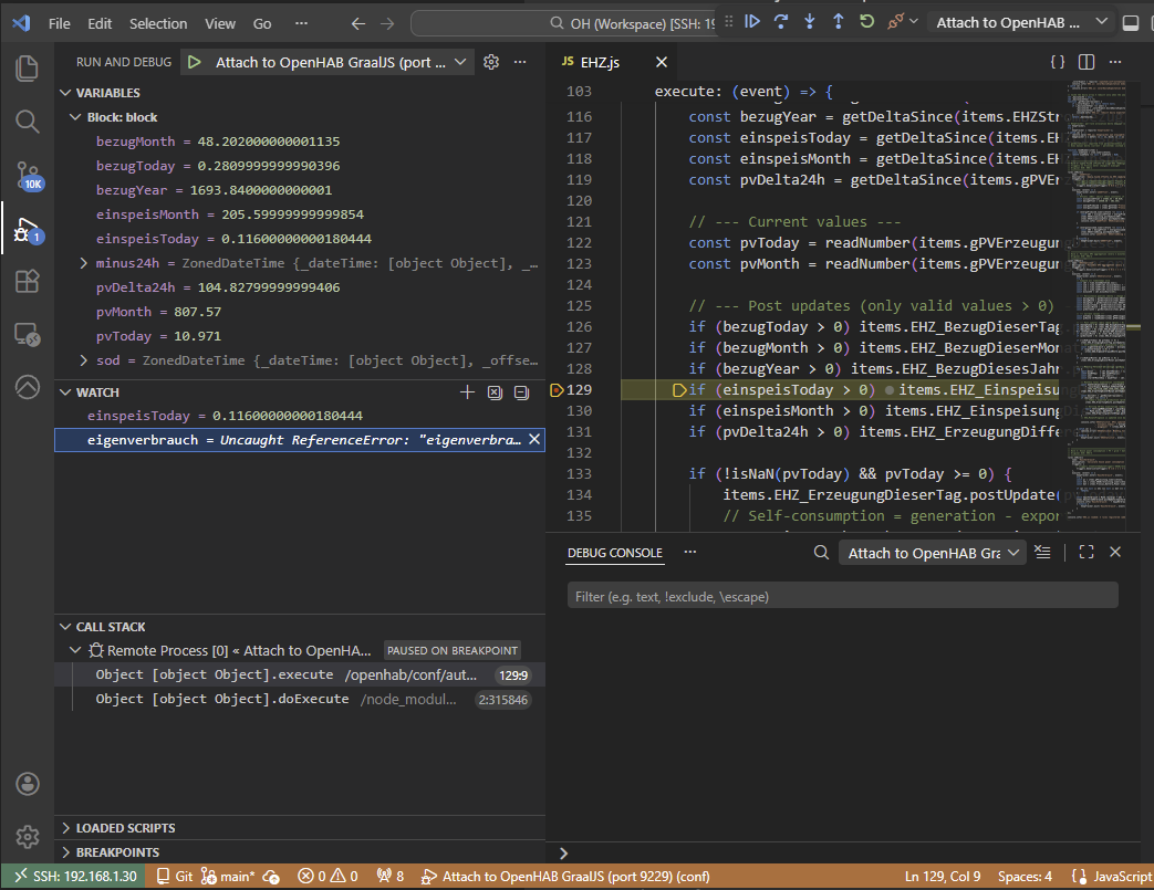

anyone ever wished they could debug their OH rules with a debugger ? I mean like using breakpoints, watching variables and all that ? Here you go (JS files only) :slight_smile:
OpenHAB ships GraalJS but not the debug instrument. You supply it. Four steps:
  1. Download 3 JARs, patch their manifest. The JARs (chromeinspector-tool, profiler-tool, json) are plain Maven artifacts. They need one manifest header added (Fragment-Host: org.openhab.osgiify.org.graalvm.truffle.truffle-api) so OSGi merges them into the Truffle classloader. A Python script does this automatically — downloads, patches, deploys to /openhab/addons/:
    python3 wrap_graal_fragments.py --deploy /opt/openhab/addons
  2. Copy a launch config to VS Code. Paste this into .vscode/launch.json:
        "type": "node", "request": "attach",
        "name": "Attach to OpenHAB GraalJS",
        "address": "<YOUR_OPENHAB_IP>", "port": 9229,
        "localRoot": "${workspaceFolder}/automation/js",
        "remoteRoot": "/openhab/conf/automation/js",
        "restart": true, "continueOnAttach": true
  3. Expose port 9229 and add JVM flags (Docker only). In docker-compose.yaml:
    ports:
      - "9229:9229"
    environment:
      - EXTRA_JAVA_OPTS=...existing... -Dpolyglot.inspect=0.0.0.0:9229 -Dpolyglot.inspect.Suspend=false -Dpolyglot.inspect.WaitAttached=false -Dpolyglot.inspect.Secure=false
  4. Restart. docker compose stop openhab && docker compose rm -f openhab && docker compose up -d openhab
That’s it. Trigger any JS rule, then press :play_button: in VS Code’s debug panel. The rest of this document explains why each step is needed and what to do when something goes wrong.
For more details visit the repo. And ask claude to set it up for you…
Next steps (to make this even easier): Someone add the OSGI wrapped .jar files to the OpenHAB distribution :wink:
