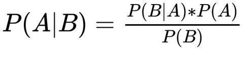

Based on the alternative form of the Bayesian Theorem I created a weighted aggregation function for openHAB. A Bayesian sensor attempts to guess whether something is true or not based on a series of observations.
Simple Form
Alernative Form
