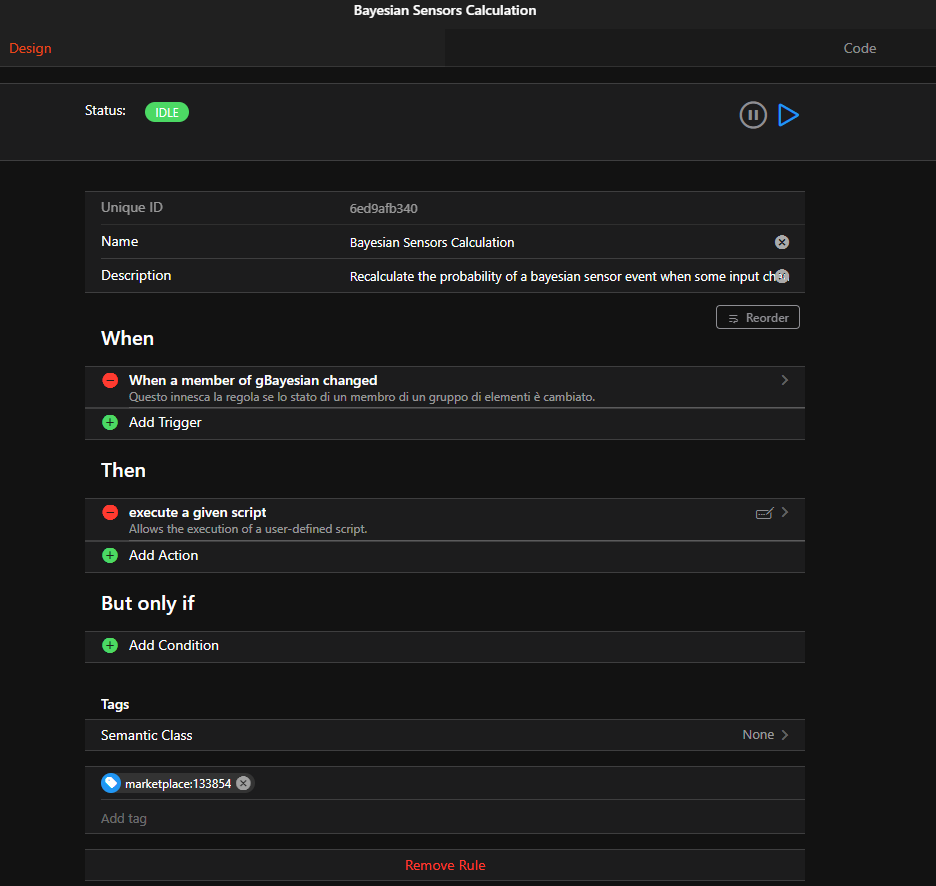

Step 2) Because I want to set up “manually” I add a Group in Model
containing two Switch point test items as following images
Step 3) I create a rule to calculate Bayesian probability as follow
and here I’m stucked…

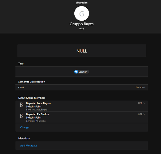

I thing in step 4) I need to set the configuration parameters of the Bayesian group and items but I’m not able to find the metadata…
here what I see if “metadata” label of group is clicked…
seems strange to me do not see the category you mention in the main post…
Is all right the steps untill now ?
what is the correct way to proceed in configuration?
thank you
Custom metadata namespaces do not show up in the list (this is a much asked for feature…).
You have to press the Enter Custom Namespace button and manually enter BayesianSensor.
