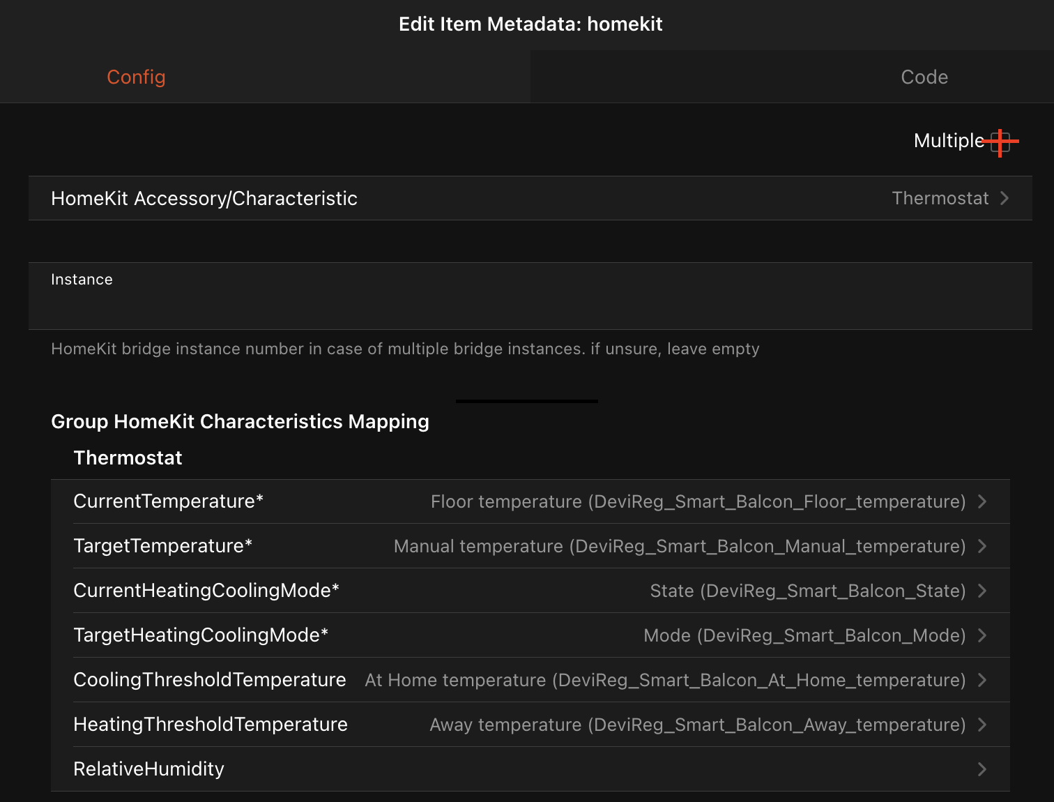

Ok, maybe this would be hepful for others like me fist time users of openHub
I’ve made Model for each Devi Reg for ease of groupinng points.
Then added metadata with “multiple” selection (grouped point in one Thermostat instance).

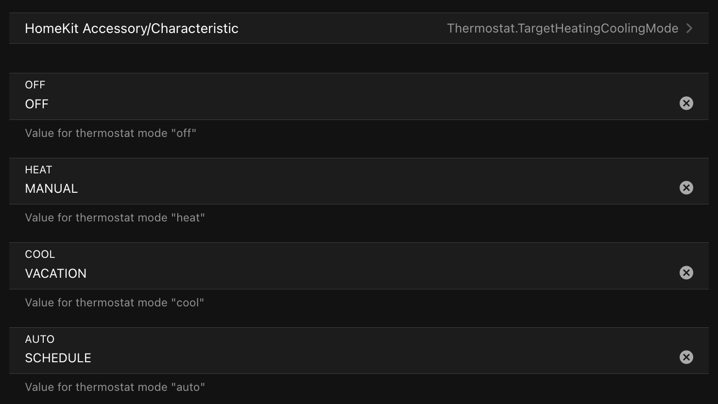

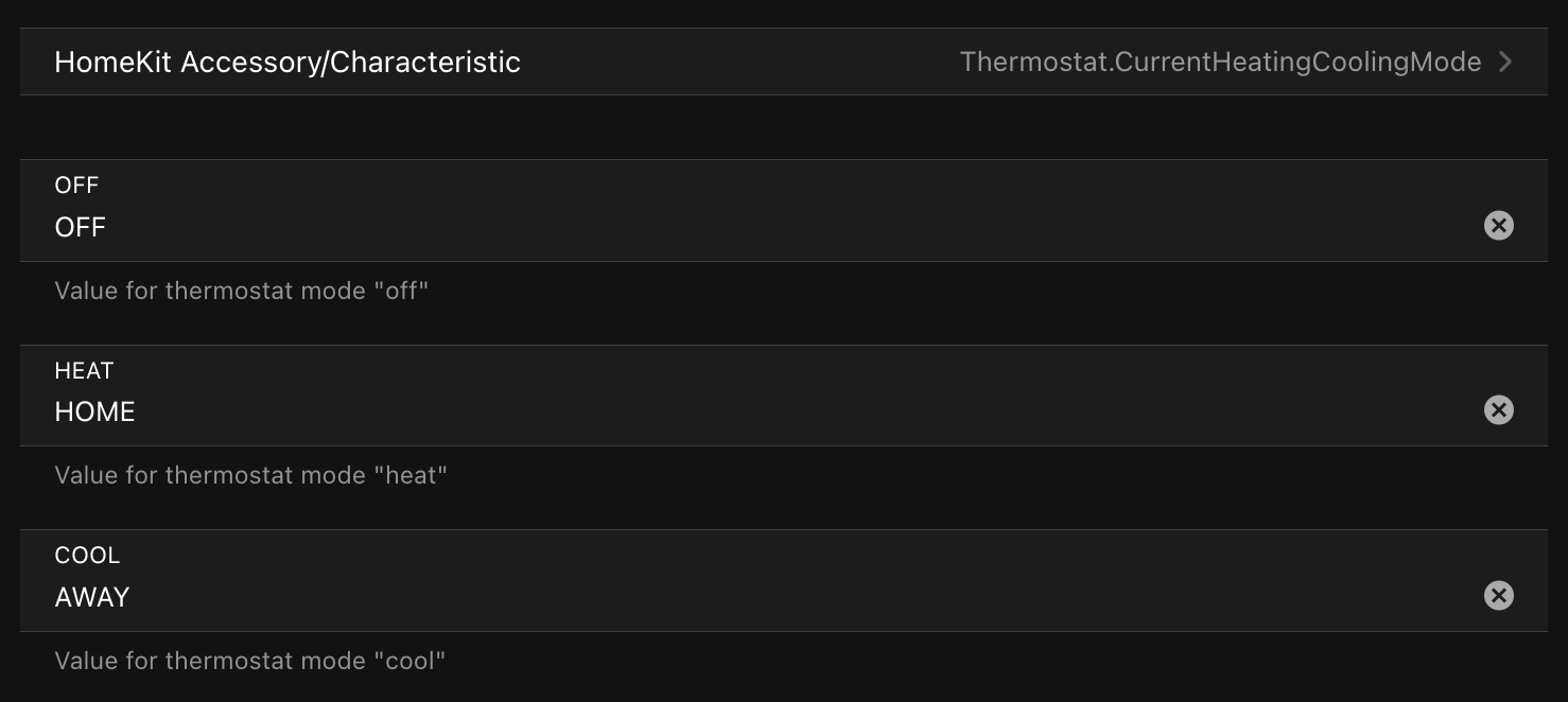

And chosed this values for mode and state.

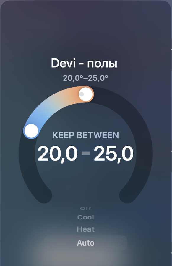

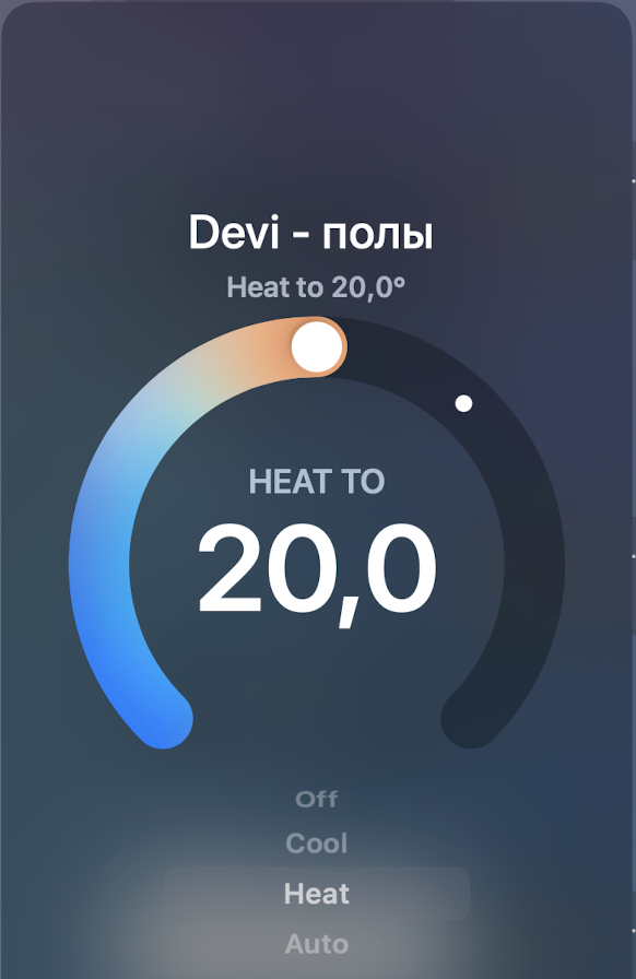

So in HK Auto is Sheduled mode now with Home/Away temps as threshold.
And manual as manual temp only and so on.
