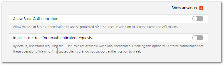

Implicit user is not enough in your case?
Not sure if my issue has to do with authentication at all, that’s why I wanted to completely disable API auth to see whether this is the cause of the error. Implicit user role is already enabled.

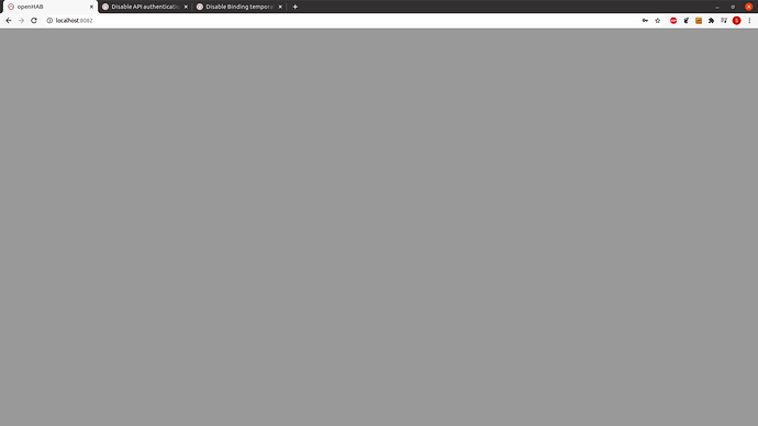

i’ve tried it also and it works. But when I log in, openhab always gets stuck and I can no longer see my things, item etc, so like in the screenshot. So to speak, the GUI no longer works!?
