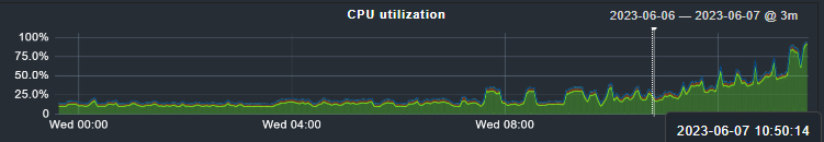

Some syslog messages are showing up since the previous (including the last) iteration:
Jun  7 15:59:23 openHABianDevice karaf[18733]: java.lang.IllegalArgumentException: Duplicate channels upnpcontrol:upnprenderer:3c2012a3-5a3a-1311-0080-00067851e9ee:Zone4mute
Jun  7 15:59:23 openHABianDevice karaf[18733]: #011at org.openhab.core.thing.util.ThingHelper.ensureUniqueChannels(ThingHelper.java:152)
Jun  7 15:59:23 openHABianDevice karaf[18733]: #011at org.openhab.core.thing.util.ThingHelper.ensureUniqueChannels(ThingHelper.java:128)
Jun  7 15:59:23 openHABianDevice karaf[18733]: #011at org.openhab.core.thing.binding.builder.ThingBuilder.withChannels(ThingBuilder.java:86)
Jun  7 15:59:23 openHABianDevice karaf[18733]: #011at org.openhab.binding.upnpcontrol.internal.handler.UpnpHandler.updateChannels(UpnpHandler.java:303)
Jun  7 15:59:23 openHABianDevice karaf[18733]: #011at org.openhab.binding.upnpcontrol.internal.handler.UpnpRendererHandler.updateDeviceConfig(UpnpRendererHandler.java:270)
Jun  7 15:59:23 openHABianDevice karaf[18733]: #011at org.openhab.binding.upnpcontrol.internal.UpnpControlHandlerFactory.remoteDeviceUpdated(UpnpControlHandlerFactory.java:299)
Jun  7 15:59:23 openHABianDevice karaf[18733]: #011at org.jupnp.registry.RemoteItems$2.run(RemoteItems.java:170)
Jun  7 15:59:23 openHABianDevice karaf[18733]: #011at java.base/java.util.concurrent.ThreadPoolExecutor.runWorker(ThreadPoolExecutor.java:1128)
Jun  7 15:59:23 openHABianDevice karaf[18733]: #011at java.base/java.util.concurrent.ThreadPoolExecutor$Worker.run(ThreadPoolExecutor.java:628)
Jun  7 15:59:23 openHABianDevice karaf[18733]: #011at java.base/java.lang.Thread.run(Thread.java:829)
This leads to the system getting unresponsive:
I updated the binding, stopped the bundle, deleted the thing, started the bundle and discovered the thing again. Is that also ok?
Thanks again
New version available that should at least solve the CPU utilization issue. I reworked a few things, hoping to get one step further again. It is difficult to debug, as I don’t have any device with embedded media server or renderer. Still trying to go step by step.
No worries! I am very thankful for your support!
Channel log entries are gone, cpu stays low. :+1:
