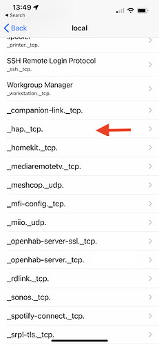

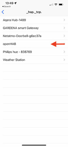

if you still have “Refreshing” state or you when you get it next time, please check in discovery app whether you see openhab there and what is the IP address in the openhab entry there.
I also found that after a restart of the OpenHAB docker container the HomeKit devices will be unavailable, until I manually enable/disable ‘Use openHAB mDNS’ in HomeKit Integration settings.
@mjeshurun could you please check after restart whether you see openHAB in discovery app on iOS and if yes, what is the IP address.

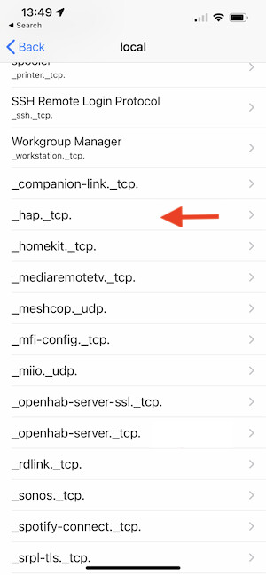

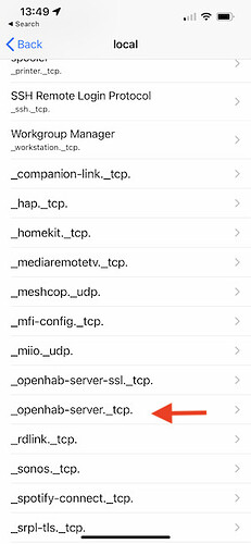

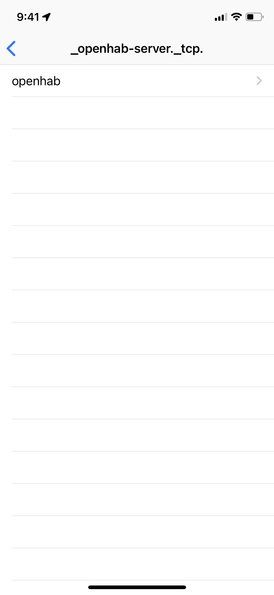

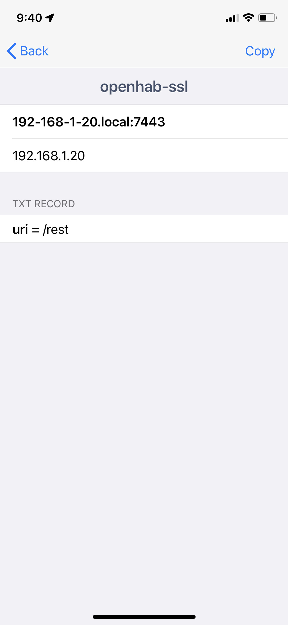

just to understand what is the issue:
mDNS is not started correctly (in this case you dont see even _openhab-server._tcp in discovery app)

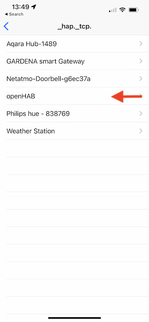

mDNS is started correctly but homekit is not published correctly. you see _openhab-server._tcp but no openHAB in _hap._tcp

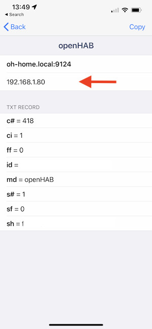

mDNS is started correctly and homekit is published correctly but with wrong IP address. you see both , _openhab-server._tcp and openHAB in _hap._tcp but home app still cannot connect. here we need to check the IP address in _hap._tcp

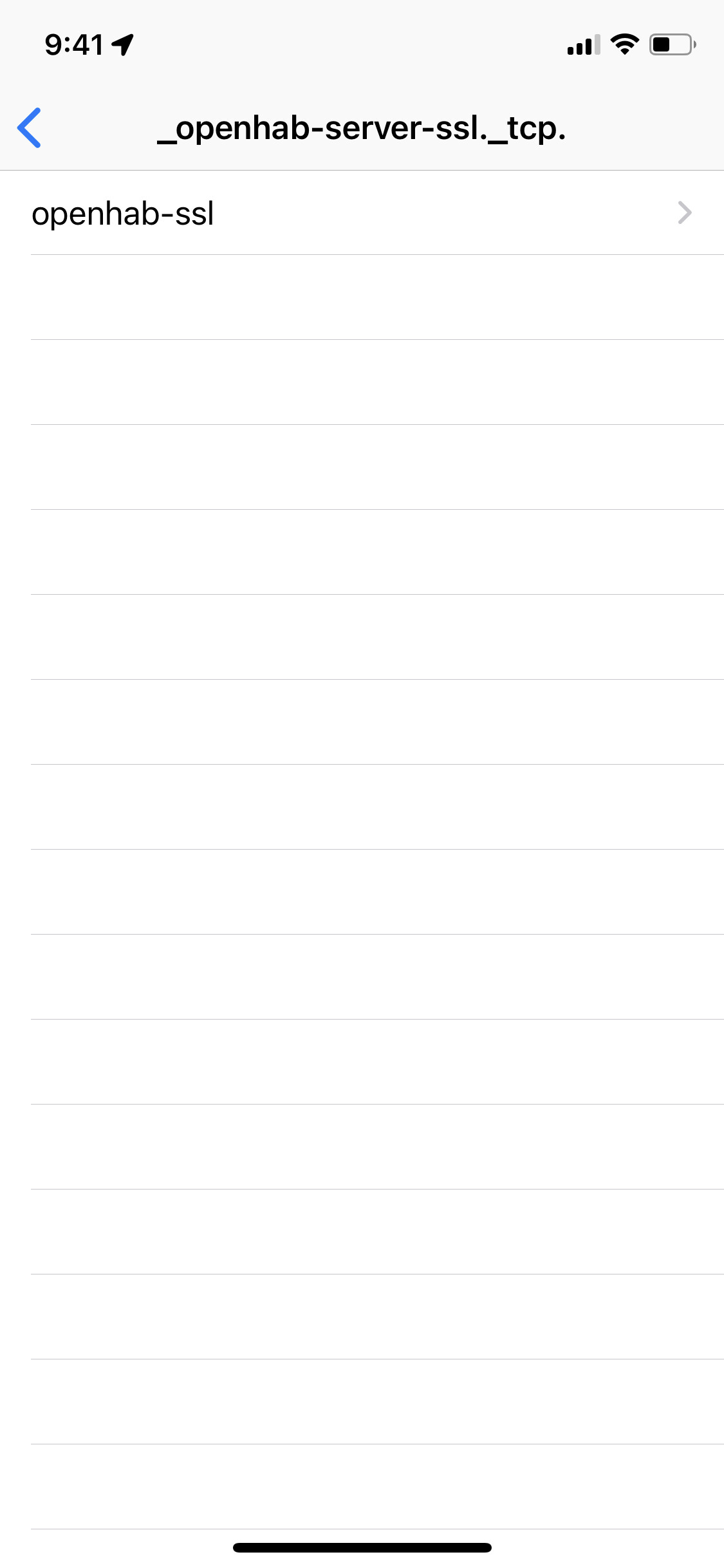

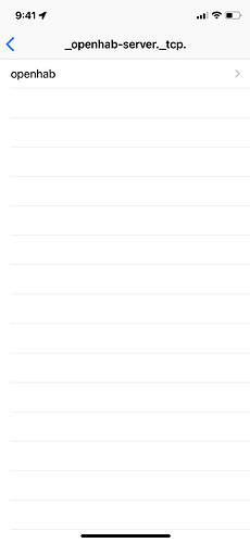

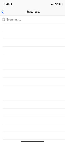

here are the screenshots
Seems like my problem is no. 2.

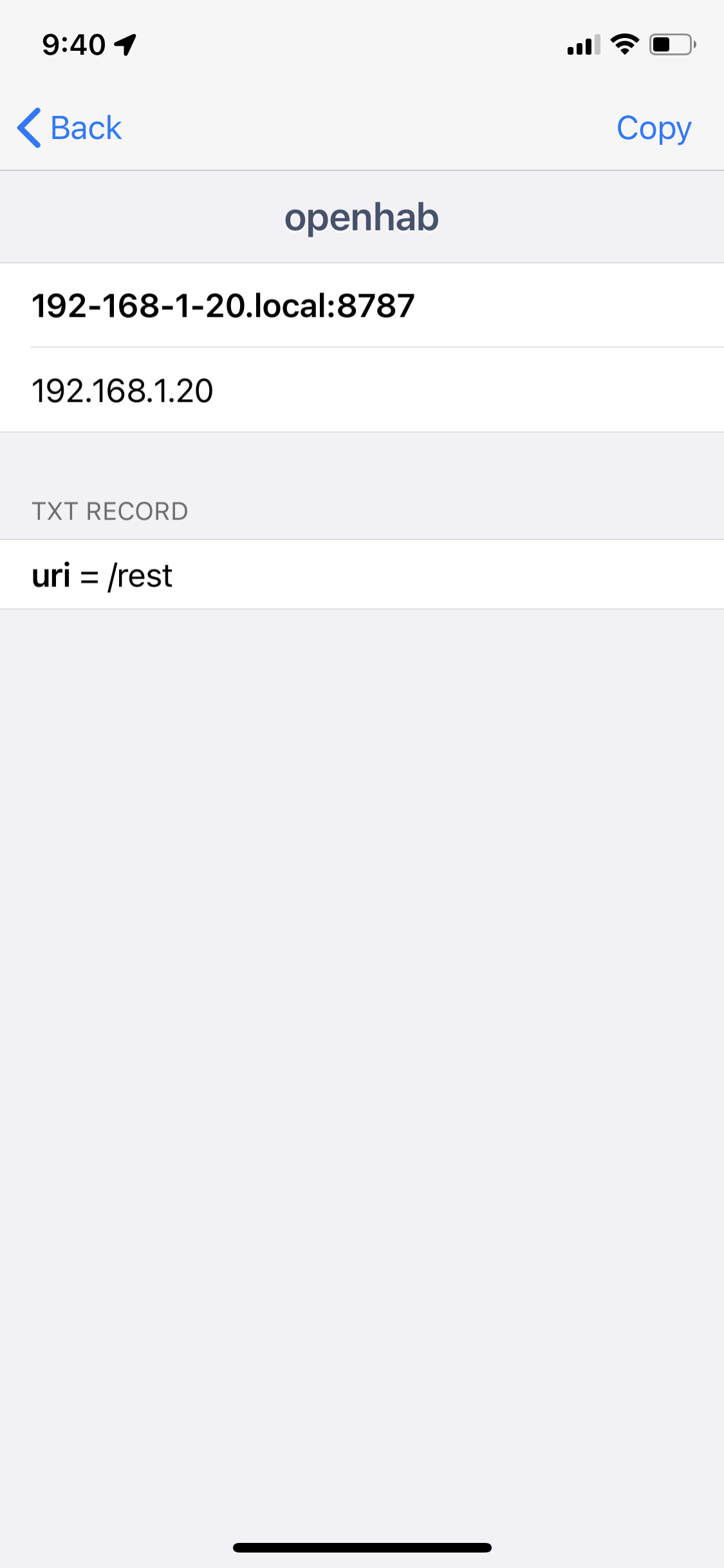

After a restart of the OpenHAB container, I can’t see OpenHAB under _hab._tcp. I can only see “scanning”.
The other OpenHAB services show the server’s IP properly.
ok. that helps. it is not network or docker issues. so, no need to try different network settings, etc.
it is an issue with homekit binding. not sure which version you have, but please try to upgrade to latest milestone version. it has few fixes related to mDNS.
