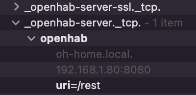

I use a mc and with the Discovery APP I can’t see the oh3. The oH2 is in the List. I think also the Network correct.
The Raps with Docker and OH3 have Lan.
I think the Problem is OH with HomeKit inside a Docker volume. I testing with avahi, but I can not find the correct configuration.
Thomytp
do you see openhab on the list in discovery app on mac or ios?
  1. if you see openhap but not _hap._tcp then the issue is with homekit binding. try to re-install it, set IP address in the homekit settings
  2. if you dont see openhab then it is a network issue. im not a docker expert but check something like docker + mdns
is see only the OH2.5 Version:
Bildschirmfoto 2022-03-22 um 08.48.18

if you dont see openhab (_openhab-server._tcp) in discovery app then it is a network issue, not the binding.
port is open. then it is probably broadcast.
