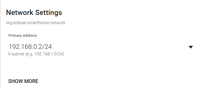

Ben.. Did you see my post regarding those few files which contains IP number?
Could you perhaps spread some note about what happens, if a user restore the backup to another system which has another IP number?
My most worries is the \userdata\config\org\eclipse\smarthome\network.config file.
The rule I mentioned earlier about $OPENHAB_USERDATA containing UI settings is relevant for most of variables stored in $OPENHAB_USERDATA\config\. An important part of the restore process is to check that the system has the correct values for the new machine. The IP value for example will copy over from the old machine but openHAB should change it and you can and should check this in paper UI:
/paperui/index.html#/configuration/system
I don’t think this is true for InfluxDB but there should still be a setting in PaperUI to view it if it’s in $OPENHAB_USERDATA/config/
