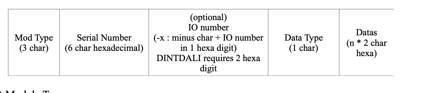

i understand that, but physically how do you control this device without OH? i suppose you don’t have 64 wall switches connected to it…
If so
no of course! For example, I put 24 DALI spotlights on the ceiling of my veranda and I created groups in GoldenGate. The advantage is a very simple wiring (5G 1.5mm2) which connects all the spots together. Under OH I intend to use rules. But for that I must be able to order each of the outputs …
The DALI module is similar to the DIM module except for the number of outputs … and the command syntax is of course different.
so basically you would need a thing in OH with 64 separate channels…
it would be perfect ![]()
