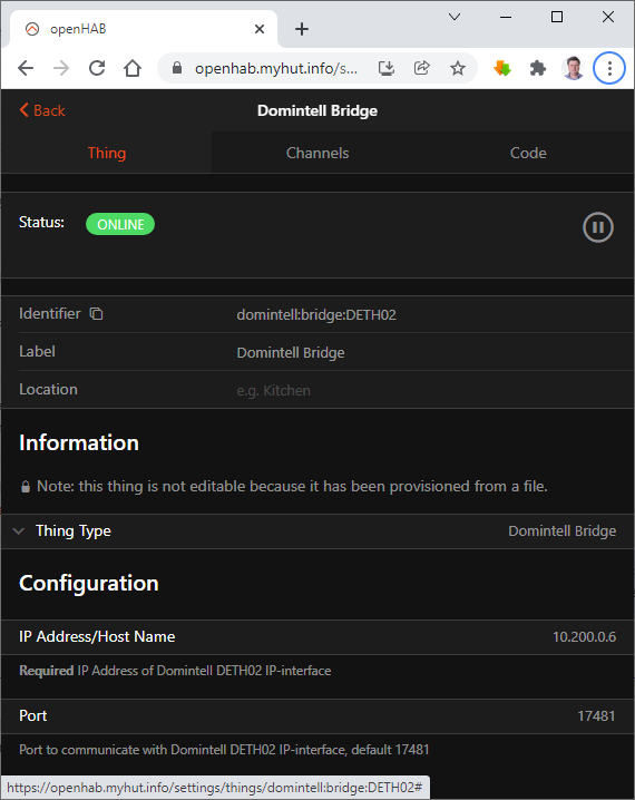

Hello Tom,
after installing openhabian, I could now get domintell binding running. My DETH02 was added as a thing after coming in my inbox.
The IP address is correct and DETH02 is working well with my domintell app on my Ipad connected on same network..
Now it is online, how does-it work to discover the domintell things through the UI?

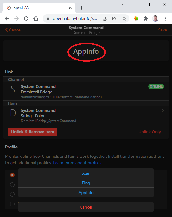

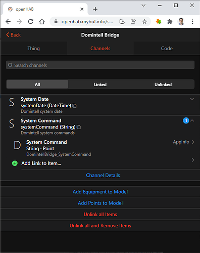

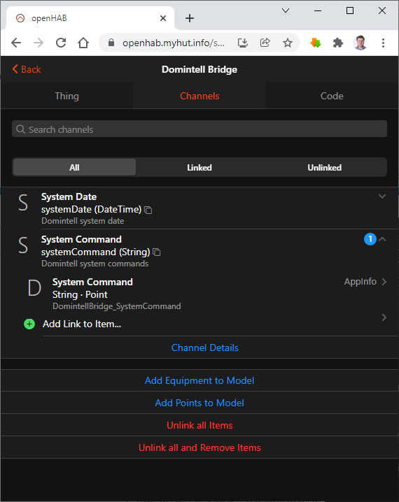

Hi Pierre,
You should have a thing for Domintell Bridge
with a channel named System Command
Create String type item and link it to this channel. You can use the UI for this (Add Link to Item…)
If you send a command AppInfo or Scan to this item the binding will fill your inbox with your Domintell things. If you want to use the UI then select the item you’ve create above and if you click the value on the top (the value is already AppInfo on the screenshot or you will see NULL) then options will pop up at the bottom of the page
BR
