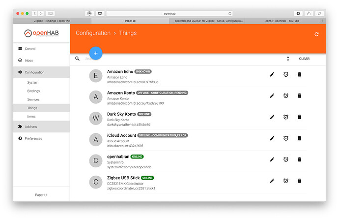

That seems to be impossible?
I would have said that the binding is not running if there’s nothing in the log, but in the image it shows the stick is online, so it must be running, and then there must be stuff logged in the debug log.
