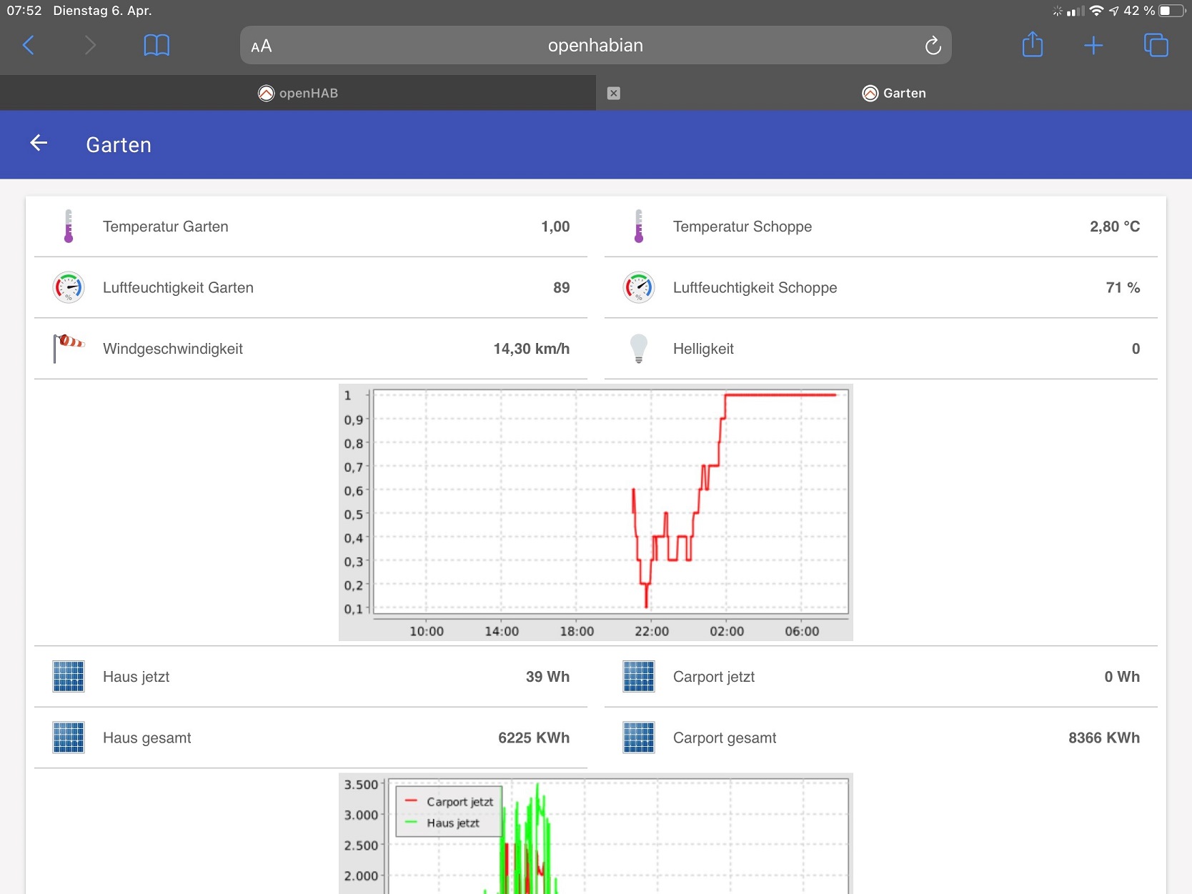

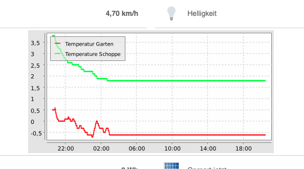

However, each night my OH3 do not communicate which my Homematic any longer. At 2am all connections seems to stop. I viewed the logs but there are no information at all. Only ntp and Modbus are working without error. There are no information whats happent with Homematic communication.
See also attached screenshot.
The homematic communication on OH2 is not affected and still working after 2am.

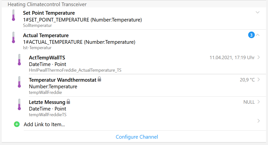

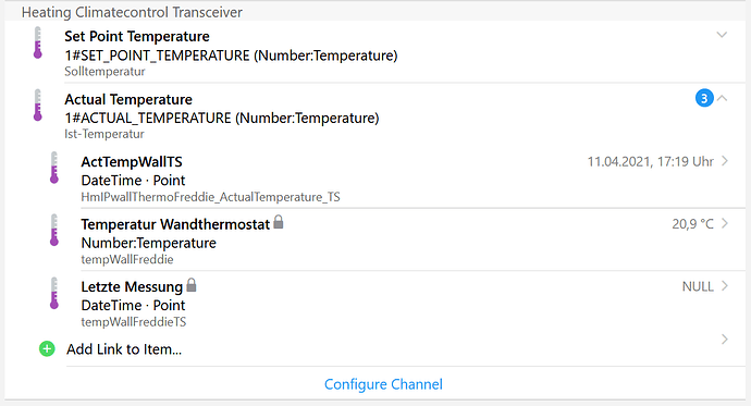

But there is one weird thing I do not understand: I linked 2 timestamp items to my ActualTemperature thing. One of them using UI the other using an .items file. The item defined in the .items file receives NULL while the item defined by UI receives correct timestamps. Both of them have a profile and a stateDescription.
.items file:
DateTime tempWallFreddieTS "Letzte Messung [%1$td.%1$tm.%1$tY %1$tH:%1$tM]" <temperature>   ["Point"]  {channel="homematic:HmIP-WTH-B:3014F711A0001F5A49940499:00265D89897A70:1#ACTUAL_TEMPERATURE"[profile="timestamp-update"], stateDescription=""[pattern="%1$td.%1$tm.%1$tY, %1$tH:%1$tM Uhr"]}
I must be doing something wrong in my .items file. Can somebody help please?

Replying to myself in case anybody might be interested: The problem was the name of my item defined in the items-file. There is one called “tempWallFreddie” for the temperature and the failed one named “tempWallFreddieTS” for the timestamp of update.
If I rename the last one to “tempWallFreddie_TS” evrything works fine. Obviously items have to have names that differ in a minimum of 3 characters. ???
