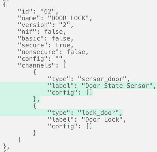

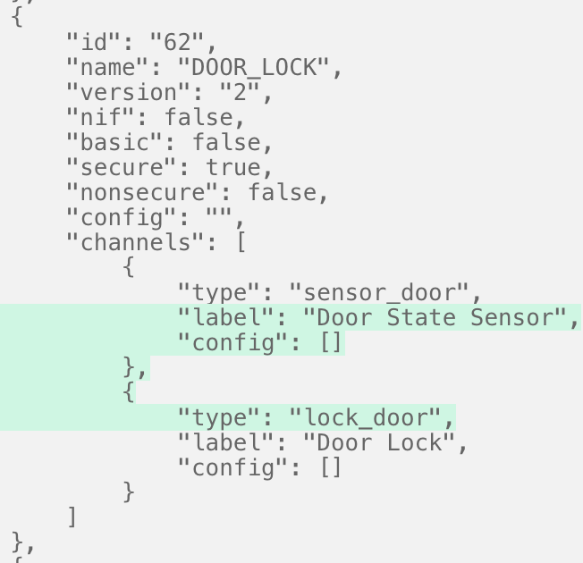

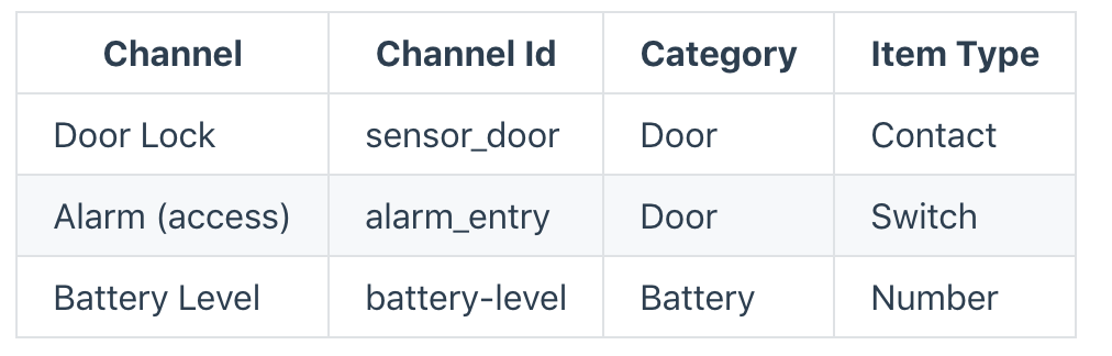

chris
(Chris Jackson)
October 16, 2018, 7:33pm
9
Then I’m confused as well, as the database doesn’t show this -:
This shows that the sensor_door channel already exists, and the lock_door has been added.
However, in the documentation (which also comes from the database, but a slightly older version), it does confirm what you see -:
So, I guess that someone has updated the channels in recent times . Anyway, this will move it back again.
