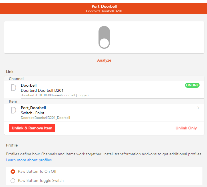

most of the things work, for example images and image timestamps, trigger for the light.
but the most important doesn’t work, i can’t get any event from the doorbell pressed or motion.
When checking logs, i can’t find any trigger fired from the Doorbird.
