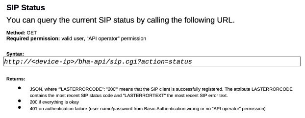

There’s a SIP status call in the API spec. Can you post the JSON returned in the following two situations:
  • there’s no SIP call in progress
  • a SIP call is in progress
From the API spec…
Assuming this indicates a call is in progress, I can implement a thing action to check if a call is in progress. It likely would be called isSipCallInProgress() and would return a boolean.
no call in progress:
{"BHA": { "RETURNCODE": "1", "SIP": [{"ENABLE": "1","PRIORITIZE_APP": "1","REGISTER_URL": "192.168.178.1","REGISTER_USER": "xxx","REGISTER_PASSWORD": "xxx","AUTOCALL_MOTIONSENSOR_URL": "","AUTOCALL_DOORBELL_URL": "","SPK_VOLUME": "70","MIC_VOLUME": "33","DTMF": "1","relais:1": "0","relais:2": "","LIGHT_PASSCODE": "","INCOMING_CALL_ENABLE": "0","INCOMING_CALL_USER": "","ANC": "1","LASTERRORCODE": "200","LASTERRORTEXT": "OK","RING_TIME_LIMIT": "60","CALL_TIME_LIMIT": "180"}]}}
call in progress:
{"BHA": { "RETURNCODE": "1", "SIP": [{"ENABLE": "1","PRIORITIZE_APP": "1","REGISTER_URL": "192.168.178.1","REGISTER_USER": "xxx","REGISTER_PASSWORD": "xxx","AUTOCALL_MOTIONSENSOR_URL": "","AUTOCALL_DOORBELL_URL": "","SPK_VOLUME": "70","MIC_VOLUME": "33","DTMF": "1","relais:1": "0","relais:2": "","LIGHT_PASSCODE": "","INCOMING_CALL_ENABLE": "0","INCOMING_CALL_USER": "","ANC": "1","LASTERRORCODE": "183","LASTERRORTEXT": "Session Progress","RING_TIME_LIMIT": "60","CALL_TIME_LIMIT": "180"}]}}
Thanks.
This is the only difference I see. I’m not sure how to interpret this w.r.t. call or no call.
No Call
Call
"LASTERRORCODE": "183","LASTERRORTEXT": "Session Progress"```
I just had a look to the sip response codes: seems ā€œ183, session in progressā€ means ringing.
During my test I saw that a connected call is shown as ā€œ200, OKā€ followed by ā€œ200, Normal call clearingā€, when the call gets disconnected.
So, I think you can use ā€œLASTERRORCODEā€ : ā€œ183ā€ to consider a call is in progress. Ideally a connected call will not be interrupted, because the ā€œLASTERRORCODEā€ changes to ā€œ200ā€ after a successful connection.
