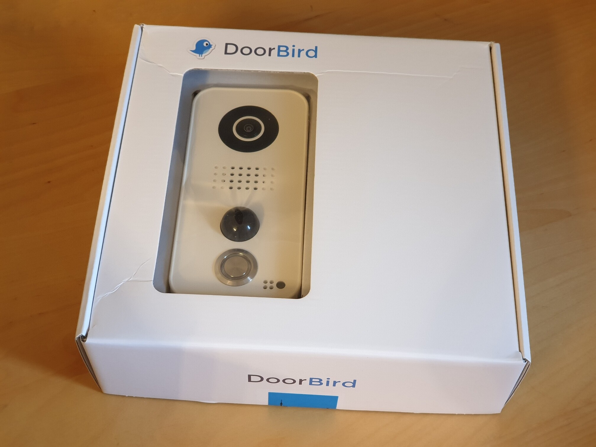

I couldn’t resist temptation any longer and ordered a D101 yesterday. Hopefully it will arrive tomorrow so I can tinker with it over the weekend. :slight_smile:

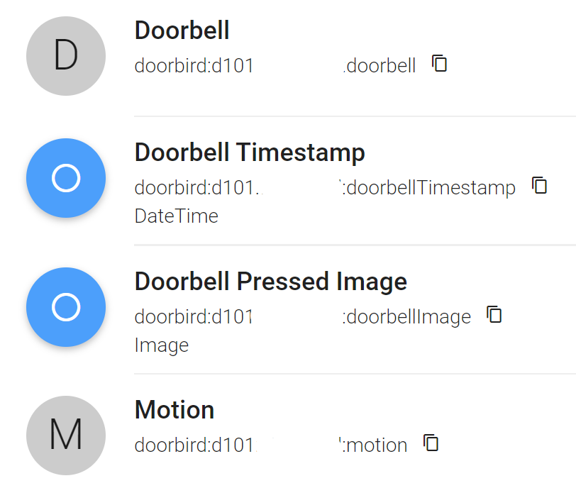

After a false start in which I thought the DoorBird was DoA but actually turned out to be because I’d plugged it into the non-PoE switch instead of the PoE switch I’ve got it up and running on the bench. However, the doorbell and motion channels are greyed out and don’t provide the option to attach an item to them:
Is this expected? I’ve enabled debug logging to a separate file and can see entries added to the log when I press the doorbell.
I created a second user as you suggested and enabled all permissions for it. I was a bit surprised that you can’t select the username and password, you just have to accept the username and the password it autogenerates for you every time you tap the “change password” button. Not a big deal though.
Hmm. I’ve not seen that before. In the version you’re running, the doorbell and motion channels are defined as triggers, with profiles that provide the Switch ON/OFF functionality. It’s possible that defining items based on profiles doesn’t work in PaperUI. Can you confirm that you’re using PaperUI to link the channels to items?

Yup, I’m using the Paper UI on OH v2.4 release.

Just to ensure you ment what I understood, you exlusivly use PaperUI to add items to the thing? No item files?
Yes, I have only used the Paper UI.
Yeah, it’s a little weird.
So I’m thinking about getting rid of the trigger definition on the doorbell and motion channels, for exactly this reason. I’ll make them plain vanilla switches. In the meantime, as a workaround, you can create an .items file for the doorbell and motion channels as described in the README.
Like this (note the profile section in the channel definition).

Excellent! I just created the doorbell pressed switch item and it’s worked! Thanks! :slight_smile: The switch status seems to permanently be on now, is it supposed to revert to OFF after a period of time? I could fix that with the expire binding and a proxy item.
