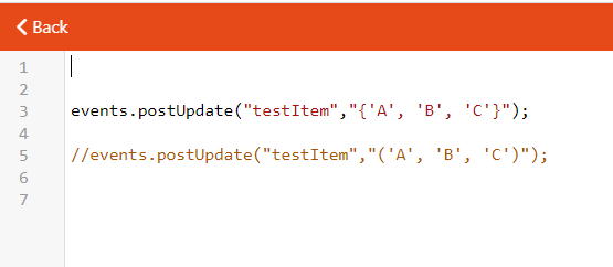

too bad that OH doesn’t support dropdowns yet. Your workaround (selection list #1) is very nice, but it doesn’t show any values/ the popup window remains empty.
My guess is that I need to fill “testItem” with the values I want to appear. So I created the item (as String) and tried to fill it as an array with a script:
Both versions didn’t work. Do you know what I need to do to get it working?

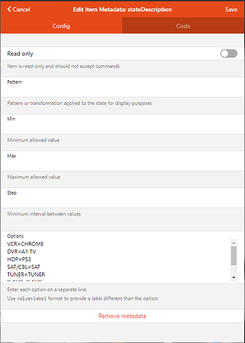

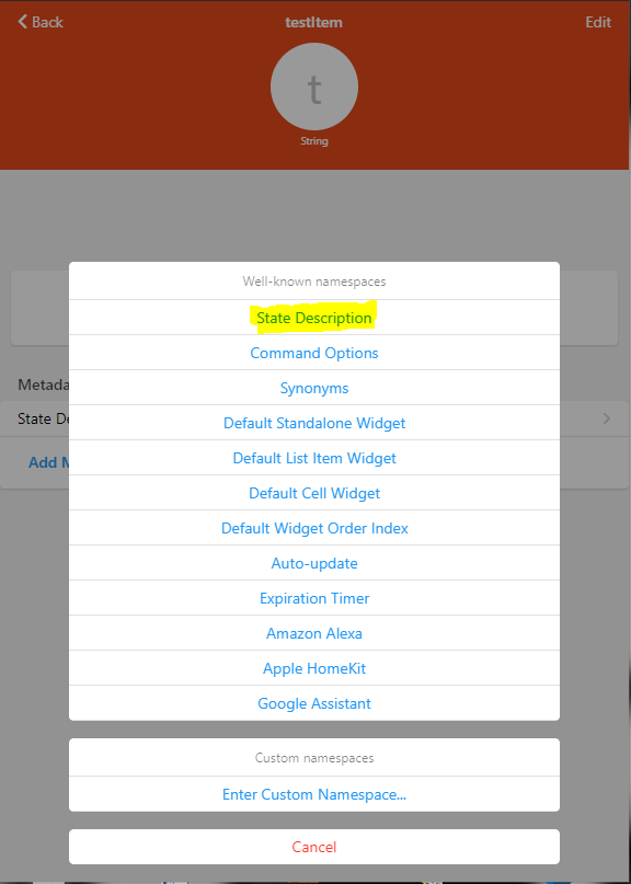

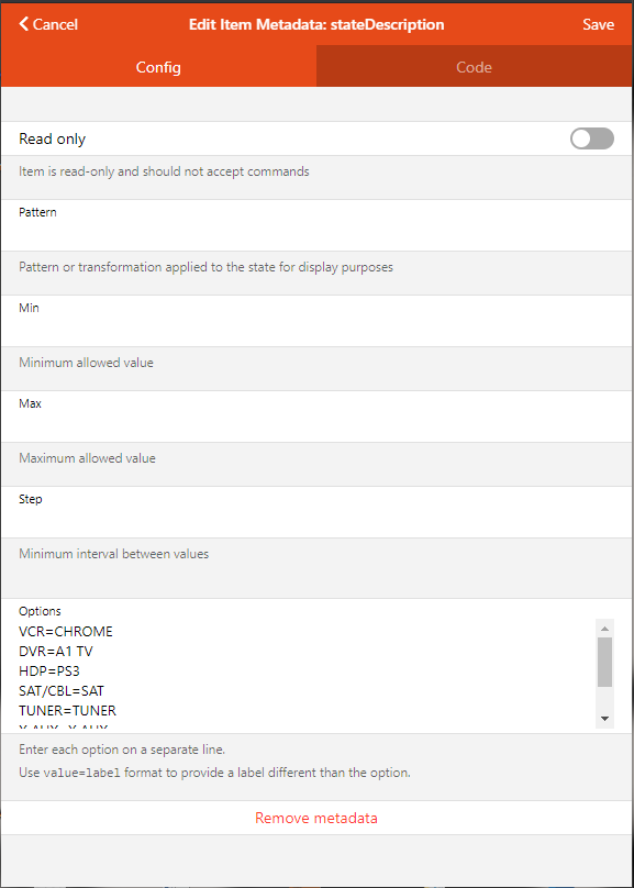

Hey @Ursusprimus
you have to assign the selection values inside the “Options” field of the “State Description” Metdata to that item:
Settings → Items → “testItem” → Add Metadata → State Description → Options
Thank you!

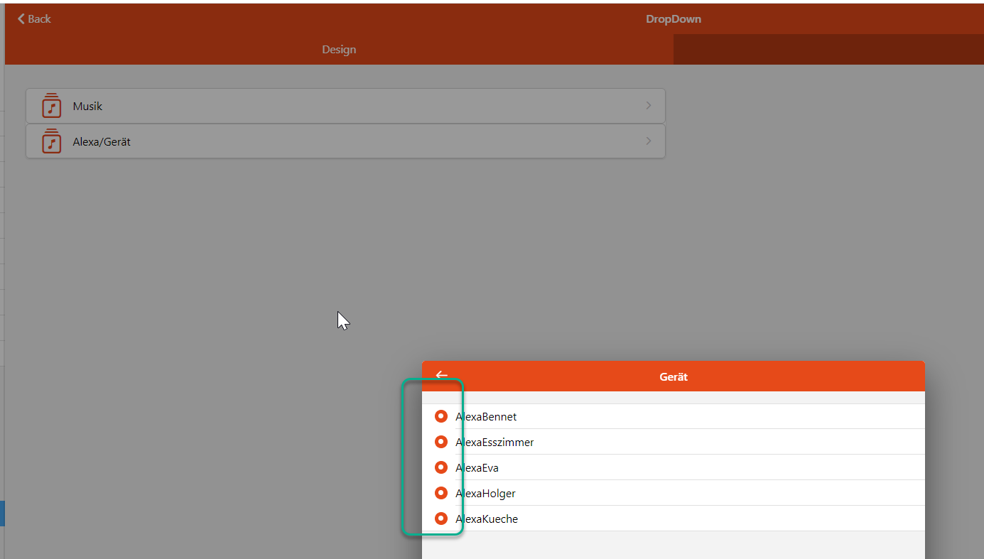

@RGroll Now I have follow up question/problem:
I’d like several of your drop down items in a list card (I’m aware that I’m not making use of your elegant programming where you can get several dropdown-lists next to each other just by adding three lines each). When I do so, most of the time (not always?) the second popup appears even when I click on the first dropdown-list.
It’s probably because of identical popup-window-names but since I don’t fully understand your code, I don’t know (and dare) what to change …
I tried line 30 (give it a fixed name), but that didn’t work. And messing with line 35 didn’t help either …

That’s great, thank you again! Not very important any more, but for perfection’s sake: Now all dots in the popup-windows are filled out - what to do about that?
Code isn’t really changed from your improved example, just another list item, so no real need to look at it, I think:

Ah sry, didn’t saw that - it’s about this line:
checked: "=loop.option.value === items[loop.selection.item].state ? true : false"
The loop.selection.item isn’t there any more and it tries to compare every of the list-entries with the current state to mark it as active (checked). So this should work:
checked: "=loop.option.value === items['Alexa_Musik'].state ? true : false"
