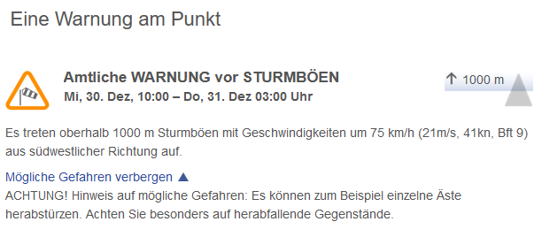

Normally, you just have to wait until there is a concrete warning for your city.
I had to wait several weeks, until today. Now there is a warning “Sturmböen” and it is available for my city.
If you change the URL from “Warnungen_Gemeinden” to “Warnungen_Landkreise” you will get more warnings, but the location is less precise.
