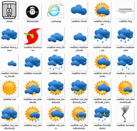

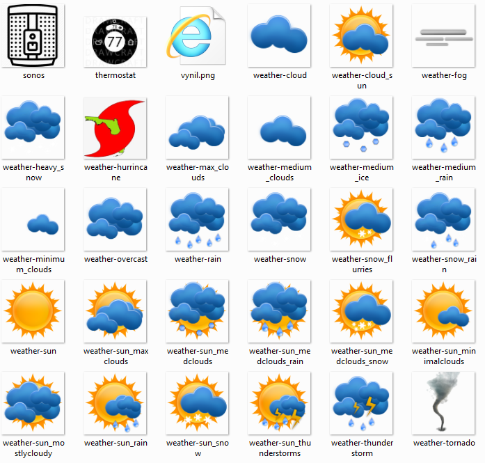

Ok, I was trying to actually use an icon image; why its named that way.
Alright, give the icon <weather> in your Item definition, but you must also have a default weather.svg or .png in your iconset
Yes sir, I do. It’s not on that screenshot, but I added it.
Ok, its showing the icon correctly; but, is there a way to display the icon as an image?
Yes, you put the full url to an image file in the content of the String Item that you pass to the Image widget.
That works best serving images from /conf/html folder I think
(The icon will not work then)
But if you use OpenWeatherMap there is a channel supplying a image
URL
And just so you know,
I dont want to use the image associated with the image channel as the images dont enlarge well, I want high definition images
Fair enough.
Put the images in /conf/html/
Load your Item state with a url like http://localhost:8080/static/weather-rain.png
Awesome, thank you for the suggestion.
