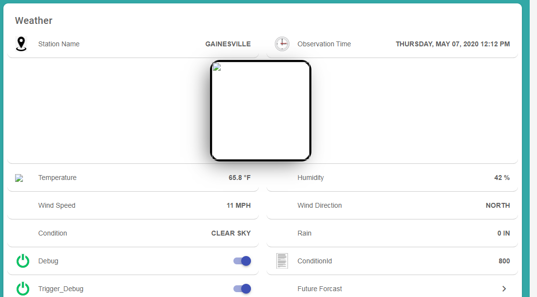

ImageChooser is defined as an Image type, should it not be? Then on the sitemap, as an Image.
I have found that the item definition has to be of type String to contain the url. You may have said this above, it didn’t register though. Now, item ImageChooser is correctly being updated to the correct url via the map.
But…on the sitemap, its called as an Image, but it does not display the image.
Most current log still says:
2020-05-07 13:08:54.542 [WARN ] [rm.AbstractFileTransformationService] - Could not transform ‘url=“http://10.2.1.129:8080/static/weather-sun.png”’ with the file ‘weather_icon.map’ : Target value not found in map for 'url=“http://10.2.1.129:8080/static/weather-sun.png”
I know from the logs that the transformation happens due to the logInfo on ImageChooser. I know the url will work because if I copy and paste to the browser, it shows the correct image. What is not being transformed properly?
Okay, here it is trying to look up “http … etc” in a map file that you have defined with entries for 123= , 567= and so on. It fails.
Somewhere, outside of a rule, you are using the map to try to fransform your URL.
What Item might that be associated with? I’ll guess you have only one Item that might have a URL as a state. the newly string-y ImageChooser.
Why would anything try to transform that? Because you’ve asked for the transform in your Item’s label [state presentation] section.
Either in your Item definition, and/or your sitemap line, which we cannot see.
Your events.log can tell you what an Item is changed to.
I would like to see an actual state of your Item, and your sitemap line.
I’m not convinced it works like that.
The URL that sitemap Image wants is the apparent “view” of the resource from the openHAB host, not the view from a browser (normally on a different box).
If you look at most examples, they have URLs like
http://localhost:8080/static/image.png
That is how they are mapped, isn’t it? Unless you mean no “localhost”…I can try to change that see if it helps. EDIT: Same error
My item declaration in the weather.items file:
String ImageChooser
And in the sitemap:
Image item=ImageChooser
So, the only transformation happening IS in the rule.
10.2.1.129 IS the localhost, just so you know. We have multiple networks, so was just trying to be specific.
It sounds like it is looking for a transformation of the url itself. If the only transformation I have is in the rules file, and it transforms the CondID to the url; any clue why its looking for one on the url?
Then show us the rule since you changed it last.
I guessed that it is - for now. The day you change it or migrate your openHAB, it will break your sitemap and you will spend an hour wondering why.
Can we see an actual matched set of the relevant parts here?
Your sitemap line
An events.log entry showing the relevant Item changing to an expected state (the URL in this case)
Let’s assume the previous BasicUI screenshot holds true, unless you show different.
This method does work for other people.

It is set as a static IP. I always set my installs as static…run into an IP address change too many times… ![]()
