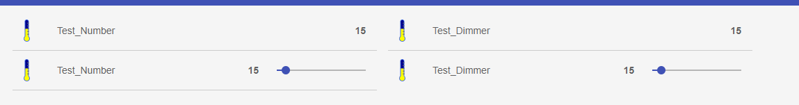

Can you please explain why I should post the widget code and sitemap definition if it works there? The problem only occurs in the Location- and Equipment- and Property Card. In the Item and Model Settings also only the default icon is shown, but there the default icons are shown for all ItemTypes.
Why would that help anyone? If I write: temp-0.svg / temp-5.svg / temp-10.svg and so on? The screenshots showed that the icons work. So that can’t be the problem.
The Basic UI and the Main UI are the result of the context. I have not mixed it up. I mean with Basic UI the Sitemap and with Main UI the Webinterface. I think the names of the UI’s are clear in openHAB.

Page Location
Sitemap Test
sitemap page_test label="test" {
      Text item=Test_Number label="Test_Number [%s]"
      Text item=Test_Dimmer label="Test_Dimmer [%s]"
      Slider item=Test_Number label="Test_Number [%s]"
      Slider item=Test_Dimmer label="Test_Dimmer [%s]"

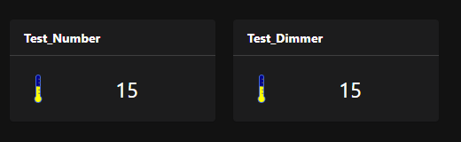

Page Layout
label: test
blocks:
  - component: oh-block
    config: {}
      default:
        - component: oh-grid-row
          config: {}
            default:
              - component: oh-grid-col
                config: {}
                  default:
                    - component: oh-label-card
                        item: Test_Number
                        icon: temp
                        iconUseState: true
                        title: Test_Number
                config: {}
                  default:
                        item: Test_Dimmer
                        icon: temp
                        iconUseState: true
                        title: Test_Dimmer
                      slots: null
masonry: null
grid: []
canvas: []

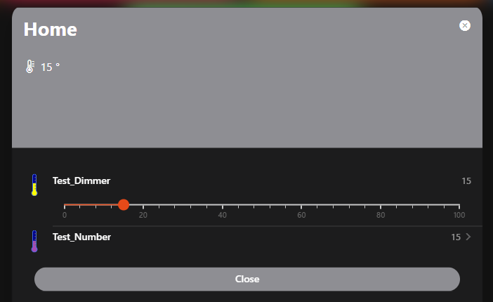

However, I’d like you to perform one quick experiment for me. What happens if you set the Semantic tag to ā€œMeasurementā€. Then add ā€œTemperatureā€ as the property tag. These need to be done on the Number Item. Does that give it enough context to set the icon properly?
IIRC, the semantic tag hints happen after the Item type hints.

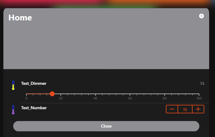

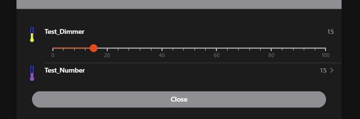

OK, so this icon on the Item’s page is always going to only show the default icon. So no surprised here so far. Same goes for the Number Item.
I’m not sure which screen this comes from, Settings->Items or Model but in either case this too only shows the default icon so this is expected too. Same goes for the Number Item.
what happens if you change the semantic tag on Test_Number to Setpoint? That should make MainUI choose a slider similar to what it chose for Test_Dimmer. You might need to provide a property though so if just using Setpoint doesn’t work, add a property tag of Temperature.
These all look to be displaying correctly.
I’m surprised this is working at all. Unless something has changed, in a MainUI widget the iconUseState property only works with oh icons and your property for the icon property is incorrect. It should be oh:temp to tell MainUI where to get the icon from.
I wonder how it’s getting the right icon? Maybe it defaults to oh: when not supplied? That’s new in OH 4, right @JustinG or has this been defaulting for awhile now? I only use f7: and material: icons so I wouldn’t have noticed the change.
Anyway, it’s clearly working even if based on my understanding it shouldn’t.
I also assumed that. I was mainly concerned with the Location Card
Settings → Model
Measurement
"Test_Number": {
  "class": "org.openhab.core.items.ManagedItemProvider$PersistedItem",
  "value": {
    "groupNames": [
      "Location_Home"
    "itemType": "Number",
    "tags": [
      "Measurement",
      "Temperature"
    "label": "Test_Number",
    "category": "temp"
Setpoint
  "Test_Number": {
    "value": {
      "groupNames": [
        "Location_Home"
      "tags": [
        "Setpoint",
        "Temperature"
      "category": "temp"
