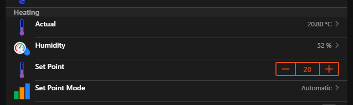

I have since noticed that the temperatures icons, although dynamically configured, are only displayed in the default design. Item Setting / Model Settings / Location Card

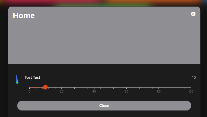

So, I created a Test item to investigate this behavior. First try an item with type Number, this showed the above behavior, but in the Basic UI / Page Layout site (Label Card with setting iconUseState: true) the dynamic icon was displayed with ItemType: Number.
In the Location Card I had other dynamic icons configured. The ItemType were Switch and Dimmer and these changed the design when the state changed. Then I changed the type of the TestItem to Dimmer and then the icon was also updated.
