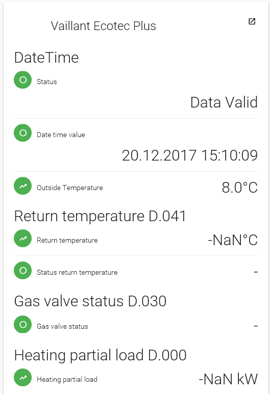

I’ve also implemented the ebus 2.0 (Alpha 15) binding with success. We use a Vaillant Ecotec plus heater a VR61 module, a VRC470 (HC2) and a VR80 (HC1) thermostate. I saw 5 ebus things appearing in the list : ebus bridge, ebus standard, ebus standard(8), ebus standard(15) and ebus standard(50).
Does it mean that address 50 is used for the VR61 module?
In the control tab of the paperUI i see a set of parameters, but not all the data is coming thru (NaN). I suppose the mapping is not correct? Do i need to adapt some settings in the config.json file?

I use the esera ebus ethernet interface, with the recommended settings: 2400/8/n/1, no flow control, serial data packing conditions: timer:0 size:0 char: 00
currently with my first steps i only check the broadcasts and don’t poll any values.
i can read the date/time and the outside temperature without any problems:
2018-01-13 20:01:15.987 [INFO ] [nding.ebus.handler.EBusBridgeHandler] - Received telegram from address 10 to FE with command controller.bc.datetime
2018-01-13 20:01:15.994 [INFO ] [hab.binding.ebus.handler.EBusHandler] - Handle received command by thing Vaillant VRC 430(f)/470(f) with id ebus:vrc430:a916041f ...
2018-01-13 20:01:16.031 [vent.ItemStateChangedEvent] - ebus_vrc430_a916041f_vrc430_controller_bc_datetime_datetime changed from 2018-01-13T19:59:16.528+0100 to 2018-01-13T20:01:16.986+0100
2018-01-13 20:27:24.973 [INFO ] [nding.ebus.handler.EBusBridgeHandler] - Received telegram from address 10 to FE with command controller.bc.temp_outside
2018-01-13 20:27:24.978 [INFO ] [hab.binding.ebus.handler.EBusHandler] - Handle received command by thing Vaillant VRC 430(f)/470(f) with id ebus:vrc430:a916041f ...
2018-01-13 20:27:25.007 [vent.ItemStateChangedEvent] - ebus_vrc430_a916041f_vrc430_controller_bc_temp_outside_temp_outside changed from 2.5625 to 2.75
but i’m getting a lot of errors all the time (failed ratio: 92%; unresolved ratio: 78%)
2018-01-13 19:59:25.323 [DEBUG] [nding.ebus.handler.EBusBridgeHandler] - eBUS telegram error; Received SYN byte while receiving telegram! [ERROR: INVALID_SYN, DATA: 10 76 B5 11 01 01 16 00 AA]
2018-01-13 19:59:25.868 [DEBUG] [nding.ebus.handler.EBusBridgeHandler] - eBUS telegram error; Received SYN byte while receiving telegram! [ERROR: INVALID_SYN, DATA: 10 08 B5 10 09 00 00 38 FF FF FF 06 00 00 19 00 AA]
2018-01-13 19:59:35.065 [DEBUG] [nding.ebus.handler.EBusBridgeHandler] - eBUS telegram error; Received SYN byte while receiving telegram! [ERROR: INVALID_SYN, DATA: 10 08 B5 11 01 01 89 00 AA]
2018-01-13 19:59:35.603 [DEBUG] [nding.ebus.handler.EBusBridgeHandler] - eBUS telegram error; Received SYN byte while receiving telegram! [ERROR: INVALID_SYN, DATA: 10 76 B5 12 03 0F 00 01 FC 00 AA]
2018-01-13 19:59:36.149 [DEBUG] [nding.ebus.handler.EBusBridgeHandler] - eBUS telegram error; Received SYN byte while receiving telegram! [ERROR: INVALID_SYN, DATA: 10 76 B5 10 09 00 00 00 FF FF FF 01 00 00 85 00 AA]
2018-01-13 19:59:45.388 [DEBUG] [nding.ebus.handler.EBusBridgeHandler] - eBUS telegram error; Received SYN byte while receiving telegram! [ERROR: INVALID_SYN, DATA: 10 76 B5 11 01 01 16 00 AA]
2018-01-13 19:59:45.933 [DEBUG] [nding.ebus.handler.EBusBridgeHandler] - eBUS telegram error; Received SYN byte while receiving telegram! [ERROR: INVALID_SYN, DATA: 10 08 B5 10 09 00 00 38 FF FF FF 06 00 00 19 00 AA]
now i’m struggeling since days to clean this errors maybe someone could help. :frowning:
