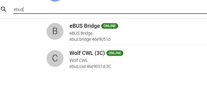

I have dropped your proposed config into json file and configured the bridge to pick it up.
I got the wolf-cwl thing in the inbox, which I accepted.

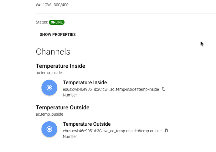

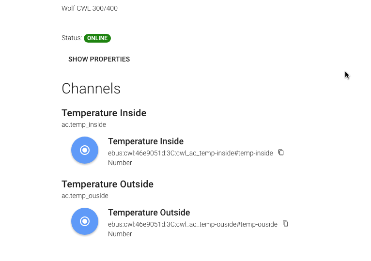

I created intems out of the thing channels.
Number   WolfCWL3C_CwlAcTempInsideTempInside   "Temperature Inside"    {channel="ebus:cwl:46e9051d:3C:cwl_ac_temp-inside#temp-inside"}
Number   WolfCWL3C_CwlAcTempOusideTempOuside   "Temperature Outside"   {channel="ebus:cwl:46e9051d:3C:cwl_ac_temp-ouside#temp-ouside"}
Though the channels do not deliver any value
What did I wrong?
You have to set up polling for getter commands if you haven’t allready.
PaperUI > Configuration > Things > Wolf CWL (3C) > Edit > SHOW MORE > Polling all channels
Works now,
