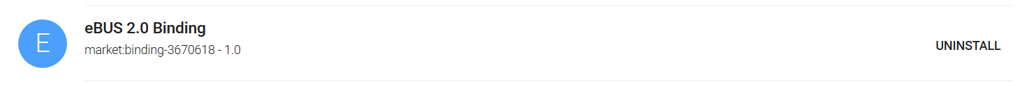

I’m also trying to install the ebus2.0 binding on my system 2.4.0-SNAPSHOT Build #1414. The add-ons/bindings page displays the following
But it’s not listed in the configuration/bindings page and also in the console. (binding:list)
Is it because of the snapshot built? Do have to go to a Release Candidate instead.
Please use the kar file from first post, the market place version is older and not working.
