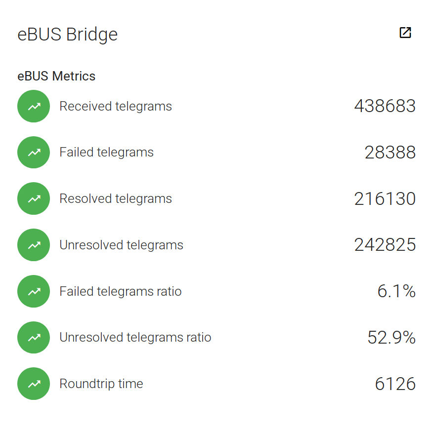

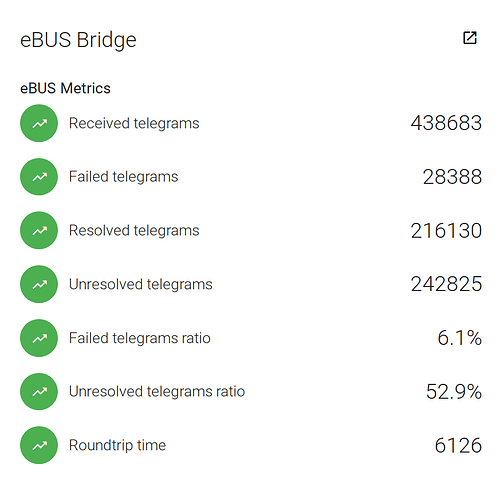

Below I attach small screenshot with statistics of my Vaillant ecoTec/calormatic 430. From most annoying parts - I can not read part load which is one of most interesting fields to have.
Cheers,
Łukasz
