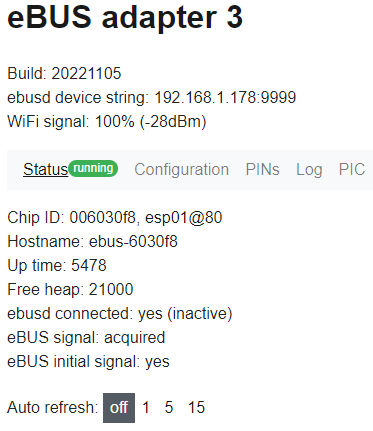

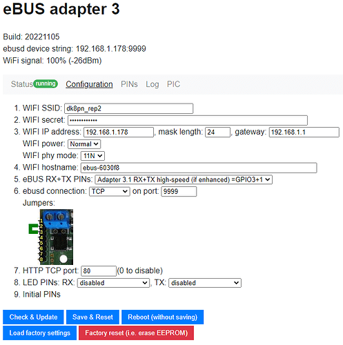

ok, problem found. Reason is in adapter v2.x
There is wrong value of the resistor. Now detected 7vaillant devices under OH3 and also under ebusd is detected all correctly.

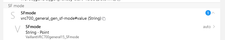

I have a question regarding eBUS binding and set a Vaillant mode. My question is, if it’s possible send a command to Vaillant unit to do a 1x hot water heating? Are you sending any commands ?
I have a channel in the VRC700 HWC thing, called “HWC SF mode”, which is writeable.
In the user interface, you will have the option “load” for the linked item. If you want to do it within a rule, you need to send a “6” (at least this works for me) to the linked item. “0” corresponds to auto, if you want to stop loading.
Good news for me.
First of all I want only test if it works, before I will make a rule.
If I will click on the auto, I can see auto, ventilation, party, veto and load …
How to test load “6” ?
In this interface, just click load. No worry about numbers in the UI. Only in the background, this will be a 6 sent to the channel/item.
Ok, will return back to auto when it’s finished ?
update : Tested, working. Thanks

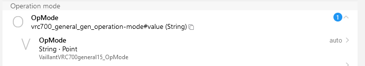

Is it possible that some values are there more than one time?
For me not clear this
Vaillant VRC700 General :
party/veto/load
and
auto/day/night/off

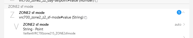

Vaillant VRC 700 zone 2 :
party/veto/load
and
auto/day/night/off

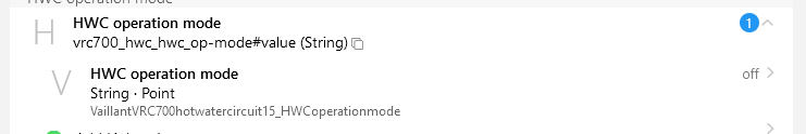

Vaillant VRC 700 hot water circuit:
party/veto/load
auto/day/night/off
For me all items with possible setup party/veto/load.. are the same function or ?

Can anybody provide me some detailed hints how to configure openhab and the “ebus adapter 3” (WiFi version) with ebusd?
Preconditions:
- openhab 3.4.0 on Windows10.
- Up to now my heatpump is connected to openhab via an ESERA LAN ebus coupler. Here everything works out.
- Setup the new adapter in parallel.
- Have ebusd for the adapter running as Docker container on Windows10.
- Adapter is adressable on WLAN. See screenshots below. Also tried “enhanced mode” (1-2).
Have tried to setup the adapter as bridge without any success. Thanks for support in advance.
