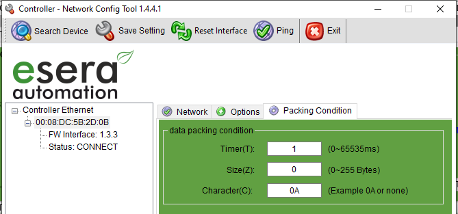

My issues which appeared or increased after the myVaillant app update (likely due to increased ebus traffic) are solved now. Missing heatpump parameters are present now and finally the very often occurring errors:
2022-12-14 15:17:31.338 [ERROR] [de.csdev.ebus.core.EBusQueue        ] - Send queue is full! The eBUS service will reset the queue to ensure proper operation.
are completey eliminated. The solution might probably help other users of the ESERA LAN ebus coupler as well.
Of an elementary importance is the “data packing condition” and there a setting of the timer (T) to at least 1ms instead of 0ms (default). Then this LAN coupler is by classes better than its image.

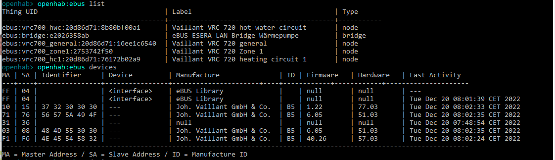

You may have to add things manually if scan doesn’t find something. It can take a while until values fill up with valid data.
You can use the following commands in the Karaf console to verify what has been identified:
