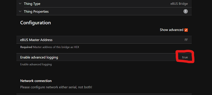

Hello, can somebody tell me what I have to do to get these both files?
ebus-resolved.csv
ebus-unresolved.csv
Since I have updatet Openhab to version 3.4 no files are created anymore.
I set log level to:
log:set DEBUG org.openhab.binding.ebus

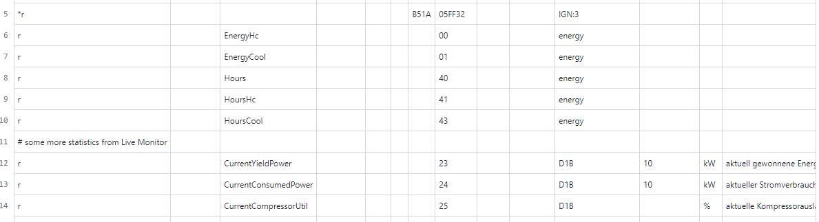

Ebusd telegram received:
hmu CurrentCompressorUtil = 3108b51a0405ff3225 / 0aff083862020000000000
The result is: 98%
The following data is from ebusd config file 15.700csv:
I assumed that ebusd data type “D1B” is for ebus “data1b”. Am not sure if this is right?
Thanks for your support in advance.
D1B is indeed data1b, but you can use type “char” as well, both are signed integers.

            "label":    "Current compressor utilization",
            "id":       "CurrentCompressorUtil",
            "command":  "B5 1A",
            "get": {
                "master": [
                    {"type": "static", "default": "05 FF 32 25"}
                "slave": [
                    {"type": "byte"}
                    {"type": "byte"}
                    {"type": "byte"}
                    {"name": "CurrentCompressorUtil", "type": "char", "label": "Current compressor utilization", "min": 0, "max": 100, "format":"%d"}
                    {"type": "byte"}
                    {"type": "byte"}
                    {"type": "byte"}
                    {"type": "byte"}
                    {"type": "byte"}
                    {"type": "byte"}
Edit: I filled up “bytes” for response length 8, however response length was 10 (0A), hence added two additional bytes at the end of the slave
I only had to add the missing commas. Everything else was perfect :smiley: :+1:. Many thanks for this and a happy new year.
