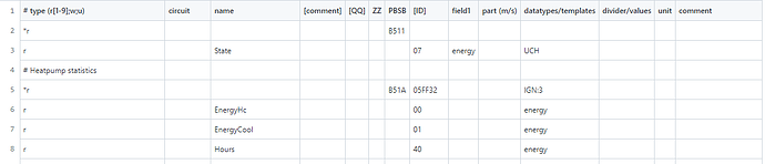

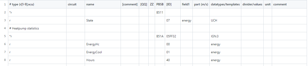

This results in 249 h instead of 19960 h and a am not able to figure out why? In ebusd the data type is “energy” but i don’t know what it should be in ebus. Thanks for your hints in advance.
You need a longer type like word instead of byte.
The column says “datatype/template”. In the Vaillant config folder of John30’s Github, you can find _template.csv explaining what datatype “energy” is: UIN.
So Openhab datatype is “word” (which is two bytes long) AND you have to add the “low byte first” by adding the following:
“reverseByteOrder”: true
And as it is two bytes long, you can skip one of the “byte” entries at the end :wink:

Hi Cor. Saw values of e.g. -41% today for the “CurrentCompressorUtil”. Would expect a range of 0
100%. Isn’t it the 3rd byte we are looking for (38 hex) instead of the fourth byte (62 hex) which we looked for initially? If i confugure it like this, i get +56% instead of -41%.
In ebusd i get the negative values as well ??? This lets me doubt. Initially i only checked if i get the same readings in openHAB as in ebusd and this was the case applying your solution.
If the forth byte (62 hex) is right, could it be the data type “data1c” instead of “data1b”? In John’s list D1B is signed integer which is dedicated for -127
+127 while D1C is unsigned integer which is for 0.0
100.0 (would match the desired percent range). If this is the case, John’s 08.hmu.csv would contain a failure for the “CurrentCompressorUtil”?
Hello Willibald. The csv file gives “IGN:3” meaning to ignore the first three bytes of the response. Also, 62 hex equalled 98 when converting it to signed integer (d1b), which was the utilization that you read from ebusd.
You also have the Vaillant app apparently (as you could compare the circulation pump status). The csv file screenshot shows the text “some more statistics from Live Monitor”. Are you able to compare your values with values that are given by a Vaillant controller, app or device?
Hi Willi and Cor,
Thanks for providing this. Works perfectly :slight_smile: , and I didn’t see any negative values for the compressor value so far.
Just as a note to others: I had to add the HMU thing manually after pointing the ebus binding to the .json file, choosing 08 as slave adress.
Cheers, Veit
@Chiuaua79 and @Veitk,
Understood what IGN:3 is now. Then everything seems to be okay. The myVaillant app doesn’t show such parameters. Will dig into the controller and see what i can get there. “Live Monitor” should be a menu point. In the meantime i observed “CurrentCompressorUtil” values between -105% and +122% while “off” is 0%. Interesting that Veit doesn’t see negative values. What type is your pump? I have an aroTherm VML105/6 heatpump.
I have an aroTherm VWL85/2 heatpump. Still no negative values since setting up the HMU thing.
@Veitk and @Chiuaua79 ,
Went through the “Live Monitor” of the controller in expert mode. Beside interesting other parameters like “compressor hours” or “compressor starts” i only found “compressor modulation”. While i saw the desired “CurrentCompressorUtil” at -76% the “compressor modulation” value was +27%.
For the moment i conclude that “CurrentCompressorUtil” is likely not a valid parameter of my heatpump type. If i figure out something new, i will let you know.
Edit:
Will see if i can grab telegrams using “ebusctl grab result decode” while i step through the desired compressor parameters within the Vaillant “Live Monitor”.
Made some progress. Have been able to grab telegrams using “ebusctl grab result decode” while i stepped through the desired compressor parameters within the Vaillant controller. Searched for the appropriate values then. This is at least valid for a Vaillant aroTherm VML105/6 (year 2020).
The value “CurrentCompressorUtil” from John30 is obviously not existing within the controller menu of my heatpump but i left it in the .json file for other users. It worked out at least for Veit (see above). Instead of “compressor utilization” i found “compressor modulation” which makes sense for a modulated inverter heatpump.
Edited on 10.01.2023.
