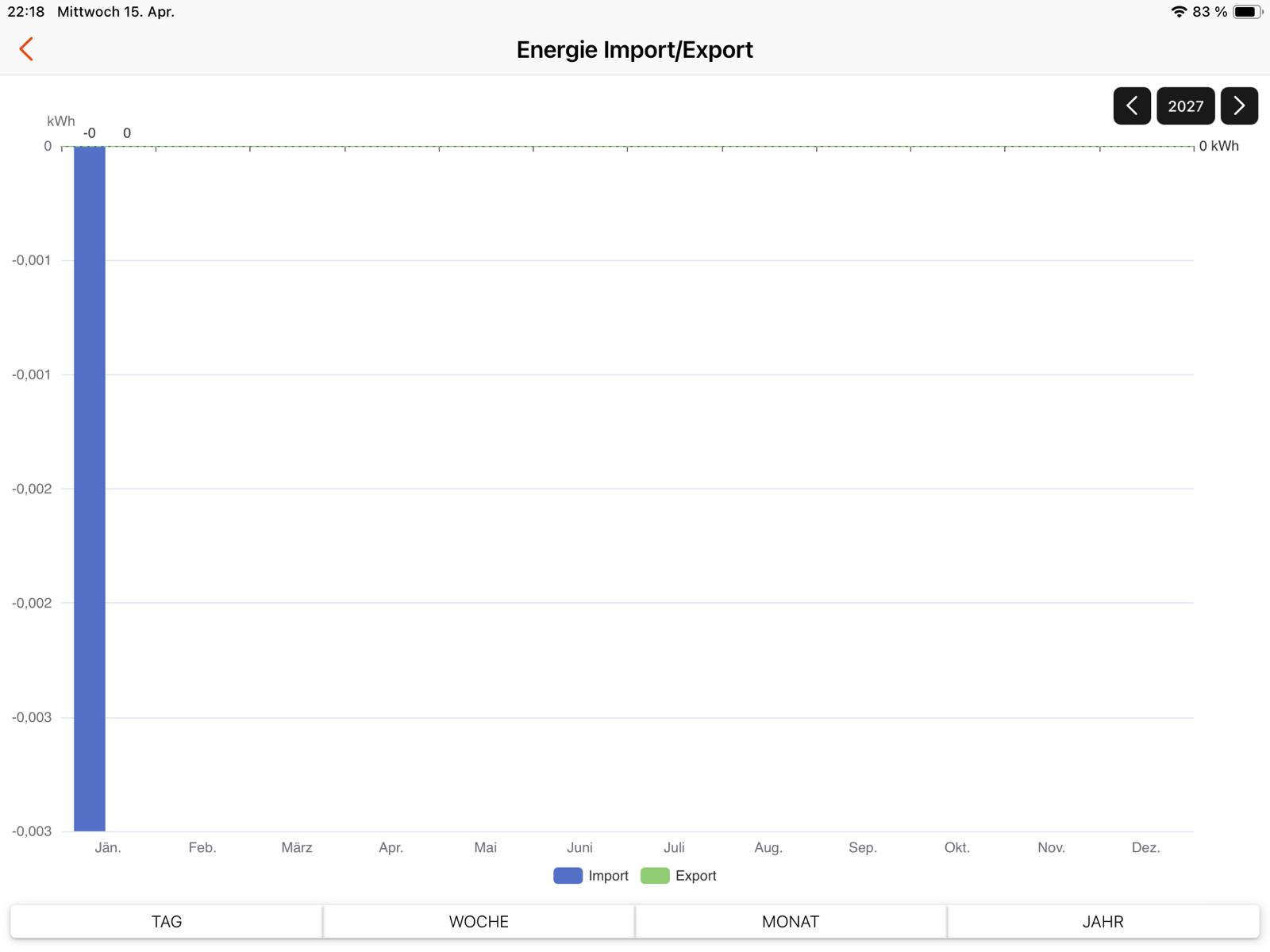

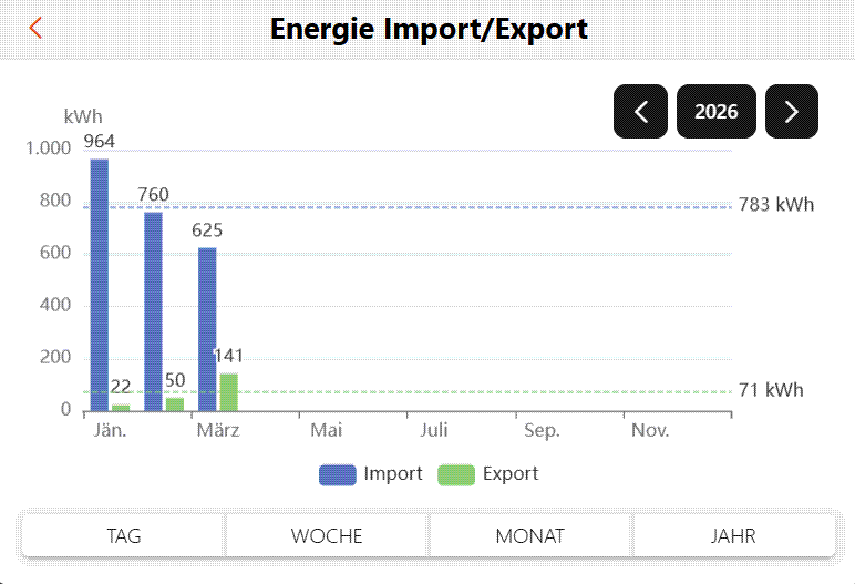

“years”:
  • start is 2026 - datepicker shows Jan 1st 2026, numbers look alright
  • arrow left: 2025 - datepicker shows Jan 1st 2025, numbers look alright
  • arrow left: 2024 - datepicker shows Jan 2nd 2025,no numbers in Jan, wrong numbers in Dec → pick other date e.g. Jan 1st or Jan 3rd → bars in Jan appear and Dec is updated
  • arrow left: 2023 - datepicker shows Jan 1st 2023, numbers look alright
  • arrow right: 2024 - datepicker shows Jan 1st 2024, numbers look alright
  • arrow right: still shows 2024 - datepicker shows Dec 31 2024, numbers are mostly 2025 (Jan and Dec not correct) → pick date in 2025 e.g. Jan 1st 2025 → year now shows 2025 and Jan/Dec are updated correctly
  • arrow right: 2026 - datepicker shows Jan 1st 2026, numbers look alright
chart_year_1

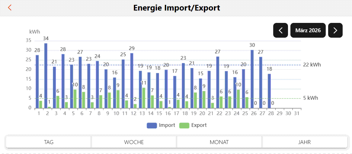

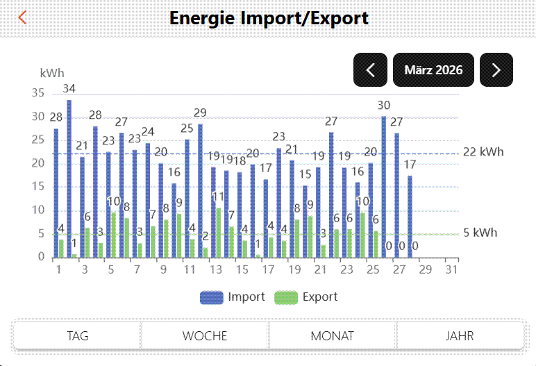

“months”:
  • start is March 2026 - datepicker shows March 1st 2026, numbers look alright
  • arrow left: shows Jan 2026 instead of Feb 2026 - datepicker shows Jan 29th 2026 with no data that day, however timeline stretches until “31st”, even though Feb just has 28 days
    → pick date in Feb e.g. Feb 1st 2026 → month now shows Feb 2026 with 28 days - numbers look alright.
  • arrow left: Jan 2026 - datepicker shows Jan 1st 2026, numbers look alright
  • arrow right: shows still Jan 2026 instead of Feb 2026 - data shown for 28 days with 29-31 empty - datepicker shows Jan 31th 2026
  • arrow right: March 2026 - no data March 1-3 - datepicker shows March 3rd
    → click datepicker → data for March 1-3 appear
chart_month_1

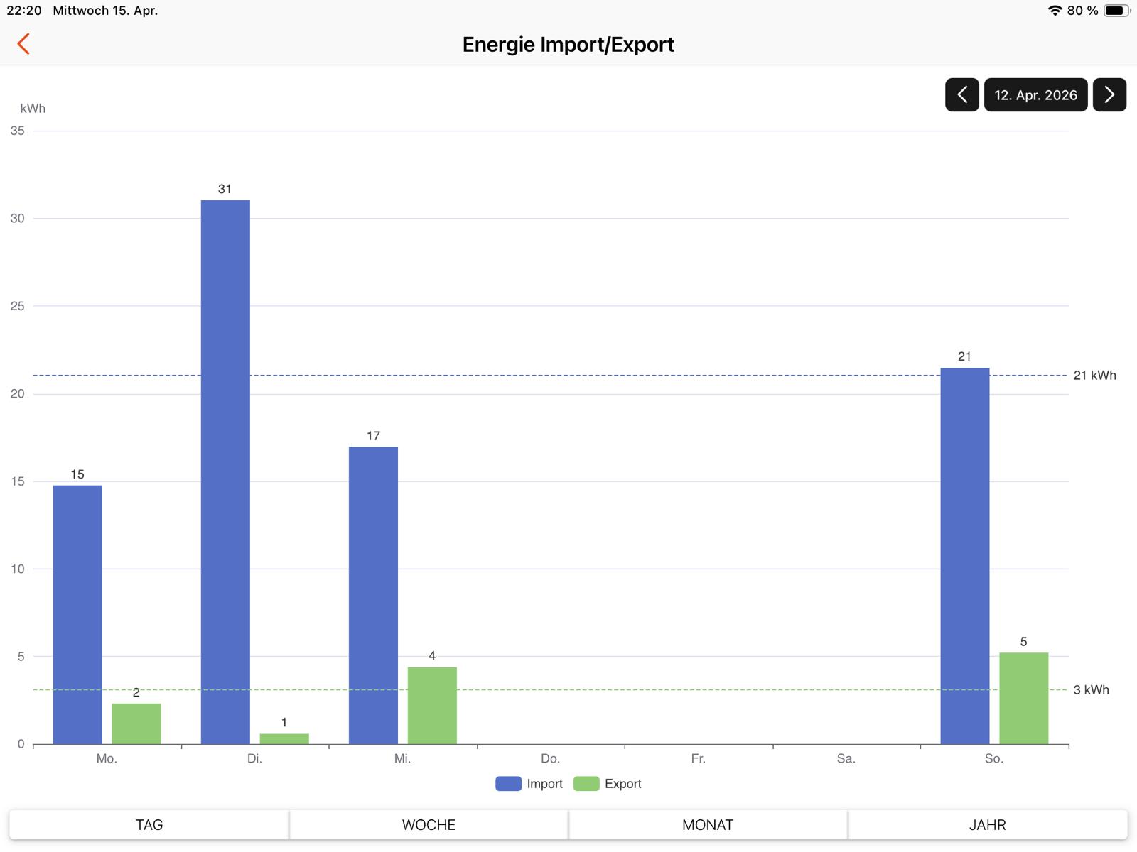

“weeks”:
I show the current week (ISOweek is Mon-Sun). Today is Sat Mar 28th → no data should be shown on Sunday, however the chart shows 27/6kWh.
Monday that week was 23rd March, however datepicker shows March 22nd, which was Sunday last week. In “month March 2026 it becomes obvious that 27/6kWh is from Sunday 22nd March.
chart_week_1

The following problems are still there:
Here you with the current weekly chart - the datepicker stated April 12 which was Sunday last week, however this week started with Mon April13. Datepicker should state 13.April 2026 and no bars should be shown on Sunday.

Whenever you select the next time window in the future - eg 2027 or Mai 2026 or next week or tomorrow, there is almost always a bar and if not a bar, there are “0” values e.g. in the first month, the first hour, etc.
Let me know in case you would want some more data.

Okay, I found a bug and created a fix, in my testing your chart widget’s month view now looks good:
Great news!
