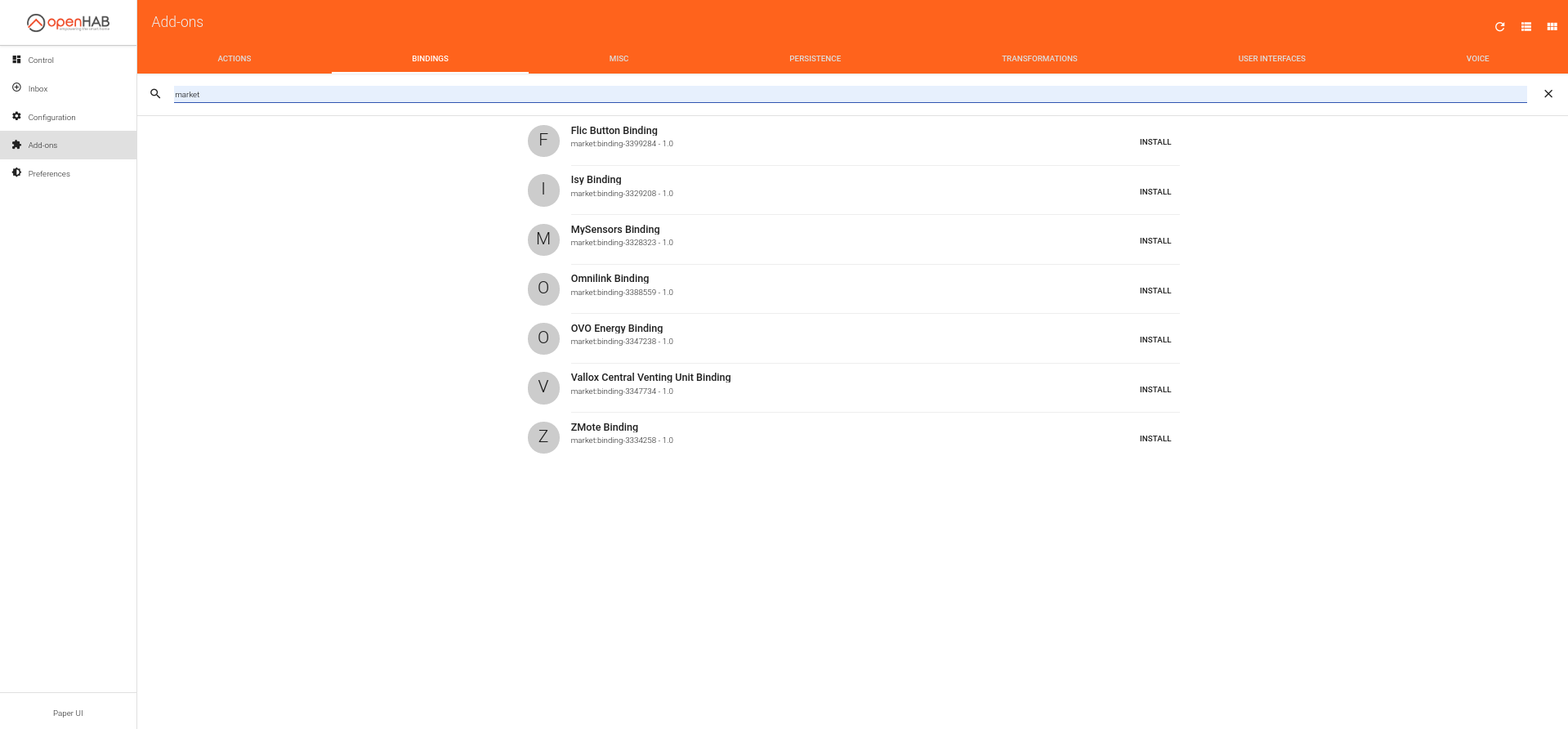

So far it has not recovered. I still see just the 7 bindings shown above. When I go to the marketplace link you mentioned https://marketplace.eclipse.org/taxonomy/term/4988%2C4396/title, I do see all the market bindings available for install from there but it gives me an error in PaperUI, I have never tried installing from there though so who knows if thats a browser issue or something to that effect. “error 400 - Bad Request” followed by “Extension installation from URL failed”.
Thanks @fifo,
I just installed a fresh 2.5.5 with the market add-on and can confirm that I only see very few bindings there:
Bildschirmfoto 2020-06-18 um 22.44.13
I don’t have time right now to go into debugging on it, but I will try to look into it before the 2.5.6 release. So yes, please file a bug and I’ll follow up on it!
