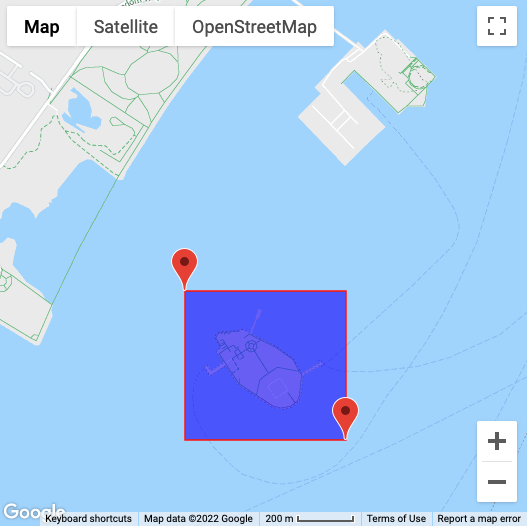

E.g. if you draw a rectangle geofence around liberty island in New York, I would do the following:
lat_min: 40.692397
lat_max: 40.687548
lon_min: -74.048557
lon_max: -74.041647
what would result into the following rectangular:
(source)
You can simple check if the provided lat & lon values are within the range (=someone is on or near the island) or not.
The only thing you need are < & > operators and the lat / lon definition of your rectangular geofence
