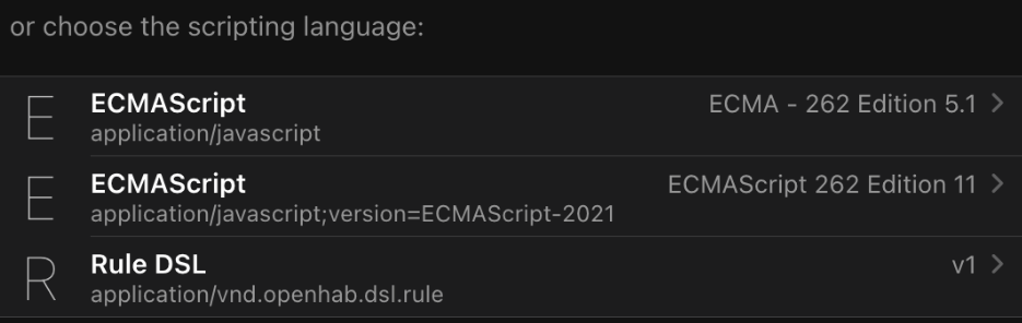

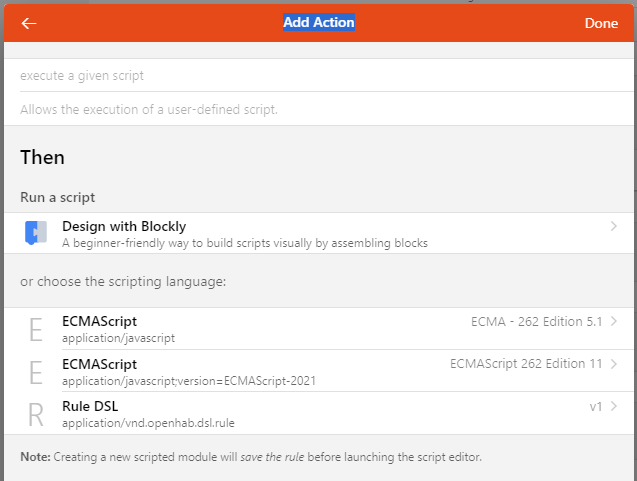

You can tell if you have the latest and greatest by looking in MainUI → Settings and if you see a JSScripting entry in the bottom right you have the latest, or at least a recent enough version to follow the rest of this tutorial.

  5. Change the “type” under the Script Action from “application/javascript” to “application/javascript;version=ECMAScript-2021”

I found this nice writeup through google when I ran into problems installing JSScripting because I could not get the ECMAScript 11 module to appear like it does in the documentation which I now learned to be outdated:
It’s really super duper mega convenient if you can leave all your scripts in the old Nashorn ECMA 5 and rewrite them one at a time to ECMA 11/JSScripting. Why was this changed?
-edit- As @hmerk pointed out, I was running 3.1.1 of the add-on, and this feature is available from 3.2.0.
I don’t understand your issue, just installed JS scripting and now it looks like
Just as in the docs…
You do understand my issue, it just doesn’t affect you. Are you running Stable or Beta?
I’m running the 3.2 stable and the plugin identifies itself as JSScripting 3.1.1.
openHAB 3.2 Release version
This is puzzling…
It is as if you’re experiencing the post-merge and I’m experiencing the pre-merge of the folowing:
when you install the JSScripting add-on all your Nashorn written rules will break. (…) Soon (hopefully in a matter of days) this will no longer be the case and the two can run side by side (PR has already been submitted, just waiting for review and merge).
Even though we’re running the same version.
You seem to have an older version installed
This is the one coming with the release build…
That must be it! Do you need to install it manually? I click settings > automation > + and there I see the following: oooh…you know what? My upgrade to 3.2 must have failed. I’m still running 3.1.1. The plugin version number should have been a hint, but I thought they were not in tandem.
My apologies for not investigating this more thoroughly. Thank you for that last comment, it made me see the light. :+1:t2:
No worries, glad we could sort it out :+1:
