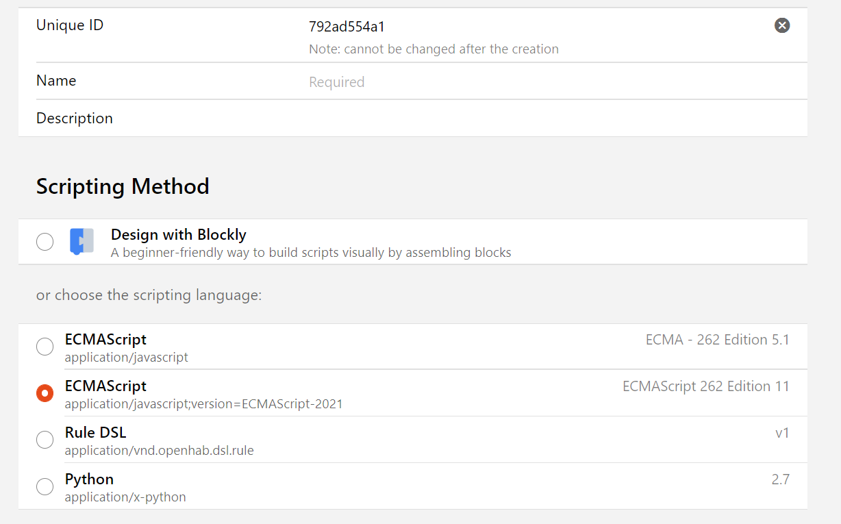

Ok. I was doing it this way at the very beginning. That was the point when I get this error:
Both try to make a script through UI or create it from file. Same result. If I get the same error, what should I check?
I guessed that Jhyton Scripting set up and new JSS Scripting have conflict, pls bear in mind that I use Ivan’s Helper Libraries: Ivan’s Helper Libraries - OH3, Python, JavaScript
The same error cannot happen if you create .js files because the concept on a Script Action really only exists in a UI rule.
That error is complaining about the JSON that makes up the rule. In specific, it’s complaining that you have a Script Action without a “script” element. It’s not even getting to the point where Jython or JSScripting comes into play.
That’s what I mean by the time being malformed.
If possible, it might be informative to see what’s in the code tab. And anything posted to the logs when you see that error in the UI is always useful.
Despite that error, can you get to the text editor and enter some code? Can you save the rule and come back to edit it?
Theoretically, not only can you have Jython and JSScripting in different rules at the same time, you can use it in the same rule.
So error was due to Script was empty. Now it has green idle status.
