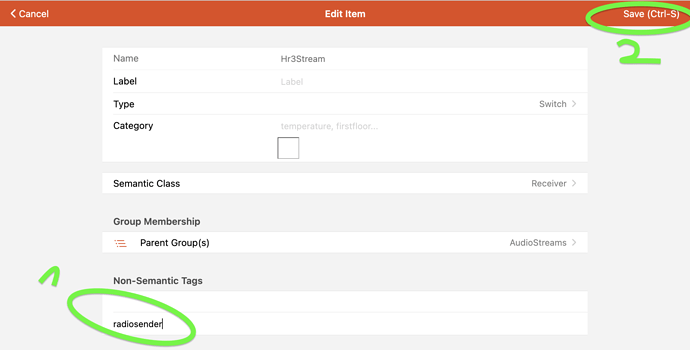

The reason why items.getItemsByTag() didnt return anything, was that my custom tag “radiosender” wasnt persisted.
Actually the items edit screen let you add tags, but after clicking on save they are not persisted (see screenshot below).
Edit: as noted below by @florian-h05 (many thanks!) I just missed pressing enter after entering the tag in the input box :blush:

Screenshot item edit:

Have you tried pressing enter after typing your tag name in to the field and then clicking save?
On my system it works that way.
Oh thanks again alot! Yes that works, I’ll update my post above with both aspects.
