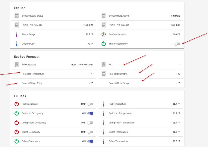

I setup the latest security key things two weeks ago after the Dec ecobee update.
I can pull some things(system status, etc); but some existing things seem to be failing:
Forecast0_Humidity
Forecast0_Condition
Forecast0_Temperature
Forecast0_HighTemperature
Forecast0_LowTemperature
Events_IsOccupied
Anyone having issues pulling this data in OH 2.5.10? Ironically i have an OLD OH too, like 2.1 and that still pulls this forecast data…it pulls that date as you can see from the forecast, but the rest nothing ever updates.
I’m getting all those values in my system (2.5.11).
First make sure you have an item linked to at least one of the weather channels (note there are only 2 weather channels - weather#timestamp and weather#weatherStation), the object should include all the weather forecast channels.
Assuming you have the above, you could put the binding in TRACE mode and you’ll see the JSON object returned by the API (the object is very big so don’t leave TRACE mode on for too long).
That helped for everything except one…relative humidity; it still is set to null; still seeing this in the log:
2021-01-07 07:43:18.516 [ERROR] [ui.internal.items.ItemUIRegistryImpl] - Cannot retrieve item ‘EcobeeThermostatMiltysbee_Forecast0_Humidity’ for widget org.eclipse.smarthome.model.sitemap.sitemap.Text
I’m not sure the Trace will help; I only really see “equipment” based things in the trace; no forecast data; which makes me thing the forecast is dumped once a day?

Well…it looks like it started working: Just checked it again and it populated. Not sure why everything else did when i updated the weather station stuff last night and only rel humidity took until today.
