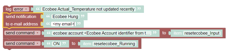

Based on my notes, I used the Main UI to navigate my Model until I found my Ecobee Thermostat and the Actual Temperature Point. I clicked on Add Metadata, selected ExpirationTimer, and set it to 3 hours - this seemed long enough to avoid false positives but short enough to recover from a hung Ecobee binding.
I created an Ecobee Hung rule triggered whenever the Actual_Temperature was updated to UNDEF (no updates are received in three hours). The rule ran the following Blockly script where the Ecobee Account identifier came from the Ecobee Account Thing.
I created the following Linux resetecobee.sh script and made it executable:
#!/bin/sh
echo "Attempting restart" | /usr/bin/mail -s "OpenHAB Ecobee appears to be hung" "<my email>"
/usr/bin/openhab-cli console -p <password> openhab:things disable "$@"
sleep 5
/usr/bin/openhab-cli console -p <password> openhab:things enable "$@"
I added /home/openhabian/resetecobee.sh %2$s to /etc/openhab/misc/exec.whitelist
I ran the rule manually and monitored what happened in the event log.
