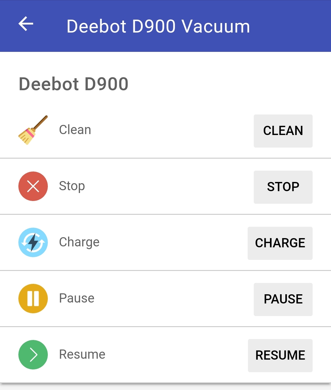

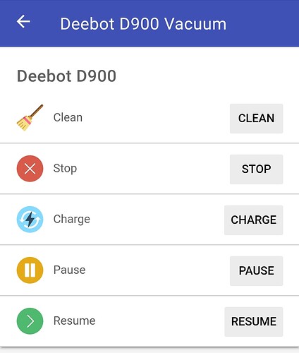

9. Make it nice
Find yourself some nice icons and you can also add other commands like STOP, PAUSE, RESUME, etc. with this method.

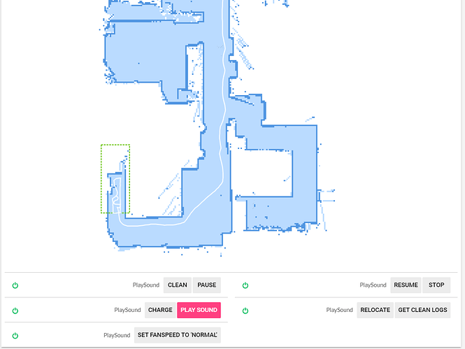

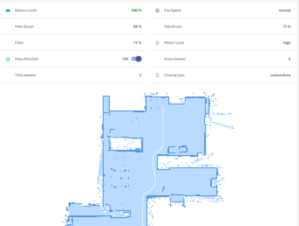

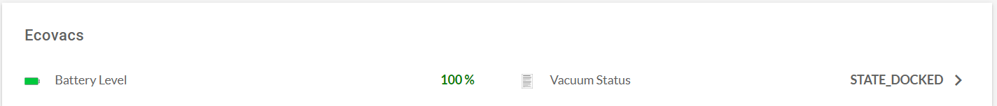

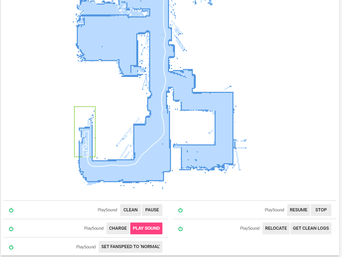

Yesterday I managed to hook up my Ecovacs with this MQTT based Repository.
Florine developed the mqtt based integration with Openhab . It works like charm.
He updated the report with OPenhab config files.
Screenshot for my system :
