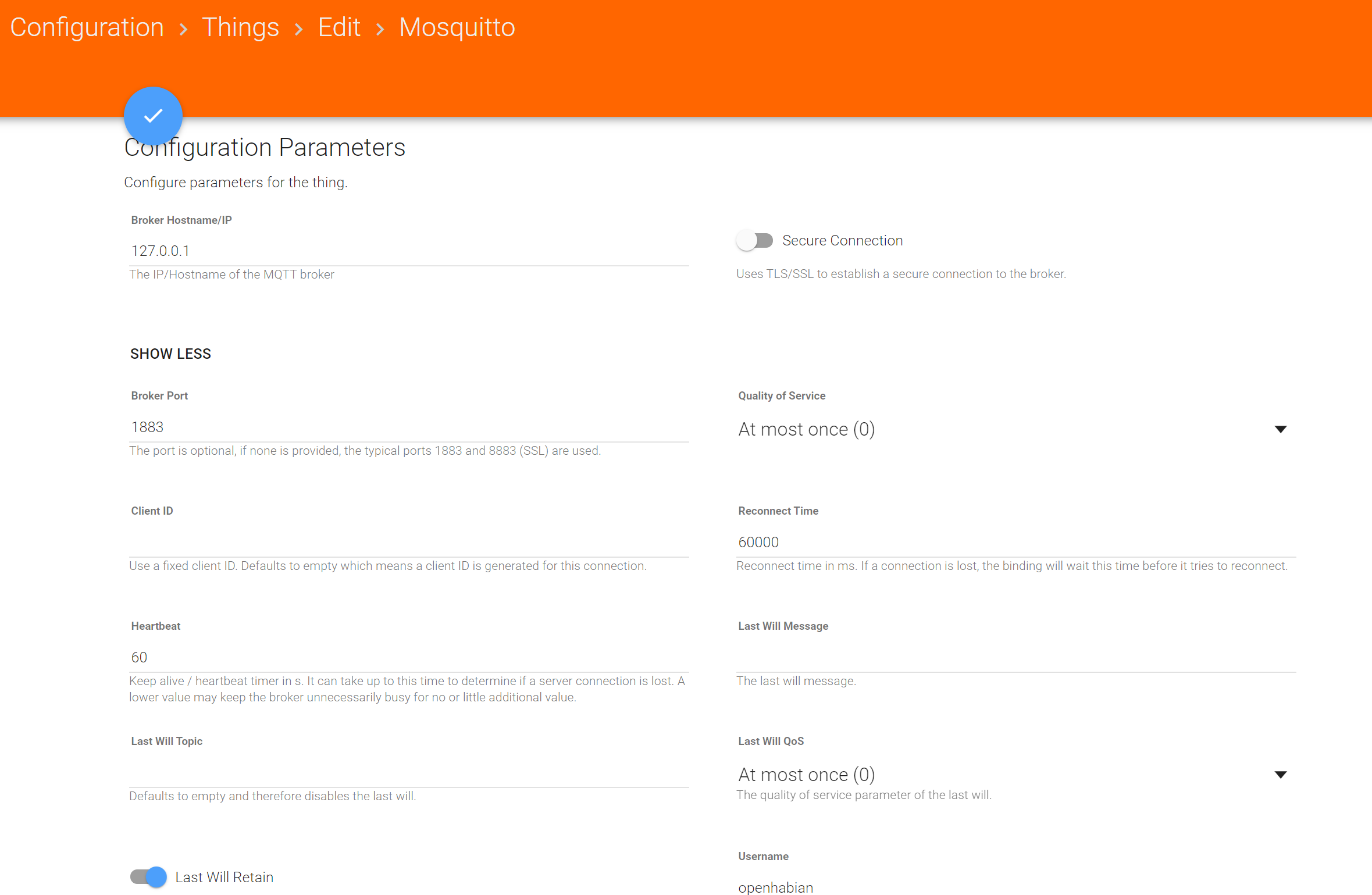

Also, I setup the MQTT broker but unsure if it is working? If you know, is the below correct?
  1. in SSH installed Mosquitto using the optional components
  2. In PaperUI, installed the MQTT broker binding
  3. Adding config for the server in the services/mqtt.cfg file
  4. Added a MQTT broker thing with the same server details as the mqtt.cfg file. The thing is now online.
Am I correct?
Thanks again for your time
Is the environment still active when you type ‘python main.py’?
This needs to be active so python knows where to find the module ‘deebotozmo’.
Just like before type in the folder where the ‘env’ folder is ‘source env/bin/activate/’ and afterwards ‘python main.py’
I think the broker should work, but I’m unsure since I use a seperate Moquitto instance and only use the bridge like in my example things file.

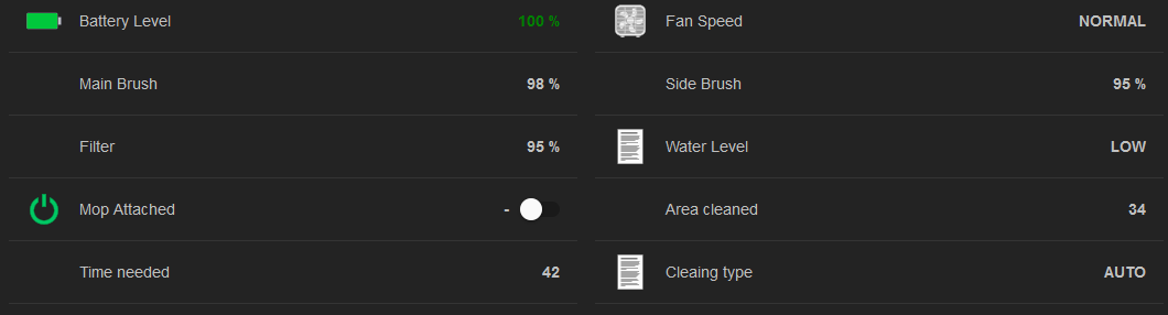

I just published a new version which also handles status updates when you trigger it with the button on the bot.
Hey, thanks for all your patience and help. I have installed your latest files. Do you mean you can read the status of the deebot in your latest update?
Adding the variables directly into the main.py seemed to do the trick. I am getting at least some sense now and must be close. See below my output:

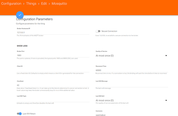

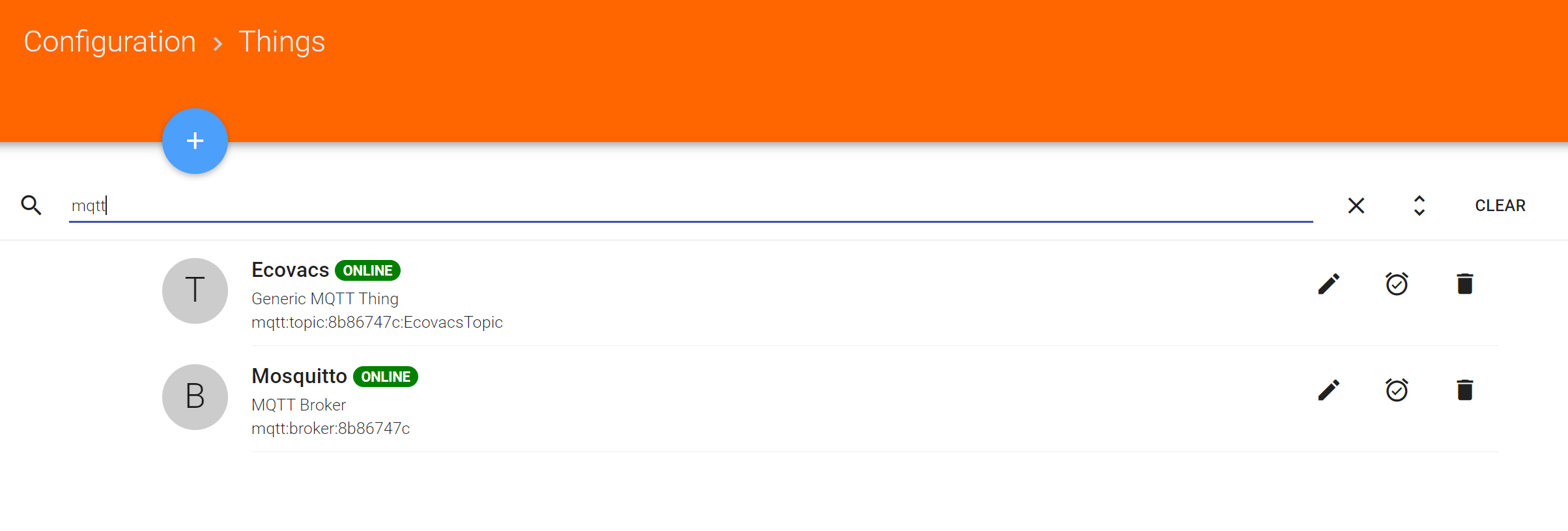

  1. I added the things file into the folder and changed the broker details to the one already in paperUI. I also changed the device ID to that in the cmd when running “python main.py”.
  2. I added the items to the items file but they are duplicated as I already linked them in the things with channels. Easily solved as I can remove one set.
No data being displayed in openHAB…
Any ideas please FloSchl?

I remember I had some difficulties at first too to get the values to display in OH.
First check if all your MQTT broker values are correct.

Both are online in my paperUI as seen in image:

I have ensured the broker thing matches the thing already added in paperui. See details:
Yet nothing displayed in HABPanel under the items or basicUI sitemap, any further ideas?
