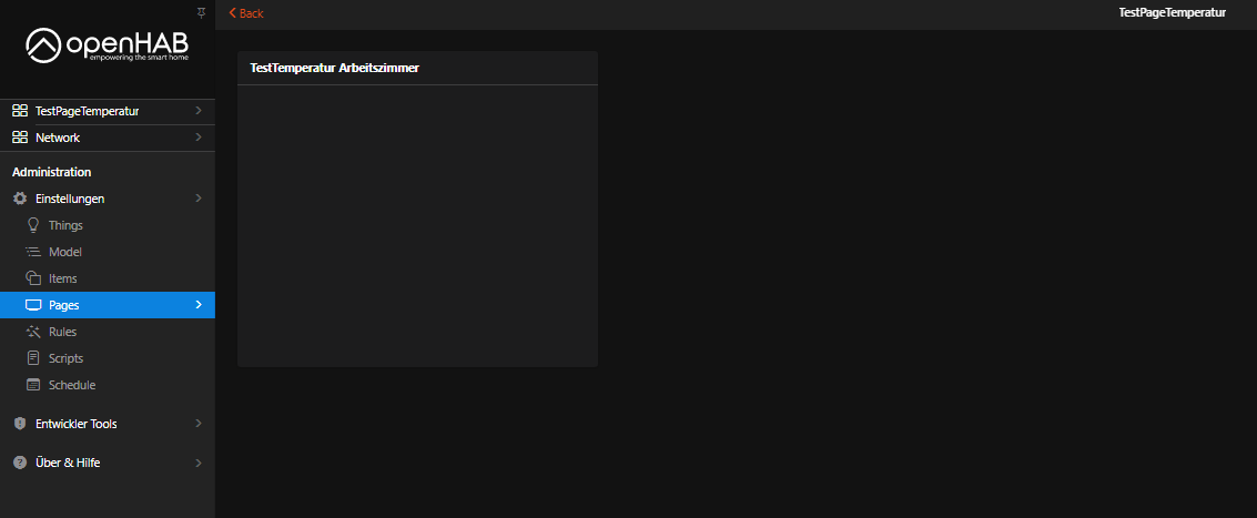

But i’m not able to embed to a graph in a Openhab Page, the web frame card remains blank.

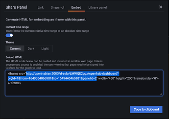

I tried this URL:
and also this:
http://openhabian:3000/d-solo/LMWQE2ggz/openhab-dashboard?orgId=1&from=1649354066981&to=1649440466981&panelId=2

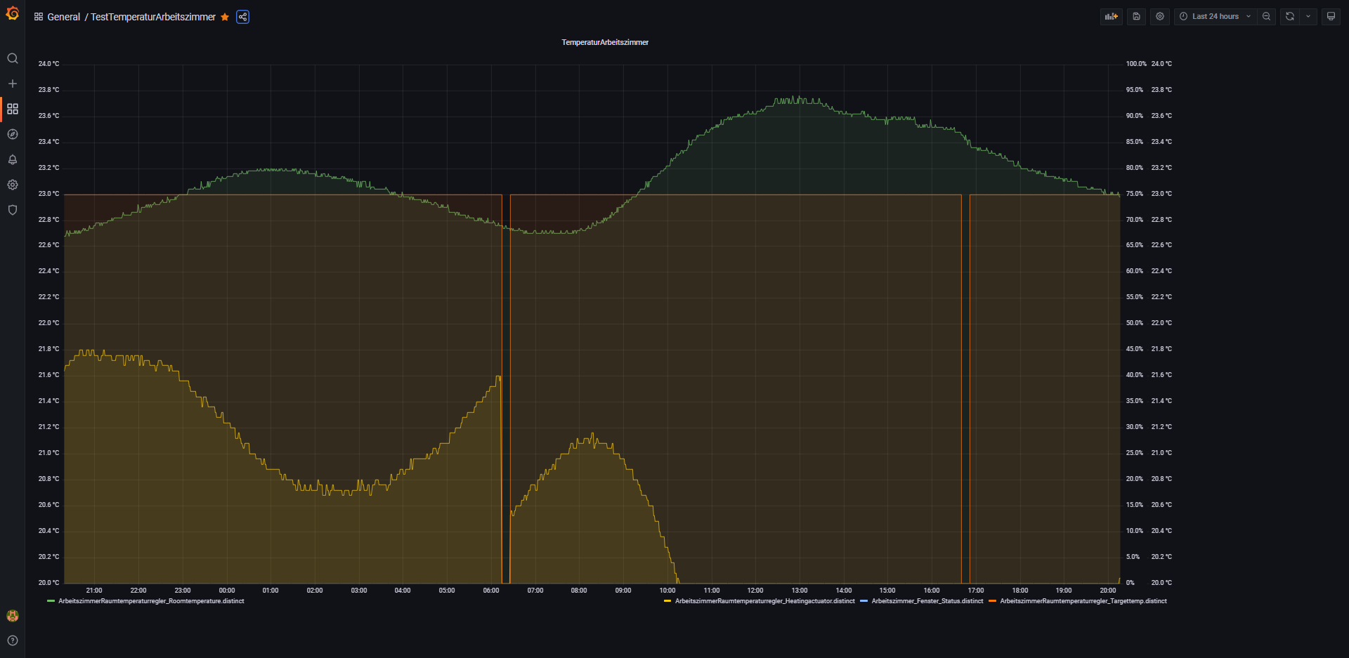

I configured a grafana with influxdb and i’ve a designed a graph.
So far so good.
[image]

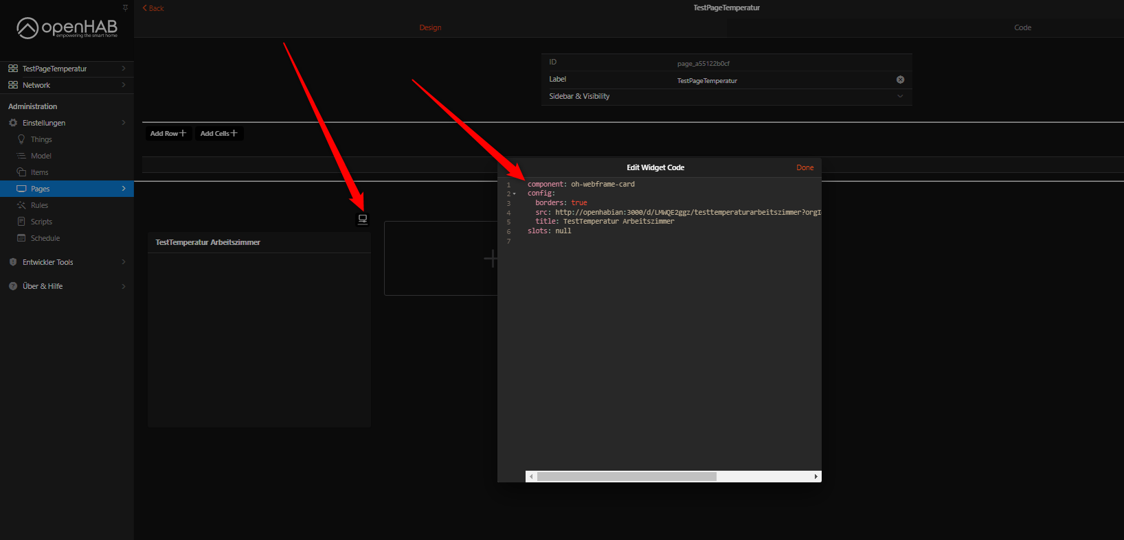

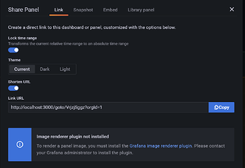

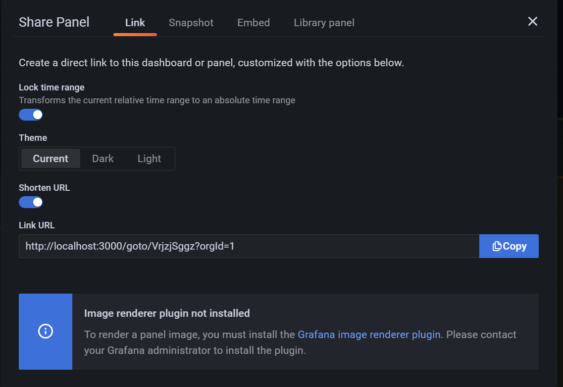

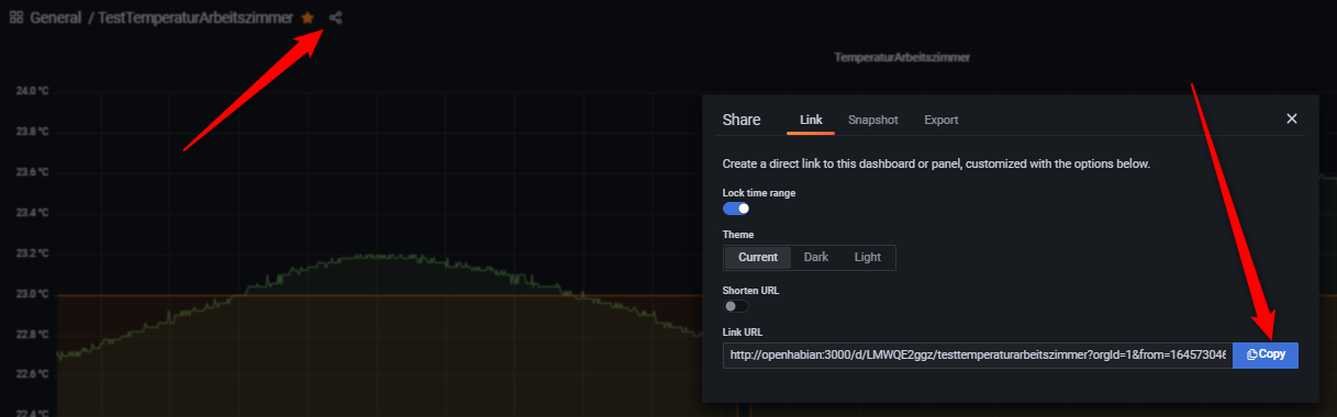

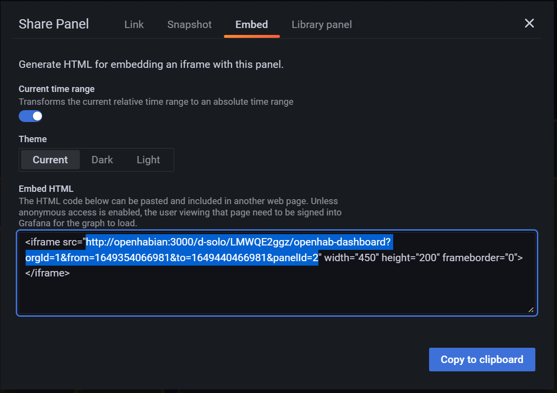

But now I want to display this graph in openhab. So at first I used the share function within Grafana:
[image]

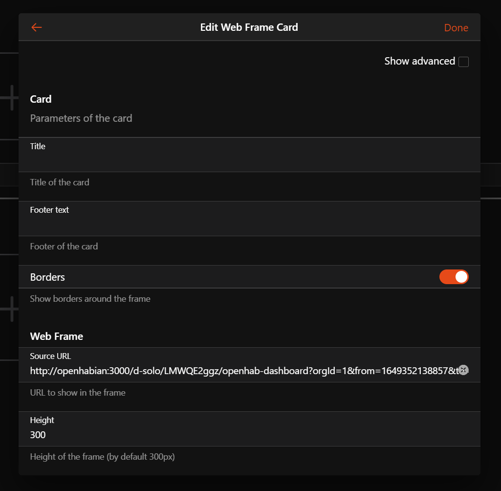

Afterwards i created a page with a webfram and I inserted a webframe with the URL of the graph.
[image]
But openhab doesn’t load the graph.
[image]

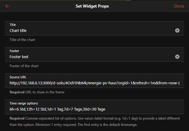

With great support by @BobMiles , @RGroll and @ysc I managed to create a widget to embed grafana charts with configurable time ranges.
If interested, you can find the whole discussion here .
[Grafana chart widget]
[Grafana widget props]
Source URL:
Make sure you insert {period} inside the URL where you would want to have the time range pasted.
Example:
http://192.168.0.13:3000/d-solo/4OdYJNbMk/energie-pv-haus?orgId=1&refresh=1m&from=now-{period}&to=now&panelId=2
