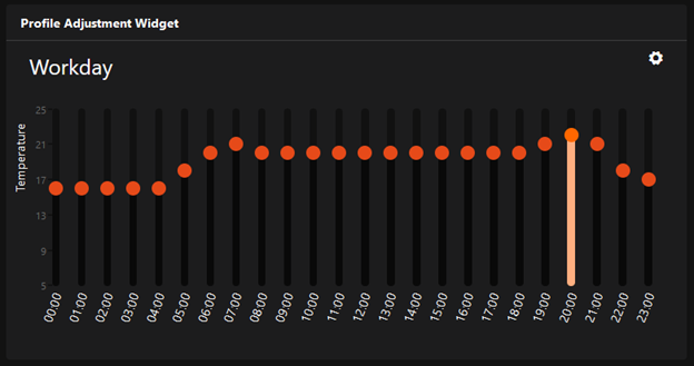

Profile Control: Widgets
There are two main widgets that sit at the core of profile adjustment, and a popup for data entry. These are:
  • profile_looper: this allows the adjustment of profiles via sliders
  • profile_looper_popup: this allows users to configure profiles to their liking
  • profile_graph: this displays a graphical representation of a single profile
Basically, a user can first choose an unused profile (empty templates are easy to create via copy-paste) and then they can configure it using the profile_looper widget. This has a simple slider for each time period, and depending on what type it is set to, will allow the user to enter appropriate values. Additionally, by clicking on the gear-icon, profile_looper_popup is shown, which allows the user to do things like change the name, type, and interpolation setting (when active, this interpolates values between, useful for lighting).

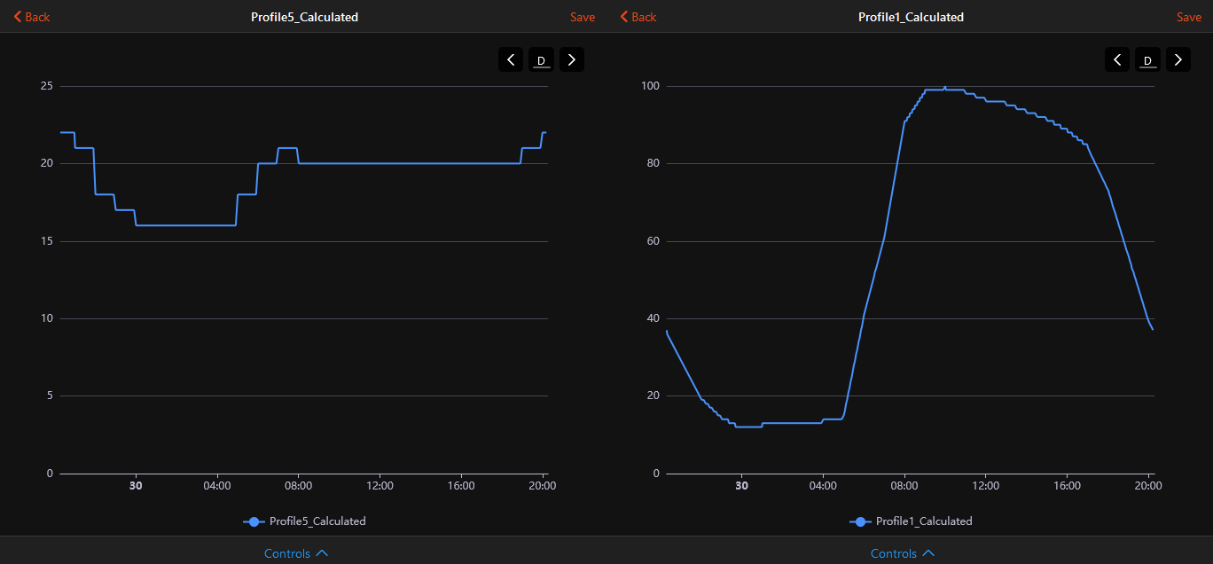

Profile Control: Results
The Profile system results in a calculated value which sits in the profile’s accompanying _Calculated item and can, from there, be easily fetched by any other rule, light, thermostat, etc. Below are two examples of this calculated value: on the left, Profile 5 “Workday” is shown and on the right a light-brightness profile is shown which includes interpolation for smooth transitions throughout the day.
The profile calculator also calculates some extra values, like the minimmum and maximum values within a specific profile (which will be useful later) and has the ability to reset and revert the profiles to hard-coded values in the rules file should one wish to do so.
The biggest issue with this system that I’ve come across is that OpenHab gets a bit weak in the knees when opening multiple instances of the profile_looper widget, so much so that opening all 10 configurateable profiles usually “'breaks” the tab of the browser its in. Values can still be adjusted and everything works on that page, however the rest of mainUI in that tab is completly borked and to regain usability, I need to kill the tab and open mainUI again. This can be avoided by only viewing one profile at a time.
Also, it is important to include restoreOnStartup persistence for all profile items! Since many of the items that make this system work are not numbers, I use mapdb to keep all these values. If they are not persisted, your profiles will not survive a restart of OH.

YAML Widgets
profile_looper
uid: profile_looper
props:
  parameters:
    - description: Title on top
      label: Title
      required: false
      type: TEXT
    - context: item
      description: Profile
      label: profile core item
      required: true
      type: TEXT
      filterCriteria:
        - value: Group
  parameterGroups: []
timestamp: Dec 22, 2022, 4:26:06 PM
component: f7-card
  style:
    --f7-range-bar-active-bg-color: "#090909"
    --f7-range-bar-bg-color: "#111111"
    --f7-range-bar-border-radius: 1em
    --f7-range-bar-size: 0.6em
    height: 400px
    position: relative
    width: 100%
  title: Profile Adjustment Widget
  default:
    - component: f7-block
        default:
          - component: f7-row
              default:
                - component: Label
                    style:
                      font-size: 18pt
                      padding: 10px
                    text: =items[props.profilecore + "_Name"].state
                - component: oh-button
                    action: popup
                    actionModal: widget:profile_looper_popup
                    actionModalConfig:
                      profile: =props.profilecore
                      title: =props.title
                    color: white
                    iconF7: gear_alt_fill
                    large: true
        style:
          display: flex
          flex-direction: row
          height: 100%
          left: 30px
          top: 20px
          width: 95%
        default:
          - component: oh-repeater
              filter: loop.item.type == "Number"
              for: item
              fragment: true
              groupItem: =props.profilecore + '_val'
              sourceType: itemsInGroup
              default:
                - component: f7-col
                    style:
                      height: 200px
                      width: 100%
                    default:
                      - component: f7-row
                          visible: "=(items[props.profilecore + '_Type'].state == 'Percentage') ? true : false"
                          default:
                            - component: oh-slider
                                item: =loop.item.name
                                label: true
                                max: 100
                                min: 0
                                scale: "=(loop.item.label == '00') ? true : false"
                                scaleSteps: 4
                                step: 1
                                style:
                                  --f7-range-bar-active-bg-color: "=(dayjs().format('HH') == loop.item.label) ? '#FFAF80' : '' "
                                  --f7-range-knob-color: "=(dayjs().format('HH') == loop.item.label) ? '#FF6700' : '' "
                                  height: 200px
                                title: =loop.item.label
                                vertical: 1
                      - component: f7-row
                          visible: "=(items[props.profilecore + '_Type'].state == 'Temperature') ? true : false"
                          default:
                                label: true
                                max: 25
                                min: 5
                                releaseOnly: true
                                scaleSteps: 5
                                step: 0.5
                                style:
                                  height: 200px
                                vertical: 1
                      - component: f7-row
                          visible: "=(items[props.profilecore + '_Type'].state == 'Boolean') ? true : false"
                          default:
                                label: true
                                max: 1
                                min: 0
                                scaleSteps: 1
                                step: 1
                                style:
                                  height: 200px
                                vertical: 1
                      - component: f7-row
                          default:
                            - component: Label
                                style:
                                  position: relative
                                  top: 30px
                                  transform: rotate(-70deg)
                                  width: 1px
                                text: =loop.item.label + ":00"
                                visible: true
    - component: Label
        style:
          height: 1px
          left: 5px
          position: absolute
          top: 210px
          transform: rotate(-90deg)
          width: 1px
        text: =items[props.profilecore + "_Type"].state

    Member of ProfileSlider received command
    var root_profile_groupname = triggeringItem.name.split('_').get(0)
    var root_group1 = ScriptServiceUtil.getItemRegistry.getItem(root_profile_groupname) as GroupItem
    var root_group = ScriptServiceUtil.getItemRegistry.getItem(root_group1.name + "_val") as GroupItem
    var foundMaxValue = 0
    var foundMinValue = 100
    //Check the ranges on all the sliders
    for(var c = 0; c < 24; c = c + 1 ){
        var slideritem = ScriptServiceUtil.getItemRegistry.getItem(root_profile_groupname + "_" + c) as GenericItem
        if(triggeringItem.state.toString == "Percentage"){
            if(slideritem.state > 100 || slideritem.state < 0 ){
                slideritem.sendCommand(0)
        if(triggeringItem.state.toString == "Temperature"){
            if(slideritem.state > 25 || slideritem.state < 5 ){
                slideritem.sendCommand(5)
        if(triggeringItem.state.toString == "Boolean"){
            if(slideritem.state > 1 || slideritem.state < 0 ){
        if(slideritem.state > foundMaxValue){
            foundMaxValue = slideritem.state
        if(slideritem.state < foundMinValue){
            foundMinValue = slideritem.state
    logInfo("Profile Calculator","Min value: " + foundMinValue)
    logInfo("Profile Calculator","Max value: " + foundMaxValue)
    ScriptServiceUtil.getItemRegistry.getItem(root_profile_groupname + "_MinValue").postUpdate(foundMinValue)
    ScriptServiceUtil.getItemRegistry.getItem(root_profile_groupname + "_MaxValue").postUpdate(foundMaxValue)

rule "Profile Calculator - Calculate current value"
    Time cron "0 0/1 * * * ?"
    if(SystemReady.state != ON){
        logError("System Startup Catch", "Rule execution blocked -- Persistent variables not yet loaded!")
    }else{
        //Get the current time and put into two handy variables
        var curn_interval = (now.getHour()).intValue
        var next_interval = curn_interval + 1
        if(next_interval == 24) { next_interval = 0}
        var profilecounter = 0
        //logInfo("Profile Calculator", "Running Profile update cycle, it is currently interval " + curn_interval + " and the next interval is " + next_interval + ".")
        ProfileList.members.forEach[ root_profile |
            //logInfo("Profile Calculator", "Updating " + root_profile.name)
            profilecounter = profilecounter + 1
            var group_item = root_profile as GroupItem
            //check to see if it exists, if not, generate it!
            if(ScriptServiceUtil.getItemRegistry.getItem(group_item.name + "_Name").state == NULL){
                ScriptServiceUtil.getItemRegistry.getItem(group_item.name + "_Command").sendCommand("RESET")
                //Wait for it to generate
                Thread::sleep(1000)
            //Check for interpolation
            if(ScriptServiceUtil.getItemRegistry.getItem(group_item.name + "_Interpolate").state == OFF){
                //No interpolation. Direct transfer OK
                var slidergroup = ScriptServiceUtil.getItemRegistry.getItem(group_item.name + "_val") as GroupItem
                var slideritem  = ScriptServiceUtil.getItemRegistry.getItem(group_item.name + "_" + curn_interval ) as NumberItem
                var targetitem  = ScriptServiceUtil.getItemRegistry.getItem(group_item.name + "_Calculated") as NumberItem
                targetitem.postUpdate( slideritem.state as Number)
            }else{
                //Interpolation required. Do some math first.
                var slideritem_now  = ScriptServiceUtil.getItemRegistry.getItem(group_item.name + "_" + curn_interval ) as NumberItem
                var slideritem_nxt  = ScriptServiceUtil.getItemRegistry.getItem(group_item.name + "_" + next_interval ) as NumberItem
                var Number interpolatedvalue = slideritem_now.state as Number + ((now.getMinute() / 60.0 ) * (slideritem_nxt.state as Number - slideritem_now.state as Number))
                targetitem.postUpdate( interpolatedvalue.intValue )
        logInfo("Profile Calculator", "Successfully Updated " + profilecounter + " profiles!")
