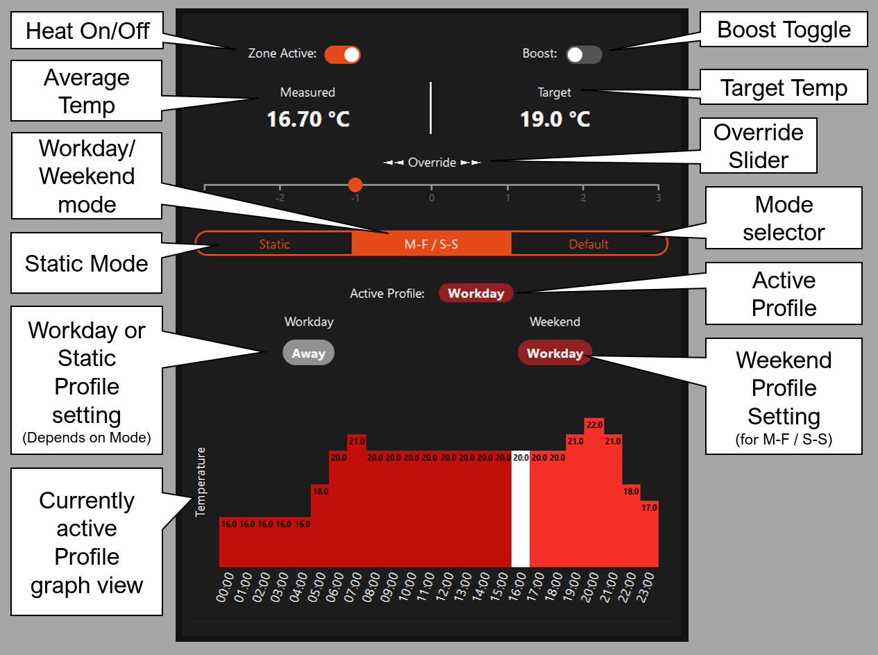

The Widget
Demo Video

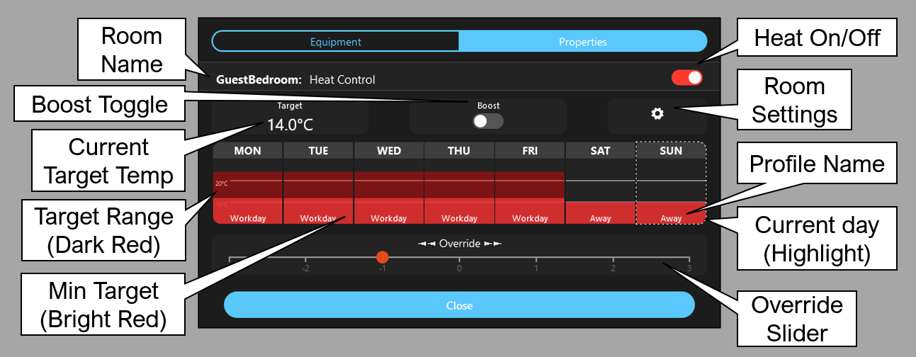

Main Widget
This widget is what the user sees in the MainUI when visiting the “Properties” tab of a location-card. Here the user can see the currently targeted temperature, and if they wish, enable the temporary “boost” or tweak the setting using the override slider. Additionally, the user can see on the weekly calendar what profiles will be active on which days of the week, and the temperature range that they travel is shown by the differently colored red highlighting on the graph. Should the user wish to change the profile, the settings button opens up the settings widget, as shown below.
Settings Widget
The Settings widget enables the user to fine-tune the control over the room’s thermostat control. Here, different Modes can be selected which determine the Profile choice of each weekday. “Static” mode will simply always use the primary Profile each day, while setting the zone to “M-F / S-S” allows a secondary Profile to be set that is used on weekends. Finally, the “Default” mode is currently unused as to leave space for future development and features should the need arise.

Main Widget
uid: temperature_control_v2
tags: []
props:
  parameters:
    - context: item
      description: Heating zone to pattern
      label: Item
      required: false
      type: TEXT
  parameterGroups: []
timestamp: Dec 22, 2022, 4:27:12 PM

Popup Widget
uid: temperature_control_v1_popup
tags: []
props:
  parameters:
    - context: item
      description: The master item for the heating zone
      label: Master_Heating_Switch item
      required: false
      type: TEXT
  parameterGroups: []
timestamp: Dec 22, 2022, 4:32:40 PM
component: f7-card
  style:
    text-align: center
  text: "='Thermostat Control: ' + props.root_item.split('_')[0]"

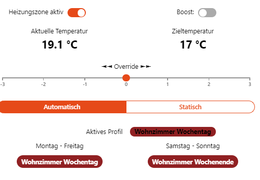

                text-align: center
                width: 100%
              default:
                - component: f7-col
                    default:
                      - component: Label
                          style:
                            text-align: right
                          text: "Active Profile:"
                - component: f7-col
                    default:
                      - component: f7-row
                          default:
                            - component: Label
                                style:
                                  background-color: "=( items[props.root_item.split('_')[0] + '_Heating_AutomationProfileActive'].state == 'Away' ? '#919191' : ( items[props.root_item.split('_')[0] + '_Heating_AutomationProfileActive'].state == 'Frostguard' ? '#00ACB5' : ( items[props.root_item.split('_')[0] + '_Heating_AutomationProfileActive'].state == 'Present' ? '#008c09' : '#902022')))"
                                  border-radius: 10px
                                  font-weight: bold
                                  padding: 0px 10px 0px 10px
                                text: =items[props.root_item.split('_')[0] + '_Heating_AutomationProfileActive'].state
          - component: f7-row
              style:
                margin-bottom: 10px
                margin-top: 10px
              default:
                - component: f7-col
                    style:
                      text-align: center
                      width: 50%
                    default:
                      - component: f7-row
                          default:
                            - component: Label
                                style:
                                  width: 100%
                                text: Workday
                      - component: f7-row
                          style:
                            justify-content: center
                            margin-top: 10px
                            padding: 0px 20px 0px 20px
                            text-align: center
                          default:
                            - component: oh-button
                                action: popup
                                actionModal: widget:temperature_control_v1_profilepopup
                                actionModalConfig:
                                  item: =props.root_item.split('_')[0] + '_Heating_AutomationProfilePrimary'
                                fill: true
                                round: true
                                style:
                                  background-color: "=( items[props.root_item.split('_')[0] + '_Heating_AutomationProfilePrimary'].state == 'Away' ? '#919191' : ( items[props.root_item.split('_')[0] + '_Heating_AutomationProfilePrimary'].state == 'Frostguard' ? '#00ACB5' : '#902022'))"
                                  font-weight: bold
                                text: =items[props.root_item.split('_')[0] + '_Heating_AutomationProfilePrimary'].state
                - component: f7-col
                    style:
                      width: 50%
                    default:
                      - component: f7-row
                          default:
                            - component: Label
                                style:
                                  width: 100%
                                text: Weekend
                      - component: f7-row
                          style:
                            margin-top: 10px
                            text-align: center
                          default:
                                action: popup
                                actionModalConfig:
                                  item: =props.root_item.split('_')[0] + '_Heating_AutomationProfileAlternate'
                                fill: true
                                round: true
                                style:
                                  background-color: "=( items[props.root_item.split('_')[0] + '_Heating_AutomationProfileAlternate'].state == 'Away' ? '#919191' : ( items[props.root_item.split('_')[0] + '_Heating_AutomationProfileAlternate'].state == 'Frostguard' ? '#00ACB5' : '#902022'))"
                                  font-weight: bold
                                text: =items[props.root_item.split('_')[0] + '_Heating_AutomationProfileAlternate'].state
          - component: f7-row
              style:
                margin-bottom: 10px
                margin-top: 10px
              default:
                - component: f7-col
                    default:
                      - component: widget:profile_graph
                          profilecore: =items[props.root_item.split('_')[0] + '_Heating_AutomationProfileActiveId'].state
Profile Selector
uid: temperature_control_v1_profilepopup
tags: []
props:
  parameters:
    - context: item
      description: Profile Item to be adjusted
      label: Item
      required: false
      type: TEXT
  parameterGroups: []
timestamp: Dec 22, 2022, 4:26:57 PM
component: f7-card
  title: "Select a profile:"
  default:
    - component: f7-list
        default:
          - component: oh-repeater
              filter: items[loop.item.name + '_Type'].state == 'Temperature'
              for: item
              fragment: true
              groupItem: ProfileList
              sourceType: itemsInGroup
              default:
                - component: f7-list-item
                    default:
                          action: command
                          actionCommand: =items[loop.item.name + '_Name'].state
                          actionItem: =props.item
                          fill: "=(items[props.item].state == items[loop.item.name + '_Name'].state ? true : false)"
                          style:
                            width: 100%
                          text: =items[loop.item.name + '_Name'].state

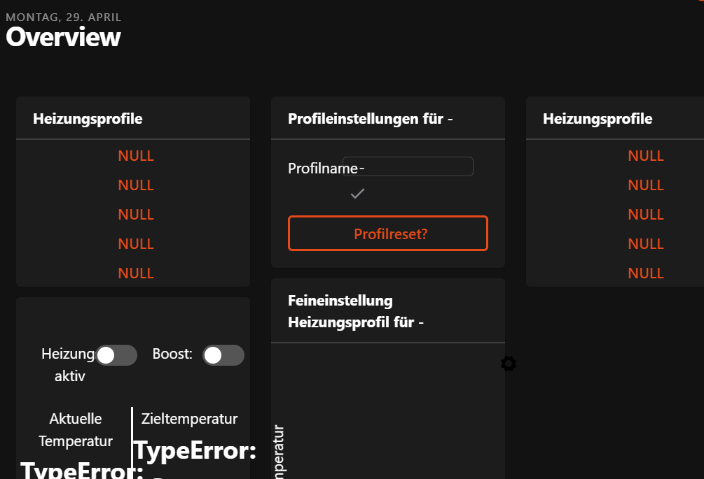

First of all I would like to thank you very much for your widgets and rules. I was able to set up the profile part withouth issues.
However I am struggling with the widgets here. The Profile Selection widget shows the right amount of buttons (I have 7 profiles with type Temperature and it shows 7 lines so the oh:repeater does read through the group right). However the buttons are empty and I cant alos click on them. Any idea why?
If the right amount of buttons are there, but no names, then it sounds to me like the “_Name” items are empty. For example, if you have these Virtual Items:
//BEGIN PROFILE BLOCK
Group Profile2 (ProfileList)
Group Profile2_val (Profile2)
String Profile2_Name        (Profile2)
String Profile2_Command     (Profile2, ProfileCMD)
String Profile2_Type        (Profile2, ProfileType)
Switch Profile2_Interpolate (Profile2)
Number Profile2_Calculated  (Profile2)
Number Profile2_MaxValue    (Profile2)
Number Profile2_MinValue    (Profile2)
Number Profile2_0 "00" (Profile2_val, ProfileSlider)
Number Profile2_1 "01" (Profile2_val, ProfileSlider)
//continued..
They will show up in the list if Profile2_Type is “Temperature” and then it will populate the list with the matching values of the Profile2_Name items.
So, check if the <profile>_Name items are set to values. If they aren’t–if they are set to Null it will not work. In the other post where the profile rules are laid out, there are multiple rules which show examples of how these names can be set, for example in the rule rule "Profile Calculator - load defaults" there are lines that set the names like so: Profile1_Name.sendCommand("Standard Light Brightness").
Alternatively, you can open the profile_looper widget, and hit the gear to open a popup of profile_looper_popup which should let you set a name if none is set
Unfortunately that is not the issue, the items do have names. I did trigger the load defaults rule. Basically all items with Type “Temperature” have actually a name (Away, Present, Frostguard, Workday, Weekend, Hot Morning, Alternate Heat). Funnily if i change another profile to temperature it is going to add another line - so it identifies the number of Profile Items with “Temperature” right but it somehow doesnt populate the buttons with text
Okay, that’s unusual. What version of OpenHab are you using?
Here are some more things you can try:

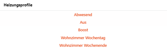

I fixed it. The issue was with the the f7-list-item, i took this component away and directly made it the oh-button and now it works. I don’t exactly know why, maybe something to do with the Openhab version.
Find attached the code (In case someone else runs into the same issue)

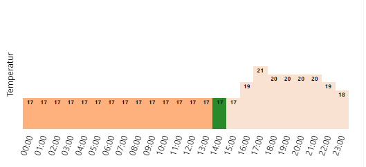

I have installed the profile widget/system and can view and change the profiles etc.
I am on openHAB 4.0.4.
The heat control widget /system generates the following for me.
Does anyone have an idea what the problem could be?
Probably some change to styling in OH4. Does the widget look correct in the Widget Development tool?

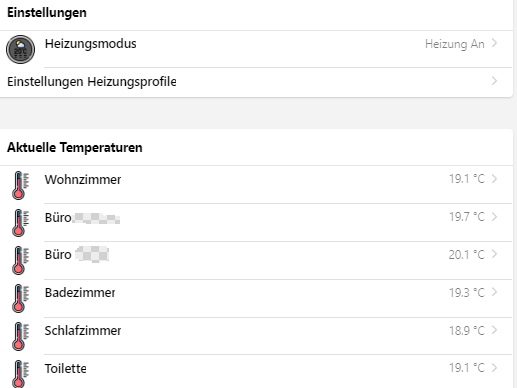

It looks like this for me:
Basic Heating Set-Up:
If you click on “Einstellungen Heizprofile” it will open up the profile list.
You can then click on the profiles to modify them
If you click on any of the rooms it will open up the room specific settings:

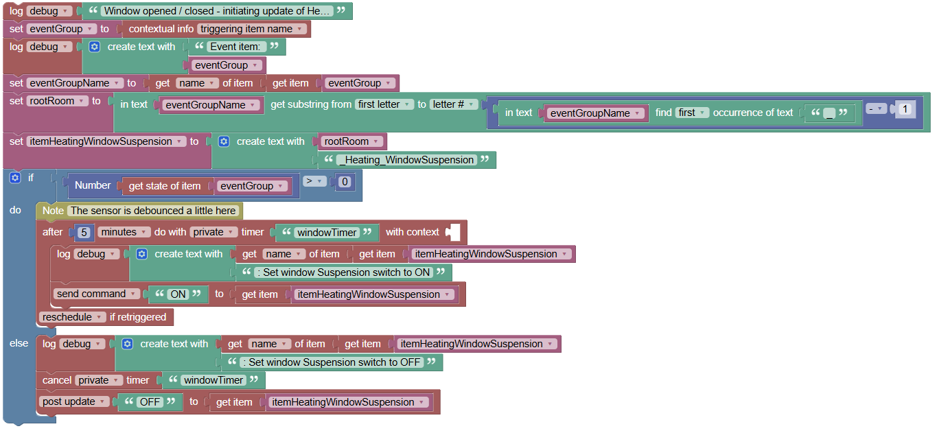

Rule: Open Windows
configuration: {}
triggers:
  - id: "1"
    configuration:
      groupName: windowsensor
    type: core.GroupStateChangeTrigger
conditions: []
actions:
  - inputs: {}
    configuration:
      type: application/javascript
      script: >
        var triggered_window_group, root_room, Heating_WindowSuspension;
        console.info('-----------------------------------');
        console.info('Window opened / closed - initiating update of Heating_WindowSuspension ');
        triggered_window_group = event.itemName;
        root_room = triggered_window_group.slice(0, (triggered_window_group.indexOf('_') + 1) - 1);
        Heating_WindowSuspension = String(root_room) + '_Heating_WindowSuspension';
        if (items.getItem(triggered_window_group).state != '0') {
          items.getItem(Heating_WindowSuspension).sendCommand('ON');
          console.info((['Window(s) open in room: ',root_room,'Set window Suspension switch to ON'].join('')));
        } else {
          items.getItem(Heating_WindowSuspension).sendCommand('OFF');
          console.info((['Window(s) closed in room: ',root_room,'Set Window Suspension Switch to OFF'].join('')));
    type: script.ScriptAction

Widget: Heating Settings Room
uid: Heizungseinstellungen_Raum_Popup
tags: []
props:
  parameters:
    - context: item
      required: false
      type: TEXT
  parameterGroups: []
timestamp: Sep 20, 2023, 1:22:02 PM
component: f7-card
  style:
    text-align: center
  content:
    - component: f7-block
        style:
          margin-left: -2em
          margin-right: -2em
        default:
          - component: f7-row
              style:
                margin-bottom: 20px
                margin-top: -25px
              default:
                - component: f7-col
                    width: 95
                    default:
                      - component: oh-icon
                          align: right
                          icon: oh:away.svg
                          visible: =(items[props.root_item.split('_')[0] + '_Heating_AwaySwitch'].state == 'ON')? true:false
                          width: 32px
                - component: f7-col
                    width: 5
                    default:
                          align: right
                          icon: oh:window-false.svg
                          visible: =(items[props.root_item.split('_')[0] + '_Heating_WindowSuspension'].state == 'ON')? true:false
                          width: 32px
          - component: f7-row
              style:
                margin-bottom: 20px
                margin-top: 10px
                text-align: center
                width: 100%
              default:
                - component: f7-col
                    style:
                      margin-left: 20px
                      text-align: right
                    default:
                      - component: Label
                          text: Heizungszone aktiv
                - component: f7-col
                    style:
                      text-align: left
                    default:
                      - component: oh-toggle
                - component: f7-col
                    style:
                      text-align: right
                    default:
                      - component: Label
                          text: "Boost:"
                - component: f7-col
                    style:
                      text-align: left
                    default:
                          item: =props.root_item.split('_')[0] + '_Heating_BoostMode'
          - component: f7-row
              style:
                margin-top: 10px
              default:
                - component: f7-col
                    style:
                      border-right: 2px solid white
                      text-align: center
                      width: 50%
                    default:
                      - component: f7-row
                          default:
                            - component: Label
                                style:
                                  width: 100%
                                text: Aktuelle Temperatur
                      - component: f7-row
                          style:
                            text-align: center
                          default:
                            - component: Label
                                style:
                                  font-size: 18pt
                                  font-weight: bold
                                  width: 100%
                                text: =items[props.root_item.split('_')[0] + '_Temperature'].state + ' °C'
                - component: f7-col
                    style:
                      width: 50%
                    default:
                      - component: f7-row
                          default:
                            - component: Label
                                style:
                                  width: 100%
                                text: Zieltemperatur
                      - component: f7-row
                          default:
                            - component: Label
                                style:
                                  font-size: 18pt
                                  font-weight: bold
                                  width: 100%
                                text: =items[props.root_item.split('_')[0] + '_Heating_Target'].state + ' °C'
          - component: f7-row
              style:
                margin-top: 20px
                text-align: center
                width: 100%
              default:
                - component: Label
                    style:
                      margin-bottom: -15px
                      width: 100%
                    text: ◄◄ Override ►►
                - component: f7-col
                    style:
                      margin: 10px
                      padding: 10px
                    default:
                      - component: oh-slider
                          item: =props.root_item.split('_')[0] + '_Heating_Offset'
                          label: true
                          max: 3
                          min: -3
                          releaseOnly: true
                          scale: true
                          scaleSteps: 6
                          step: 0.5
                          style:
                            --f7-range-bar-active-bg-color: "#919191"
                            --f7-range-bar-bg-color: "#919191"
                          unit: °C
          - component: f7-row
              style:
                margin-top: 10px
                text-align: center
                width: 100%
              default:
                - component: f7-segmented
                    round: true
                    style:
                      padding: 10px
                      width: 100%
                    default:
                          action: command
                          actionCommand: Auto
                          actionItem: =props.root_item.split('_')[0] + '_Heating_AutomationMode'
                          active: "=(items[props.root_item.split('_')[0] + '_Heating_AutomationMode'].state == 'Auto') ? true : false"
                          outline: true
                          round: true
                          text: Automatisch
                          action: command
                          actionCommand: Static
                          active: "=(items[props.root_item.split('_')[0] + '_Heating_AutomationMode'].state == 'Static') ? true : false"
                          outline: true
                          round: true
                          text: Statisch
          - component: f7-row
              style:
                margin-top: 20px
                text-align: center
                width: 100%
              default:
                - component: f7-col
                    default:
                      - component: Label
                          style:
                            text-align: right
                          text: Aktives Profil
                - component: f7-col
                    default:
                      - component: f7-row
                          default:
                            - component: Label
                                style:
                                  background-color: "=( items[props.root_item.split('_')[0] + '_Heating_AutomationProfileActive'].state == 'Abwesend' ? '#919191' : ( items[props.root_item.split('_')[0] + '_Heating_AutomationProfileActive'].state == 'Aus' ? '#00ACB5' : ( items[props.root_item.split('_')[0] + '_Heating_AutomationProfileActive'].state == 'Boost' ? '#008c09' : '#902022')))"
                                  border-radius: 10px
                                  font-weight: bold
          - component: f7-row
              style:
                margin-bottom: 10px
                margin-top: 10px
              default:
                - component: f7-col
                    style:
                      text-align: center
                      width: 50%
                    default:
                      - component: f7-row
                          default:
                            - component: Label
                                style:
                                  width: 100%
                                text: Montag - Freitag
                      - component: f7-row
                          style:
                            margin-top: 10px
                            text-align: center
                          default:
                                action: popup
                                actionModal: widget:Auswahl_Heizungsprofile
                                actionModalConfig:
                                fill: true
                                round: true
                                style:
                                  font-weight: bold
                - component: f7-col
                    style:
                      width: 50%
                    default:
                      - component: f7-row
                          default:
                            - component: Label
                                style:
                                  width: 100%
                                text: Samstag - Sonntag
                      - component: f7-row
                          style:
                            margin-top: 10px
                            text-align: center
                          default:
                                action: popup
                                actionModalConfig:
                                fill: true
                                round: true
                                style:
                                  background-color: "=( items[props.root_item.split('_')[0] + '_Heating_AutomationProfileAlternate'].state == 'Abwesend' ? '#919191' : ( items[props.root_item.split('_')[0] + '_Heating_AutomationProfileAlternate'].state == 'Aus' ? '#00ACB5' : '#902022'))"
                                  font-weight: bold
          - component: f7-row
              style:
                margin-bottom: 10px
                margin-top: 10px
              default:
                - component: f7-col
                    default:
                      - component: widget:Profilgraph
                          profilecore: =items[props.root_item.split('_')[0] + '_Heating_AutomationProfileActiveID'].state

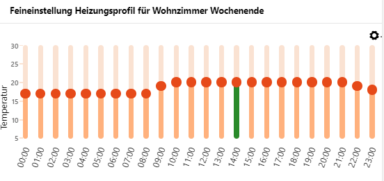

Widget: Modify Temperature per Room
uid: Heizungsprofil_Einstellungen
tags: []
props:
  parameters:
    - context: item
      label: Profil-Gruppe
      required: true
      type: TEXT
  parameterGroups: []
timestamp: Sep 19, 2023, 8:37:38 PM
component: f7-card
  style:
    --f7-range-bar-active-bg-color: "#ffb17d"
    --f7-range-bar-bg-color: "#fae2d2"
    --f7-range-bar-border-radius: 1em
    --f7-range-bar-size: 0.6em
    position: relative
  title: ="Feineinstellung Heizungsprofil für " + items[props.profile + "_Name"].state
  width: 100%
  default:
    - component: f7-row
        default:
          - component: f7-col
            config: {}
              default:
                - component: Label
                    style:
                      font-size: 12pt
                      padding: 10px
          - component: f7-col
              style:
                width: 5%
              default:
                    action: popup
                    actionModal: widget:Heizeinstellungen_Profil_Popup
                    actionModalConfig:
                      profile: =props.profile
                    color: black
                    iconF7: gear_alt_fill
                    large: true
        style:
          display: flex
          flex-direction: row
          height: 230px
          left: 2.5%
          top: 0%
          width: 100%
        default:
              for: item
              fragment: true
              groupItem: =props.profile + '_val'
              default:
                - component: f7-col
                    style:
                      height: 210px
                      width: 100%
                    default:
                      - component: f7-row
                          default:
                                item: =loop.item.name
                                label: true
                                max: 30
                                min: 5
                                releaseOnly: true
                                scale: "=(loop.item.label == '00') ? true : false"
                                scaleSteps: 5
                                step: 0.5
                                style:
                                  --f7-range-bar-active-bg-color: "=(dayjs().format('HH') == loop.item.label) ? '#298a29' : '' "
                                  height: 150px
                                title: =loop.item.label
                                vertical: 1
                      - component: f7-row
                          default:
                            - component: Label
                                style:
                                  position: relative
                                  top: 35px
                                  transform: rotate(-70deg)
                                  width: 1px
                                text: =loop.item.label + ":00"
                                visible: true
    - component: Label
        style:
          height: 10px
          left: 0px
          position: absolute
          top: 205px
          transform: rotate(-90deg)
          width: 1px
        text: Temperatur
@wAvE @Marmoset_Threat
Thanks for sharing and creating!
Thanks again to @Marmoset_Threat and @wAvE for the great work.
I am under openHAB 4.0.4
Here are a few more comments from me on the post by @wAvE.
It is important to note that the items for the heater thermostat must be adjusted in the rule. I have put my rule Heating Control (Rule: Regular Heating Check and Rule: Heating Input Trigger combined) below again. In the rule states in the comments which items of the thermostat and must be adjusted. I have also removed the Kindersicherung as I don’t have it and I still have to look at the calibration, but I don’t think it works with my heater thermostat.
Enclosed is also the page (Page Heating Control) in my openHAB as an example, because at the beginning it was not clear to me where and how to call the widgets. Here you have to adapt the settings to your items. My shortened items file is also attached.

Rule Heating Control Open Windows
configuration: {}
triggers:
  - id: "2"
    configuration:
conditions: []
actions:
  - inputs: {}
    label: Blockly
    description: Blockly
    configuration:

Thanks @HolBaum5 . I managed to install but ending up similarily with the name errors. See below:
I just cant find in the settings what is wrong. Any ideas.
