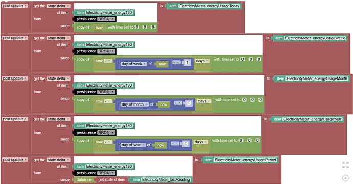

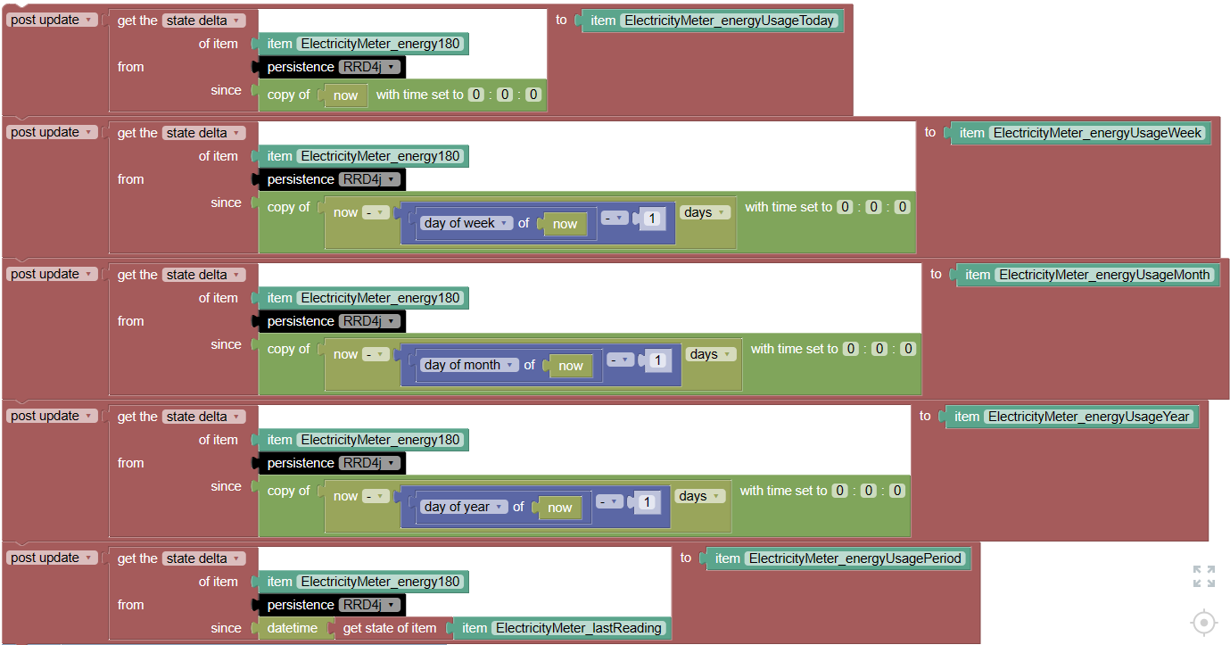

This also needs two rules to update Items and/or calculate their state from peristed values.
All Items and the persistence service used have to be adopted to your own needs..
Rules Code
    configuration:
      blockSource: <xml xmlns="https://developers.google.com/blockly/xml"><block type="oh_event" id="wR2@!=5jfQG3|Tnh{+~x" x="-14" y="-145"><field name="eventType">postUpdate</field><value name="value"><shadow type="text" id="jWgD4t7.O;)]3OP#c3_R"><field name="TEXT">value</field></shadow><block type="oh_get_persistvalue" id="o{T16a(Kz8%H}OiFX!92"><field name="methodName">deltaSince</field><value name="itemName"><shadow type="oh_item" id=";^(0GHJN+qNYn[-TH#fs"><mutation itemName="MyItem" itemLabel="MyItem"></mutation><field name="itemName">MyItem</field></shadow><block type="oh_item" id="Tzh_y}fz^X{LSYcL)1:A"><mutation itemName="ElectricityMeter_energy180" itemLabel="Energie Gesamt"></mutation><field name="itemName">ElectricityMeter_energy180</field></block></value><value name="persistenceName"><shadow type="oh_persistence_dropdown" id="4Ip6?cO^P}fVH,;U(Ig1"><field name="persistence">default</field></shadow><block type="oh_persistence_dropdown" id="6jc}NQ;mmWl:(zG!(jGl"><field name="persistence">rrd4j</field></block></value><value name="dayInfo"><block type="deibich:blockly:dateTime_zdt_set_time_with_fields" id="BXkQhKmnZ}Ye]N,[/KuW"><field name="HOURS">0</field><field name="MINUTES">0</field><field name="SECONDS">0</field><value name="DATE"><shadow type="oh_zdt" id="-YwB#{75n6x@v:LZ_wRf"><field name="day">2023-08-20</field></shadow><block type="oh_zdt_now" id="?M%+fG)$eQATRt1NyDX{"></block></value></block></value></block></value><value name="itemName"><shadow type="oh_item" id="Pt$^PEJnHsZ}1wO!(iS%"><mutation itemName="MyItem" itemLabel="MyItem"></mutation><field name="itemName">MyItem</field></shadow><block type="oh_item" id="+h(C{ZBBbQbWF0}5O-T("><mutation itemName="ElectricityMeter_energyUsageToday" itemLabel="Energieverbrauch Heute"></mutation><field name="itemName">ElectricityMeter_energyUsageToday</field></block></value><next><block type="oh_event" id="i.q{)XrqTs1%hj:3tW1h"><field name="eventType">postUpdate</field><value name="value"><shadow type="text" id="jWgD4t7.O;)]3OP#c3_R"><field name="TEXT">value</field></shadow><block type="oh_get_persistvalue" id="~Fs,0-d,f:r)/)Po0fzF"><field name="methodName">deltaSince</field><value name="itemName"><shadow type="oh_item" id="eV4}S-t^%::[S(zE:Xlf"><mutation itemName="MyItem" itemLabel="MyItem"></mutation><field name="itemName">MyItem</field></shadow><block type="oh_item" id="SOrpMoT6[8q]knugKx_q"><mutation itemName="ElectricityMeter_energy180" itemLabel="Energie Gesamt"></mutation><field name="itemName">ElectricityMeter_energy180</field></block></value><value name="persistenceName"><shadow type="oh_persistence_dropdown" id="4Ip6?cO^P}fVH,;U(Ig1"><field name="persistence">default</field></shadow><block type="oh_persistence_dropdown" id="FDP+td7ya7ZJiW/APx7q"><field name="persistence">rrd4j</field></block></value><value name="dayInfo"><block type="deibich:blockly:dateTime_zdt_set_time_with_fields" id="H1?zJ%xWP(djG9331v=o"><field name="HOURS">0</field><field name="MINUTES">0</field><field name="SECONDS">0</field><value name="DATE"><shadow type="oh_zdt" id="-YwB#{75n6x@v:LZ_wRf"><field name="day">2023-08-20</field></shadow><block type="oh_zdt_plusminus" id="3CAJ%?j`%-`S(cs646d^"><field name="plusminus">minus</field><field name="period">Days</field><value name="offset"><shadow type="math_number" id="-yJ-wrzk}kF?MBl$=Q.v"><field name="NUM">0</field></shadow><block type="math_arithmetic" id="-hadISd2nVwTrE0S+dqb"><field name="OP">MINUS</field><value name="A"><shadow type="math_number" id="}uT^gKPy.r__jTDW@tye"><field name="NUM">1</field></shadow><block type="oh_get_zdt_part" id="6D`|~dy77.lp8moxom7@"><field name="temporalPart">getDayOfWeek</field><value name="zdt"><block type="oh_zdt_now" id="?/[,lh[c8pq@]{#vNLIq"></block></value></block></value><value name="B"><shadow type="math_number" id="8-H0GA(SID)LfG)nFQ)x"><field name="NUM">1</field></shadow></value></block></value></block></value></block></value></block></value><value name="itemName"><shadow type="oh_item" id="Pt$^PEJnHsZ}1wO!(iS%"><mutation itemName="MyItem" itemLabel="MyItem"></mutation><field name="itemName">MyItem</field></shadow><block type="oh_item" id="U^2/Ta?7FbQCrVTT$/6:"><mutation itemName="ElectricityMeter_energyUsageWeek" itemLabel="Energieverbrauch Woche"></mutation><field name="itemName">ElectricityMeter_energyUsageWeek</field></block></value><next><block type="oh_event" id="ekS[%nx~(};zhL!aj3cq"><field name="eventType">postUpdate</field><value name="value"><shadow type="text" id="jWgD4t7.O;)]3OP#c3_R"><field name="TEXT">value</field></shadow><block type="oh_get_persistvalue" id="iLkwL4E;@rmKIiZ6qll*"><field name="methodName">deltaSince</field><value name="itemName"><shadow type="oh_item" id="eV4}S-t^%::[S(zE:Xlf"><mutation itemName="MyItem" itemLabel="MyItem"></mutation><field name="itemName">MyItem</field></shadow><block type="oh_item" id="X2hEF34^7YJOSj0$`K@r"><mutation itemName="ElectricityMeter_energy180" itemLabel="Energie Gesamt"></mutation><field name="itemName">ElectricityMeter_energy180</field></block></value><value name="persistenceName"><shadow type="oh_persistence_dropdown" id="4Ip6?cO^P}fVH,;U(Ig1"><field name="persistence">default</field></shadow><block type="oh_persistence_dropdown" id="MP#fhHAZvlfF6G`(xA,U"><field name="persistence">rrd4j</field></block></value><value name="dayInfo"><block type="deibich:blockly:dateTime_zdt_set_time_with_fields" id="Eu`Ge?Xs@@UdL=#r~vIp"><field name="HOURS">0</field><field name="MINUTES">0</field><field name="SECONDS">0</field><value name="DATE"><shadow type="oh_zdt" id="-YwB#{75n6x@v:LZ_wRf"><field name="day">2023-08-20</field></shadow><block type="oh_zdt_plusminus" id=".wyGf7(:ck4^fV]mPZ~I"><field name="plusminus">minus</field><field name="period">Days</field><value name="offset"><shadow type="math_number" id="-yJ-wrzk}kF?MBl$=Q.v"><field name="NUM">0</field></shadow><block type="math_arithmetic" id="#Bag6+_vL=*lvOBmxxHm"><field name="OP">MINUS</field><value name="A"><shadow type="math_number" id="}uT^gKPy.r__jTDW@tye"><field name="NUM">1</field></shadow><block type="oh_get_zdt_part" id="MJ=s3o9zRWUwl3L478-%"><field name="temporalPart">getDayOfMonth</field><value name="zdt"><block type="oh_zdt_now" id="]gJ{KIp%t+llJE:Neh_z"></block></value></block></value><value name="B"><shadow type="math_number" id="9uwi/uaZ5-rxJEwn(Zg="><field name="NUM">1</field></shadow></value></block></value></block></value></block></value></block></value><value name="itemName"><shadow type="oh_item" id="Pt$^PEJnHsZ}1wO!(iS%"><mutation itemName="MyItem" itemLabel="MyItem"></mutation><field name="itemName">MyItem</field></shadow><block type="oh_item" id="Q7zR(dyrQ!pqzAIc8v?j"><mutation itemName="ElectricityMeter_energyUsageMonth" itemLabel="Energieverbrauch Monat"></mutation><field name="itemName">ElectricityMeter_energyUsageMonth</field></block></value><next><block type="oh_event" id=";{L95656B0OHC6ZIf9Qn"><field name="eventType">postUpdate</field><value name="value"><shadow type="text" id="jWgD4t7.O;)]3OP#c3_R"><field name="TEXT">value</field></shadow><block type="oh_get_persistvalue" id="KW|1F}!ZJpL#aZem8%[s"><field name="methodName">deltaSince</field><value name="itemName"><shadow type="oh_item" id="eV4}S-t^%::[S(zE:Xlf"><mutation itemName="MyItem" itemLabel="MyItem"></mutation><field name="itemName">MyItem</field></shadow><block type="oh_item" id="d[6-:!?sti()whBdPIm6"><mutation itemName="ElectricityMeter_energy180" itemLabel="Energie Gesamt"></mutation><field name="itemName">ElectricityMeter_energy180</field></block></value><value name="persistenceName"><shadow type="oh_persistence_dropdown" id="4Ip6?cO^P}fVH,;U(Ig1"><field name="persistence">default</field></shadow><block type="oh_persistence_dropdown" id="ZD^J(z8(zg7JMpLh4Lx2"><field name="persistence">rrd4j</field></block></value><value name="dayInfo"><block type="deibich:blockly:dateTime_zdt_set_time_with_fields" id="E4[}=fSeiaFbher(C?/e"><field name="HOURS">0</field><field name="MINUTES">0</field><field name="SECONDS">0</field><value name="DATE"><shadow type="oh_zdt" id="-YwB#{75n6x@v:LZ_wRf"><field name="day">2023-08-20</field></shadow><block type="oh_zdt_plusminus" id="#WP9ziro@OOi[)3xvs,|"><field name="plusminus">minus</field><field name="period">Days</field><value name="offset"><shadow type="math_number" id="-yJ-wrzk}kF?MBl$=Q.v"><field name="NUM">0</field></shadow><block type="math_arithmetic" id="8i5+AXmgX#^-F89,Lu]X"><field name="OP">MINUS</field><value name="A"><shadow type="math_number" id="}uT^gKPy.r__jTDW@tye"><field name="NUM">1</field></shadow><block type="oh_get_zdt_part" id=".7VS+[H|NoEI$`bO;E=y"><field name="temporalPart">getDayOfYear</field><value name="zdt"><block type="oh_zdt_now" id="dJW)ytlA,R%lc9(0T+jy"></block></value></block></value><value name="B"><shadow type="math_number" id="Bi)-*(@7#0:8^dFK%PRR"><field name="NUM">1</field></shadow></value></block></value></block></value></block></value></block></value><value name="itemName"><shadow type="oh_item" id="Pt$^PEJnHsZ}1wO!(iS%"><mutation itemName="MyItem" itemLabel="MyItem"></mutation><field name="itemName">MyItem</field></shadow><block type="oh_item" id="n0#(pT9Uj$D.G9qpYSf@"><mutation itemName="ElectricityMeter_energyUsageYear" itemLabel="Energieverbrauch Jahr"></mutation><field name="itemName">ElectricityMeter_energyUsageYear</field></block></value><next><block type="oh_event" id="c)`^`GpeCp)rQf3{pKLq"><field name="eventType">postUpdate</field><value name="value"><shadow type="text" id="jWgD4t7.O;)]3OP#c3_R"><field name="TEXT">value</field></shadow><block type="oh_get_persistvalue" id="~/A/N.nVj]EIak,;a#LL"><field name="methodName">deltaSince</field><value name="itemName"><shadow type="oh_item" id="eV4}S-t^%::[S(zE:Xlf"><mutation itemName="MyItem" itemLabel="MyItem"></mutation><field name="itemName">MyItem</field></shadow><block type="oh_item" id="MeG%yL]#$Poq~}yMXxi;"><mutation itemName="ElectricityMeter_energy180" itemLabel="Energie Gesamt"></mutation><field name="itemName">ElectricityMeter_energy180</field></block></value><value name="persistenceName"><shadow type="oh_persistence_dropdown" id="4Ip6?cO^P}fVH,;U(Ig1"><field name="persistence">default</field></shadow><block type="oh_persistence_dropdown" id="2hPNgWokiMplnWPc@fDy"><field name="persistence">rrd4j</field></block></value><value name="dayInfo"><block type="oh_zdt_fromText" id="Yi{o9`Uv!L[sTXWKzH%s"><value name="day"><shadow type="text" id="%HAh{g{;*ad]1^jZVpn("><field name="TEXT">2023-08-19</field></shadow><block type="oh_getitem_state" id="#SNHcwEDkwgxVvQEncs+"><value name="itemName"><shadow type="oh_item" id="`)F90,]i,zF0!^MTlPjh"><mutation itemName="MyItem" itemLabel="MyItem"></mutation><field name="itemName">MyItem</field></shadow><block type="oh_item" id="Qa|FV[|k3D.`.c}b7|CX"><mutation itemName="ElectricityMeter_lastReading" itemLabel="Energieverbrauch Ablesedatum"></mutation><field name="itemName">ElectricityMeter_lastReading</field></block></value></block></value></block></value></block></value><value name="itemName"><shadow type="oh_item" id="Pt$^PEJnHsZ}1wO!(iS%"><mutation itemName="MyItem" itemLabel="MyItem"></mutation><field name="itemName">MyItem</field></shadow><block type="oh_item" id="QCMA}5ELYGMsf6F4c4yu"><mutation itemName="ElectricityMeter_energyUsagePeriod" itemLabel="Energieverbrauch Periode"></mutation><field name="itemName">ElectricityMeter_energyUsagePeriod</field></block></value><next><block type="controls_if" id="/j*}b.(ZeI=_tC-otP[S"><value name="IF0"><block type="logic_compare" id="#;6wvoGsWi%+Q)QzCVL|"><field name="OP">EQ</field><value name="A"><block type="oh_zdt_toText" id="L)?pberGBJ,Dsg9V)gl("><field name="withtime">asOHTime</field><value name="date"><shadow type="oh_zdt" id=")eCC#^LvsN;S?Y8D~V+?"><field name="day">2023-09-03</field></shadow><block type="oh_zdt_now" id="._G]KdO|Xj,mb+;2@g#:"></block></value></block></value><value name="B"><block type="text" id="*(ZRhuuD{OCD3HTX=Xua"><field name="TEXT">00:00:00</field></block></value></block></value></block></next></block></next></block></next></block></next></block></next></block></xml>
      type: application/javascript
      script: >
        items.getItem('ElectricityMeter_energyUsageToday').postUpdate((items.getItem('ElectricityMeter_energy180').history.deltaSince(time.ZonedDateTime.now().withHour(0).withMinute(0).withSecond(0), 'rrd4j')));
        items.getItem('ElectricityMeter_energyUsageWeek').postUpdate((items.getItem('ElectricityMeter_energy180').history.deltaSince(time.ZonedDateTime.now().minusDays((((time.ZonedDateTime.now()).dayOfWeek().value()) - 1)).withHour(0).withMinute(0).withSecond(0), 'rrd4j')));
        items.getItem('ElectricityMeter_energyUsageMonth').postUpdate((items.getItem('ElectricityMeter_energy180').history.deltaSince(time.ZonedDateTime.now().minusDays((((time.ZonedDateTime.now()).dayOfMonth()) - 1)).withHour(0).withMinute(0).withSecond(0), 'rrd4j')));
        items.getItem('ElectricityMeter_energyUsageYear').postUpdate((items.getItem('ElectricityMeter_energy180').history.deltaSince(time.ZonedDateTime.now().minusDays((((time.ZonedDateTime.now()).dayOfYear()) - 1)).withHour(0).withMinute(0).withSecond(0), 'rrd4j')));
        items.getItem('ElectricityMeter_energyUsagePeriod').postUpdate((items.getItem('ElectricityMeter_energy180').history.deltaSince(time.toZDT(items.getItem('ElectricityMeter_lastReading').state), 'rrd4j')));
        if (((time.ZonedDateTime.now()).format(time.DateTimeFormatter.ofPattern('yyyy-MM-dd\'T\'HH:mm:ss.SSSZ'))) == '00:00:00') {
    type: script.ScriptAction
You also need an Item holding the date wenn you new billing cycle started (ElectricityMeter_lastReading) !!!

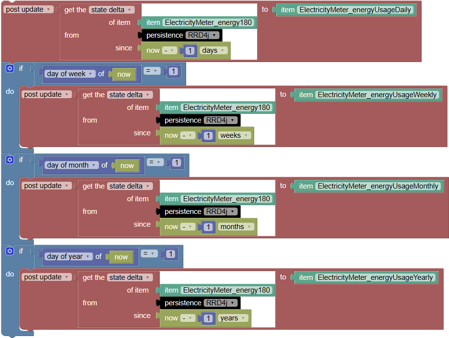

Rules Code
configuration: {}
triggers:
  - id: "1"
    configuration:
      cronExpression: 1 0 0 * * ? *
conditions: []
actions:
  - inputs: {}
    configuration:
        id="a|^dX_MtavSf1=2cxeGW"><field
        type="oh_persistence_dropdown" id="O_c{pjiLi0O6(c+/5ug5"><field
        name="dayInfo"><block type="oh_zdt_plusminus"
        id="y[1(nPz]4`Nk7Kq#pVMS"><field name="plusminus">minus</field><field
        name="period">Weeks</field><value name="offset"><shadow
        type="math_number" id="%ENY;4,LF9~rYdncN*J."><field
        name="NUM">0</field></shadow><block type="math_number"
        id="n};3a{3CvDCE)8$V]V9%"><field
        name="NUM">1</field></block></value></block></value></block></value><value
        id="#fQEeLvX$:+Ok0s-_ndA"><mutation itemName="MyItem"
        id="4TyCQX|zx,QZlhsj[R4d"><mutation
        itemName="ElectricityMeter_energyUsageWeekly"
        itemLabel="Energieverbrauch Wöchentlich"></mutation><field
        name="itemName">ElectricityMeter_energyUsageWeekly</field></block></value></block></statement><next><block
        type="controls_if" id="|NWnM*J!|AH9]Zfa[w-m"><value name="IF0"><block
        type="logic_compare" id="[E}0z@95rr_-(^9a##Iq"><field
        name="OP">EQ</field><value name="A"><block type="oh_get_zdt_part"
        id="(hY?hpqJyp,-~lbvVgB]"><field
        type="oh_zdt_now"
        id="(Dm;y)NZo`dU-VwwNI,q"></block></value></block></value><value
        name="B"><block type="math_number" id="i{%ezg~{d;[v`o^#g[L,"><field
        name="NUM">1</field></block></value></block></value><statement
        name="DO0"><block type="oh_event" id=",%4=aUR`Dp;lZk[vS=iI"><field
        type="text" id="#(yQc8CV:OKPW@[kDmLq"><field
        id="*}wUT?2YIi{%UWLFF)R["><field
        type="oh_item" id="E16,H4)4DqzApG}4|Mrm"><mutation itemName="MyItem"
        id="1u;KZKQ;4ytz0hKJT;/f"><mutation
        type="oh_persistence_dropdown" id="`w~opwkei^7CIB3FrO+."><field
        id="Z?~MSD!-em3!8FSpdz8c"><field name="plusminus">minus</field><field
        name="period">Months</field><value name="offset"><shadow
        type="math_number" id="#+a!N7#(|H6,-X8@ROJU"><field
        id=")^WuCM:FMVt1,K*X5STB"><field
        id="u9c,ktf{y}x6}w%8#jj~"><mutation itemName="MyItem"
        id="Sc9a}rvsYblGZ4/n@Rs]"><mutation
        itemName="ElectricityMeter_energyUsageMonthly"
        itemLabel="Energieverbrauch Monatlich"></mutation><field
        name="itemName">ElectricityMeter_energyUsageMonthly</field></block></value></block></statement><next><block
        type="controls_if" id="Z|(jQNM~N;sjEs_9,OD,"><value name="IF0"><block
        type="logic_compare" id="~BC$sP`2wv49=P@wbIQl"><field
        id="%X4Q/;r!xG,lPkC3i,~E"><field
        type="oh_zdt_now"
        id="1/mF/jsRwX7L}-V/eu8#"></block></value></block></value><value
        name="B"><block type="math_number" id="C8-sV|{33~aWV%c8.]5|"><field
        name="DO0"><block type="oh_event" id="ThuO;#wF9bwNr`GCc#zC"><field
        id="e!g~$Qww)$==?dC|Ph?."><field
        id="#($cP7M_#{wMbxt.#k[b"><mutation
        type="oh_persistence_dropdown" id="3A$FKU5,%6(lF$U]q[Sr"><field
        id="Sy2=fJPU]:hwbCwD+B|Y"><field name="plusminus">minus</field><field
        name="period">Years</field><value name="offset"><shadow
        id="?n62/(a806h70QpkWW+2"><field
        id="?(##OvabvK76gTfk7(Q2"><mutation
        itemName="ElectricityMeter_energyUsageYearly"
        itemLabel="Energieverbrauch Jährlich"></mutation><field
        name="itemName">ElectricityMeter_energyUsageYearly</field></block></value></block></statement></block></next></block></next></block></next></block></xml>
      script: >
        items.getItem('ElectricityMeter_energyUsageDaily').postUpdate((items.getItem('ElectricityMeter_energy180').history.deltaSince(time.ZonedDateTime.now().minusDays(1),
        'rrd4j')));
        if (((time.ZonedDateTime.now()).dayOfWeek().value()) == 1) {
          items.getItem('ElectricityMeter_energyUsageWeekly').postUpdate((items.getItem('ElectricityMeter_energy180').history.deltaSince(time.ZonedDateTime.now().minusWeeks(1), 'rrd4j')));
        if (((time.ZonedDateTime.now()).dayOfMonth()) == 1) {
          items.getItem('ElectricityMeter_energyUsageMonthly').postUpdate((items.getItem('ElectricityMeter_energy180').history.deltaSince(time.ZonedDateTime.now().minusMonths(1), 'rrd4j')));
        if (((time.ZonedDateTime.now()).dayOfYear()) == 1) {
          items.getItem('ElectricityMeter_energyUsageYearly').postUpdate((items.getItem('ElectricityMeter_energy180').history.deltaSince(time.ZonedDateTime.now().minusYears(1), 'rrd4j')));
Many thanks for the codes. I changed ElectricityMeter_energy180 to my own Item in both rules. I have following error messages in the OH4.0.3 log:
2023-11-04 07:28:48.665 [ERROR] [b.automation.script.javascript.stack] - Failed to execute script:
org.graalvm.polyglot.PolyglotException: SyntaxError: <eval>:3:6 Expected ; but found :
  - id: "1"
<eval>:9:10 Expected ; but found :
  - inputs: {}
<eval>:12:19 Expected an operand but found <
      blockSource: <xml xmlns="https://developers.google.com/blockly/xml"><block type="oh_event" id="wR2@!=5jfQG3|Tnh{+~x" x="-14" y="-145"><field name="eventType">postUpdate</field><value name="value"><shadow type="text" id="jWgD4t7.O;)]3OP#c3_R"><field name="TEXT">value</field></shadow><block type="oh_get_persistvalue" id="o{T16a(Kz8%H}OiFX!92"><field name="methodName">deltaSince</field><value name="itemName"><shadow type="oh_item" id=";^(0GHJN+qNYn[-TH#fs"><mutation itemName="MyItem" itemLabel="MyItem"></mutation><field name="itemName">MyItem</field></shadow><block type="oh_item" id="Tzh_y}fz^X{LSYcL)1:A"><mutation itemName="ABB_A43_imp_energy" itemLabel="Energie Gesamt"></mutation><field name="itemName">ABB_A43_imp_energy</field></block></value><value name="persistenceName"><shadow type="oh_persistence_dropdown" id="4Ip6?cO^P}fVH,;U(Ig1"><field name="persistence">default</field></shadow><block type="oh_persistence_dropdown" id="6jc}NQ;mmWl:(zG!(jGl"><field name="persistence">rrd4j</field></block></value><value name="dayInfo"><block type="deibich:blockly:dateTime_zdt_set_time_with_fields" id="BXkQhKmnZ}Ye]N,[/KuW"><field name="HOURS">0</field><field name="MINUTES">0</field><field name="SECONDS">0</field><value name="DATE"><shadow type="oh_zdt" id="-YwB#{75n6x@v:LZ_wRf"><field name="day">2023-08-20</field></shadow><block type="oh_zdt_now" id="?M%+fG)$eQATRt1NyDX{"></block></value></block></value></block></value><value name="itemName"><shadow type="oh_item" id="Pt$^PEJnHsZ}1wO!(iS%"><mutation itemName="MyItem" itemLabel="MyItem"></mutation><field name="itemName">MyItem</field></shadow><block type="oh_item" id="+h(C{ZBBbQbWF0}5O-T("><mutation itemName="ElectricityMeter_energyUsageToday" itemLabel="Energieverbrauch Heute"></mutation><field name="itemName">ElectricityMeter_energyUsageToday</field></block></value><next><block type="oh_event" id="i.q{)XrqTs1%hj:3tW1h"><field name="eventType">postUpdate</field><value name="value"><shadow type="text" id="jWgD4t7.O;)]3OP#c3_R"><field name="TEXT">value</field></shadow><block type="oh_get_persistvalue" id="~Fs,0-d,f:r)/)Po0fzF"><field name="methodName">deltaSince</field><value name="itemName"><shadow type="oh_item" id="eV4}S-t^%::[S(zE:Xlf"><mutation itemName="MyItem" itemLabel="MyItem"></mutation><field name="itemName">MyItem</field></shadow><block type="oh_item" id="SOrpMoT6[8q]knugKx_q"><mutation itemName="ABB_A43_imp_energy" itemLabel="Energie Gesamt"></mutation><field name="itemName">ABB_A43_imp_energy</field></block></value><value name="persistenceName"><shadow type="oh_persistence_dropdown" id="4Ip6?cO^P}fVH,;U(Ig1"><field name="persistence">default</field></shadow><block type="oh_persistence_dropdown" id="FDP+td7ya7ZJiW/APx7q"><field name="persistence">rrd4j</field></block></value><value name="dayInfo"><block type="deibich:blockly:dateTime_zdt_set_time_with_fields" id="H1?zJ%xWP(djG9331v=o"><field name="HOURS">0</field><field name="MINUTES">0</field><field name="SECONDS">0</field><value name="DATE"><shadow type="oh_zdt" id="-YwB#{75n6x@v:LZ_wRf"><field name="day">2023-08-20</field></shadow><block type="oh_zdt_plusminus" id="3CAJ%?j`%-`S(cs646d^"><field name="plusminus">minus</field><field name="period">Days</field><value name="offset"><shadow type="math_number" id="-yJ-wrzk}kF?MBl$=Q.v"><field name="NUM">0</field></shadow><block type="math_arithmetic" id="-hadISd2nVwTrE0S+dqb"><field name="OP">MINUS</field><value name="A"><shadow type="math_number" id="}uT^gKPy.r__jTDW@tye"><field name="NUM">1</field></shadow><block type="oh_get_zdt_part" id="6D`|~dy77.lp8moxom7@"><field name="temporalPart">getDayOfWeek</field><value name="zdt"><block type="oh_zdt_now" id="?/[,lh[c8pq@]{#vNLIq"></block></value></block></value><value name="B"><shadow type="math_number" id="8-H0GA(SID)LfG)nFQ)x"><field name="NUM">1</field></shadow></value></block></value></block></value></block></value></block></value><value name="itemName"><shadow type="oh_item" id="Pt$^PEJnHsZ}1wO!(iS%"><mutation itemName="MyItem" itemLabel="MyItem"></mutation><field name="itemName">MyItem</field></shadow><block type="oh_item" id="U^2/Ta?7FbQCrVTT$/6:"><mutation itemName="ElectricityMeter_energyUsageWeek" itemLabel="Energieverbrauch Woche"></mutation><field name="itemName">ElectricityMeter_energyUsageWeek</field></block></value><next><block type="oh_event" id="ekS[%nx~(};zhL!aj3cq"><field name="eventType">postUpdate</field><value name="value"><shadow type="text" id="jWgD4t7.O;)]3OP#c3_R"><field name="TEXT">value</field></shadow><block type="oh_get_persistvalue" id="iLkwL4E;@rmKIiZ6qll*"><field name="methodName">deltaSince</field><value name="itemName"><shadow type="oh_item" id="eV4}S-t^%::[S(zE:Xlf"><mutation itemName="MyItem" itemLabel="MyItem"></mutation><field name="itemName">MyItem</field></shadow><block type="oh_item" id="X2hEF34^7YJOSj0$`K@r"><mutation itemName="ABB_A43_imp_energy" itemLabel="Energie Gesamt"></mutation><field name="itemName">ABB_A43_imp_energy</field></block></value><value name="persistenceName"><shadow type="oh_persistence_dropdown" id="4Ip6?cO^P}fVH,;U(Ig1"><field name="persistence">default</field></shadow><block type="oh_persistence_dropdown" id="MP#fhHAZvlfF6G`(xA,U"><field name="persistence">rrd4j</field></block></value><value name="dayInfo"><block type="deibich:blockly:dateTime_zdt_set_time_with_fields" id="Eu`Ge?Xs@@UdL=#r~vIp"><field name="HOURS">0</field><field name="MINUTES">0</field><field name="SECONDS">0</field><value name="DATE"><shadow type="oh_zdt" id="-YwB#{75n6x@v:LZ_wRf"><field name="day">2023-08-20</field></shadow><block type="oh_zdt_plusminus" id=".wyGf7(:ck4^fV]mPZ~I"><field name="plusminus">minus</field><field name="period">Days</field><value name="offset"><shadow type="math_number" id="-yJ-wrzk}kF?MBl$=Q.v"><field name="NUM">0</field></shadow><block type="math_arithmetic" id="#Bag6+_vL=*lvOBmxxHm"><field name="OP">MINUS</field><value name="A"><shadow type="math_number" id="}uT^gKPy.r__jTDW@tye"><field name="NUM">1</field></shadow><block type="oh_get_zdt_part" id="MJ=s3o9zRWUwl3L478-%"><field name="temporalPart">getDayOfMonth</field><value name="zdt"><block type="oh_zdt_now" id="]gJ{KIp%t+llJE:Neh_z"></block></value></block></value><value name="B"><shadow type="math_number" id="9uwi/uaZ5-rxJEwn(Zg="><field name="NUM">1</field></shadow></value></block></value></block></value></block></value></block></value><value name="itemName"><shadow type="oh_item" id="Pt$^PEJnHsZ}1wO!(iS%"><mutation itemName="MyItem" itemLabel="MyItem"></mutation><field name="itemName">MyItem</field></shadow><block type="oh_item" id="Q7zR(dyrQ!pqzAIc8v?j"><mutation itemName="ElectricityMeter_energyUsageMonth" itemLabel="Energieverbrauch Monat"></mutation><field name="itemName">ElectricityMeter_energyUsageMonth</field></block></value><next><block type="oh_event" id=";{L95656B0OHC6ZIf9Qn"><field name="eventType">postUpdate</field><value name="value"><shadow type="text" id="jWgD4t7.O;)]3OP#c3_R"><field name="TEXT">value</field></shadow><block type="oh_get_persistvalue" id="KW|1F}!ZJpL#aZem8%[s"><field name="methodName">deltaSince</field><value name="itemName"><shadow type="oh_item" id="eV4}S-t^%::[S(zE:Xlf"><mutation itemName="MyItem" itemLabel="MyItem"></mutation><field name="itemName">MyItem</field></shadow><block type="oh_item" id="d[6-:!?sti()whBdPIm6"><mutation itemName="ABB_A43_imp_energy" itemLabel="Energie Gesamt"></mutation><field name="itemName">ABB_A43_imp_energy</field></block></value><value name="persistenceName"><shadow type="oh_persistence_dropdown" id="4Ip6?cO^P}fVH,;U(Ig1"><field name="persistence">default</field></shadow><block type="oh_persistence_dropdown" id="ZD^J(z8(zg7JMpLh4Lx2"><field name="persistence">rrd4j</field></block></value><value name="dayInfo"><block type="deibich:blockly:dateTime_zdt_set_time_with_fields" id="E4[}=fSeiaFbher(C?/e"><field name="HOURS">0</field><field name="MINUTES">0</field><field name="SECONDS">0</field><value name="DATE"><shadow type="oh_zdt" id="-YwB#{75n6x@v:LZ_wRf"><field name="day">2023-08-20</field></shadow><block type="oh_zdt_plusminus" id="#WP9ziro@OOi[)3xvs,|"><field name="plusminus">minus</field><field name="period">Days</field><value name="offset"><shadow type="math_number" id="-yJ-wrzk}kF?MBl$=Q.v"><field name="NUM">0</field></shadow><block type="math_arithmetic" id="8i5+AXmgX#^-F89,Lu]X"><field name="OP">MINUS</field><value name="A"><shadow type="math_number" id="}uT^gKPy.r__jTDW@tye"><field name="NUM">1</field></shadow><block type="oh_get_zdt_part" id=".7VS+[H|NoEI$`bO;E=y"><field name="temporalPart">getDayOfYear</field><value name="zdt"><block type="oh_zdt_now" id="dJW)ytlA,R%lc9(0T+jy"></block></value></block></value><value name="B"><shadow type="math_number" id="Bi)-*(@7#0:8^dFK%PRR"><field name="NUM">1</field></shadow></value></block></value></block></value></block></value></block></value><value name="itemName"><shadow type="oh_item" id="Pt$^PEJnHsZ}1wO!(iS%"><mutation itemName="MyItem" itemLabel="MyItem"></mutation><field name="itemName">MyItem</field></shadow><block type="oh_item" id="n0#(pT9Uj$D.G9qpYSf@"><mutation itemName="ElectricityMeter_energyUsageYear" itemLabel="Energieverbrauch Jahr"></mutation><field name="itemName">ElectricityMeter_energyUsageYear</field></block></value><next><block type="oh_event" id="c)`^`GpeCp)rQf3{pKLq"><field name="eventType">postUpdate</field><value name="value"><shadow type="text" id="jWgD4t7.O;)]3OP#c3_R"><field name="TEXT">value</field></shadow><block type="oh_get_persistvalue" id="~/A/N.nVj]EIak,;a#LL"><field name="methodName">deltaSince</field><value name="itemName"><shadow type="oh_item" id="eV4}S-t^%::[S(zE:Xlf"><mutation itemName="MyItem" itemLabel="MyItem"></mutation><field name="itemName">MyItem</field></shadow><block type="oh_item" id="MeG%yL]#$Poq~}yMXxi;"><mutation itemName="ABB_A43_imp_energy" itemLabel="Energie Gesamt"></mutation><field name="itemName">ABB_A43_imp_energy</field></block></value><value name="persistenceName"><shadow type="oh_persistence_dropdown" id="4Ip6?cO^P}fVH,;U(Ig1"><field name="persistence">default</field></shadow><block type="oh_persistence_dropdown" id="2hPNgWokiMplnWPc@fDy"><field name="persistence">rrd4j</field></block></value><value name="dayInfo"><block type="oh_zdt_fromText" id="Yi{o9`Uv!L[sTXWKzH%s"><value name="day"><shadow type="text" id="%HAh{g{;*ad]1^jZVpn("><field name="TEXT">2023-08-19</field></shadow><block type="oh_getitem_state" id="#SNHcwEDkwgxVvQEncs+"><value name="itemName"><shadow type="oh_item" id="`)F90,]i,zF0!^MTlPjh"><mutation itemName="MyItem" itemLabel="MyItem"></mutation><field name="itemName">MyItem</field></shadow><block type="oh_item" id="Qa|FV[|k3D.`.c}b7|CX"><mutation itemName="ElectricityMeter_lastReading" itemLabel="Energieverbrauch Ablesedatum"></mutation><field name="itemName">ElectricityMeter_lastReading</field></block></value></block></value></block></value></block></value><value name="itemName"><shadow type="oh_item" id="Pt$^PEJnHsZ}1wO!(iS%"><mutation itemName="MyItem" itemLabel="MyItem"></mutation><field name="itemName">MyItem</field></shadow><block type="oh_item" id="QCMA}5ELYGMsf6F4c4yu"><mutation itemName="ElectricityMeter_energyUsagePeriod" itemLabel="Energieverbrauch Periode"></mutation><field name="itemName">ElectricityMeter_energyUsagePeriod</field></block></value><next><block type="controls_if" id="/j*}b.(ZeI=_tC-otP[S"><value name="IF0"><block type="logic_compare" id="#;6wvoGsWi%+Q)QzCVL|"><field name="OP">EQ</field><value name="A"><block type="oh_zdt_toText" id="L)?pberGBJ,Dsg9V)gl("><field name="withtime">asOHTime</field><value name="date"><shadow type="oh_zdt" id=")eCC#^LvsN;S?Y8D~V+?"><field name="day">2023-09-03</field></shadow><block type="oh_zdt_now" id="._G]KdO|Xj,mb+;2@g#:"></block></value></block></value><value name="B"><block type="text" id="*(ZRhuuD{OCD3HTX=Xua"><field name="TEXT">00:00:00</field></block></value></block></value></block></next></block></next></block></next></block></next></block></next></block></xml>
<eval>:14:14 Expected an operand but found >
      script: >
	at org.graalvm.polyglot.Context.eval(Context.java:399) ~[?:?]
	at com.oracle.truffle.js.scriptengine.GraalJSScriptEngine.eval(GraalJSScriptEngine.java:458) ~[?:?]
	at com.oracle.truffle.js.scriptengine.GraalJSScriptEngine.eval(GraalJSScriptEngine.java:426) ~[?:?]
	at javax.script.AbstractScriptEngine.eval(AbstractScriptEngine.java:262) ~[java.scripting:?]
	at org.openhab.automation.jsscripting.internal.scriptengine.DelegatingScriptEngineWithInvocableAndAutocloseable.eval(DelegatingScriptEngineWithInvocableAndAutocloseable.java:53) ~[?:?]
	at org.openhab.automation.jsscripting.internal.scriptengine.InvocationInterceptingScriptEngineWithInvocableAndAutoCloseable.eval(InvocationInterceptingScriptEngineWithInvocableAndAutoCloseable.java:78) ~[?:?]
	at org.openhab.core.automation.module.script.internal.handler.ScriptActionHandler.lambda$0(ScriptActionHandler.java:71) ~[?:?]
	at java.util.Optional.ifPresent(Optional.java:178) ~[?:?]
	at org.openhab.core.automation.module.script.internal.handler.ScriptActionHandler.execute(ScriptActionHandler.java:68) ~[?:?]
	at org.openhab.core.automation.internal.RuleEngineImpl.executeActions(RuleEngineImpl.java:1188) ~[?:?]
	at org.openhab.core.automation.internal.RuleEngineImpl.runRule(RuleEngineImpl.java:997) ~[?:?]
	at org.openhab.core.automation.internal.TriggerHandlerCallbackImpl$TriggerData.run(TriggerHandlerCallbackImpl.java:87) ~[?:?]
	at java.util.concurrent.Executors$RunnableAdapter.call(Executors.java:539) ~[?:?]
	at java.util.concurrent.FutureTask.run(FutureTask.java:264) ~[?:?]
	at java.util.concurrent.ScheduledThreadPoolExecutor$ScheduledFutureTask.run(ScheduledThreadPoolExecutor.java:304) ~[?:?]
	at java.util.concurrent.ThreadPoolExecutor.runWorker(ThreadPoolExecutor.java:1136) ~[?:?]
	at java.util.concurrent.ThreadPoolExecutor$Worker.run(ThreadPoolExecutor.java:635) ~[?:?]
	at java.lang.Thread.run(Thread.java:833) ~[?:?]
So it seems that I’m missing something. Do I need to change e.g. in line
ElectricityMeter_energyUsageToday to something else?
Did you change the persistence service ?
Forgot to mention that, will update original post.
Thanks for the widget! It’s really great! :grinning:
How do you actually get the energy data. I think you use the Smartmeter binding. Do you read the SML data over the serial port every 3s. Can Openhab handle this amount of data?
I have a Tasmota WiFi reader attached to my smartmeter which post every change over MQTT. Frequency of updates is less than every 3 seconds, so yes, openHAB can handle this amount of information.
Yes, I have correct persistence. I think my problem is due to a wrong syntax. I have Javascript installed and I copied your codes to the Rule editor. When I open the script it shows ECMAScript. Is this correct?
Please see here
Sorry, did not see this on my phone. Of course, All Items need to be changed to the equivalent Items in your installation. You still try to use „my“ items, which your openHAB cannot find.
OK, many thanks. So, there are quite many things which I need to change and I want to get this widget working.
The widget itself can be configured through the UI. You need to change the Rules to your config.
I have configured the widget through the UI and edited the rules but I think there are some syntax problems still:
2023-11-04 13:30:23.852 [ERROR] [internal.handler.ScriptActionHandler] - Script execution of rule with UID 'ABB_A43_status' failed: org.graalvm.polyglot.PolyglotException: SyntaxError: <eval>:3:6 Expected ; but found :
  - id: "1"
  - inputs: null
Hmm, strange. I will try to convert it to a rule template tonight and post an update. You then can install the rule from the addon store and configure it via UI.
Could you please go to the code tab of your rule and post your content, so I can compare it with mine.
BTW, what openHAB version do you use?
This is the Rule I’m using:
configuration: {}
triggers:
  - id: "1"
    configuration:
      itemName: ABB_A43_imp_energy
    type: core.ItemStateUpdateTrigger
conditions: []
actions:
  - inputs: {}
    configuration:
      script: >-
        configuration: {}
        triggers:
          - id: "1"
            configuration:
        conditions: []
        actions:
          - inputs: {}
            configuration:
              script: >
                items.getItem('ABB_A43_energy_consumption_today').postUpdate((items.getItem('ABB_A43_imp_energy').history.deltaSince(time.ZonedDateTime.now().withHour(0).withMinute(0).withSecond(0), 'rrd4j')));
                items.getItem('ABB_A43_energy_consumption_actual_week').postUpdate((items.getItem('ABB_A43_imp_energy').history.deltaSince(time.ZonedDateTime.now().minusDays((((time.ZonedDateTime.now()).dayOfWeek().value()) - 1)).withHour(0).withMinute(0).withSecond(0), 'rrd4j')));
                items.getItem('ABB_A43_energy_consumption_actual_month').postUpdate((items.getItem('ABB_A43_imp_energy').history.deltaSince(time.ZonedDateTime.now().minusDays((((time.ZonedDateTime.now()).dayOfMonth()) - 1)).withHour(0).withMinute(0).withSecond(0), 'rrd4j')));
                items.getItem('ABB_A43_energy_consumption_actual_year').postUpdate((items.getItem('ABB_A43_imp_energy').history.deltaSince(time.ZonedDateTime.now().minusDays((((time.ZonedDateTime.now()).dayOfYear()) - 1)).withHour(0).withMinute(0).withSecond(0), 'rrd4j')));
                items.getItem('ABB_A43_energyUsagePeriod').postUpdate((items.getItem('ABB_A43_imp_energy').history.deltaSince(time.toZDT(items.getItem('ABB_A43_lastReading').state), 'rrd4j')));
I’m running OH4.0.3 and using JavaScript Scripting.
