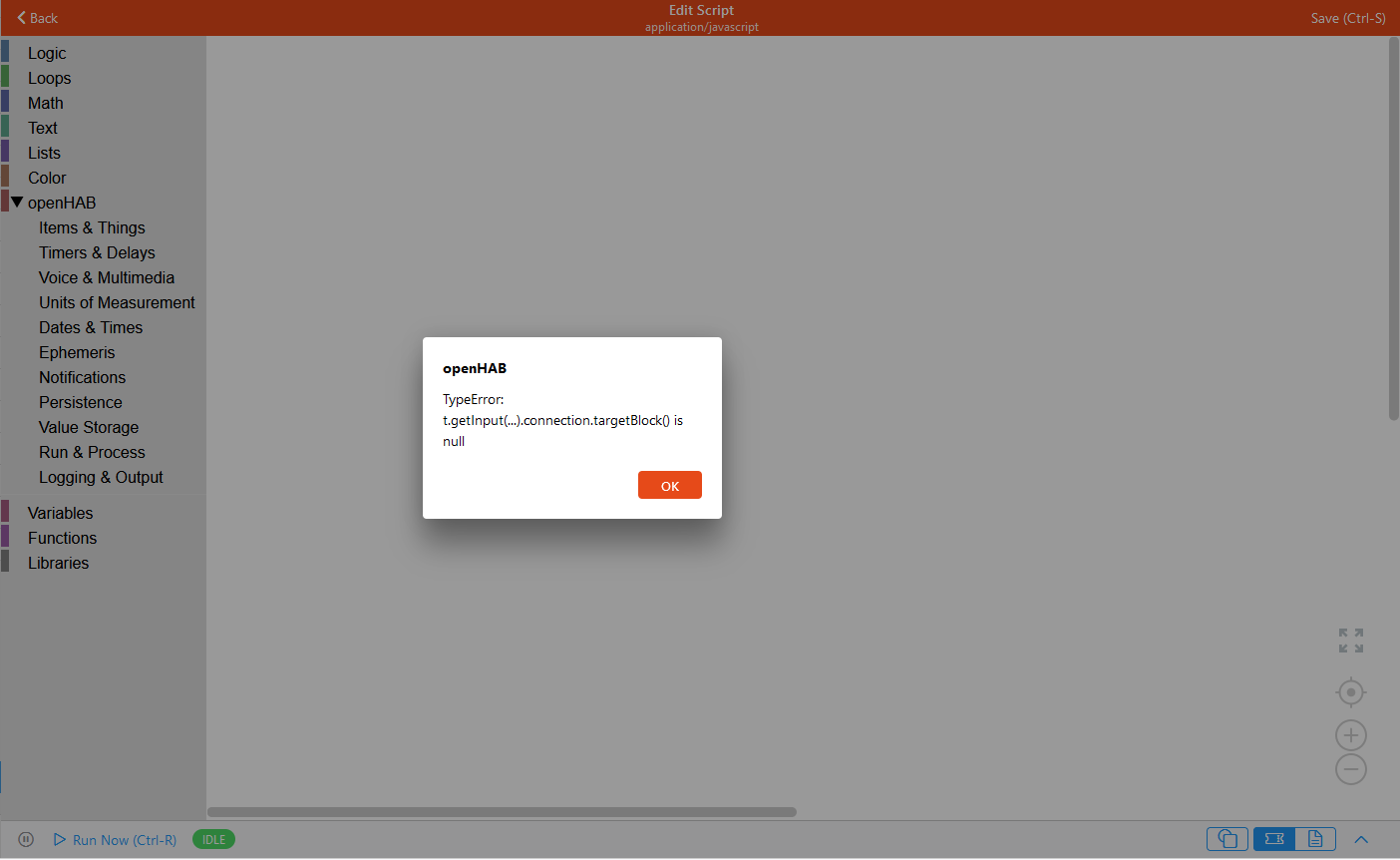

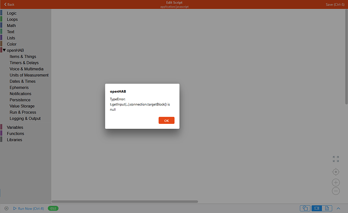

It seems that I still have some problems with the first rule. When looking at the codes for both rules above it looks to me that the first one is possibly missing some code. When I paste the first code in the code page and look at the script in the Edit script page it seems to be empty whereas the 2nd rule shows the Blockly code. Also when I try to save the script of the first rule I get the following error message.
So, I’m wondering what I’m missing. I also tried to paste the code in Add-on marketplace but same result.
Do not copy and paste marketplace rule templates, they need to be installed!!!
Within openHAB goto Addon-Store, select automation at the bottom, scroll to rule templates and press add on the two rules
Then go to your rules and press the plus symbol. You now have the new option to create a new rule from a template. Selecting this will show you the install templates.
After selecting one, you will see the config options where you set the persistence service and your items.
